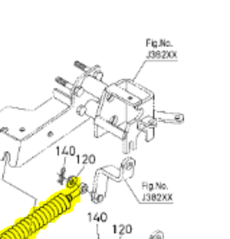

Two things to check:
The controls on that are cable run so anything can happen there.
Carefully see if you can observe the cables moving and pushing/ pulling the control end of the system.
Don't get yourself or anyone else in a position to be pinched / squashed by the three point if it suddenly moves.
The other thing that causes these types of events is an issue with the feedback linkage.
Make sure it's intact tight and connected on both ends.

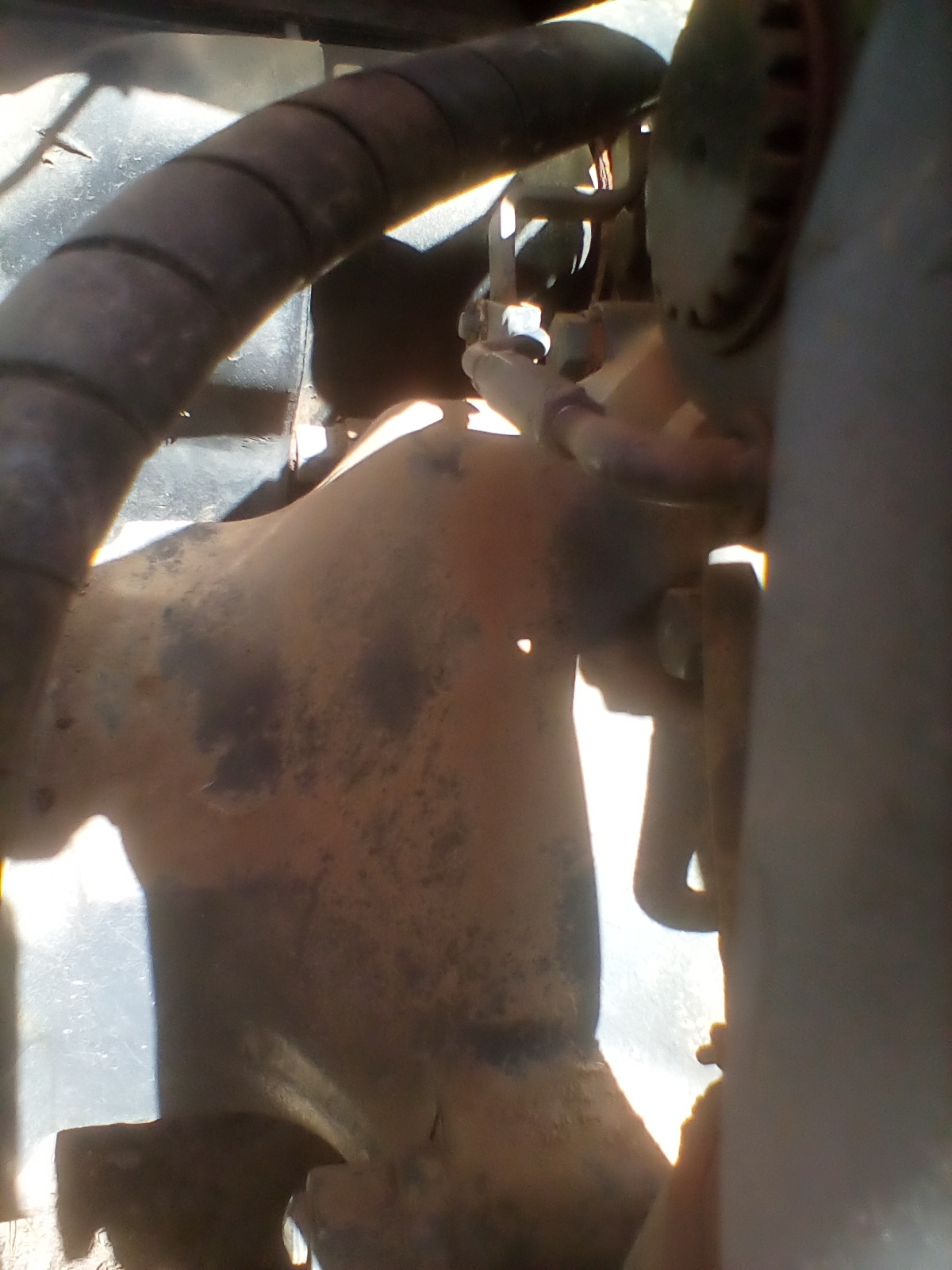

The issue appears to be in the housing the draft control lever attaches to. I can manually cause the hitch to lower by depressing the actuator in the h
LaneRanch
2018 M5 111
Apr 4, 2024
12
Arkansas
I am not sure how to fix it yet. If I depress the actuator in the housing the hitch does go down but.when i use the position control lever to raise it it will not lower again unless i depress the actuator with a screw driver.
