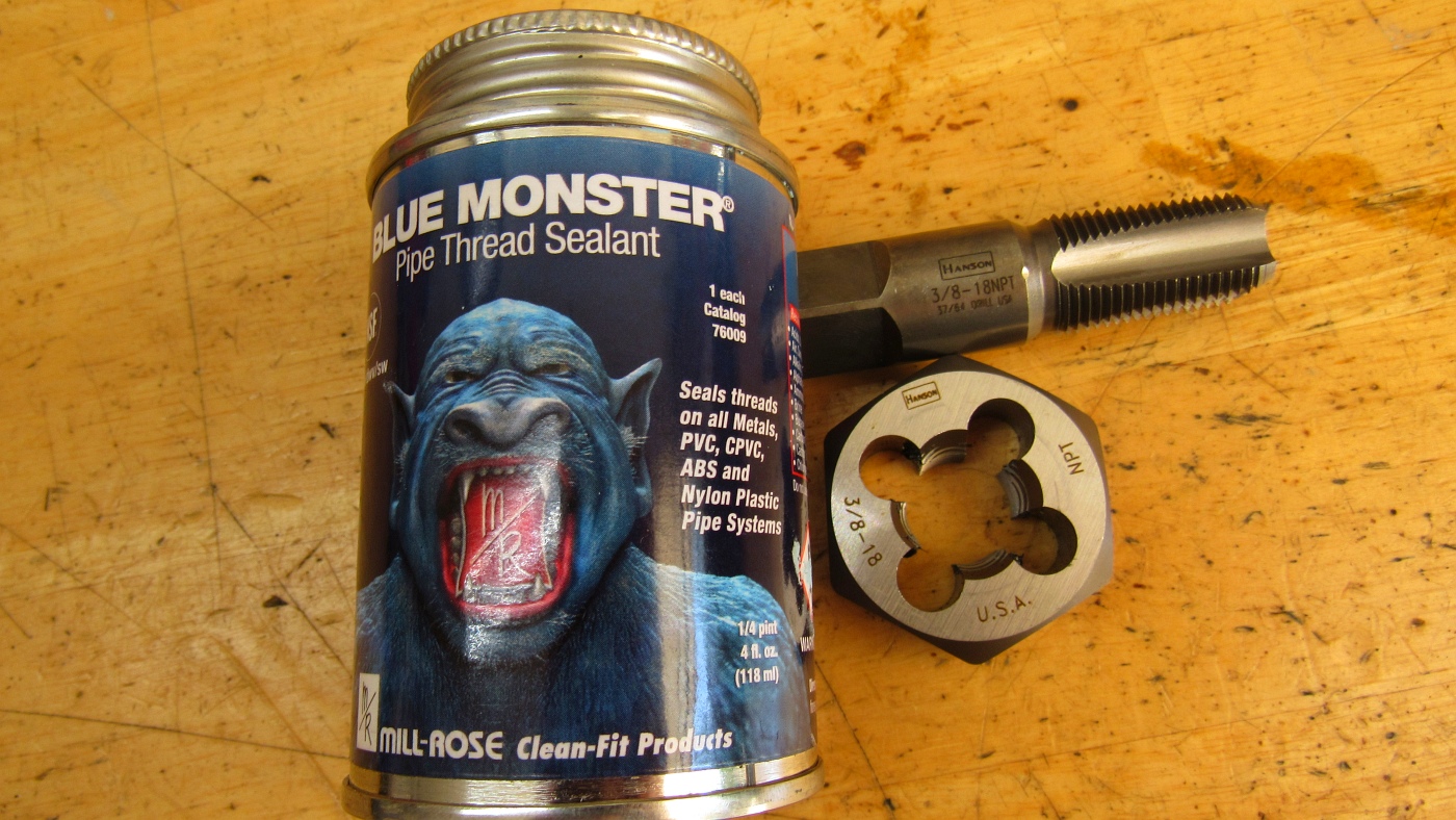

I recently did battle with some china pipe threads and found the Blue Monster thread sealer to be the solution for me. I also had to chase the the threads both male and female. Some the tap and die went in and on smooth and some took a couple turns near the end to straighten.
I used Aviation Permatex on gas and oil fittings for years with no leaks. It was no match for the inferior pipe thread fittings I encountered on my last project.
I also add lamp wick to Chinese pipe threads.

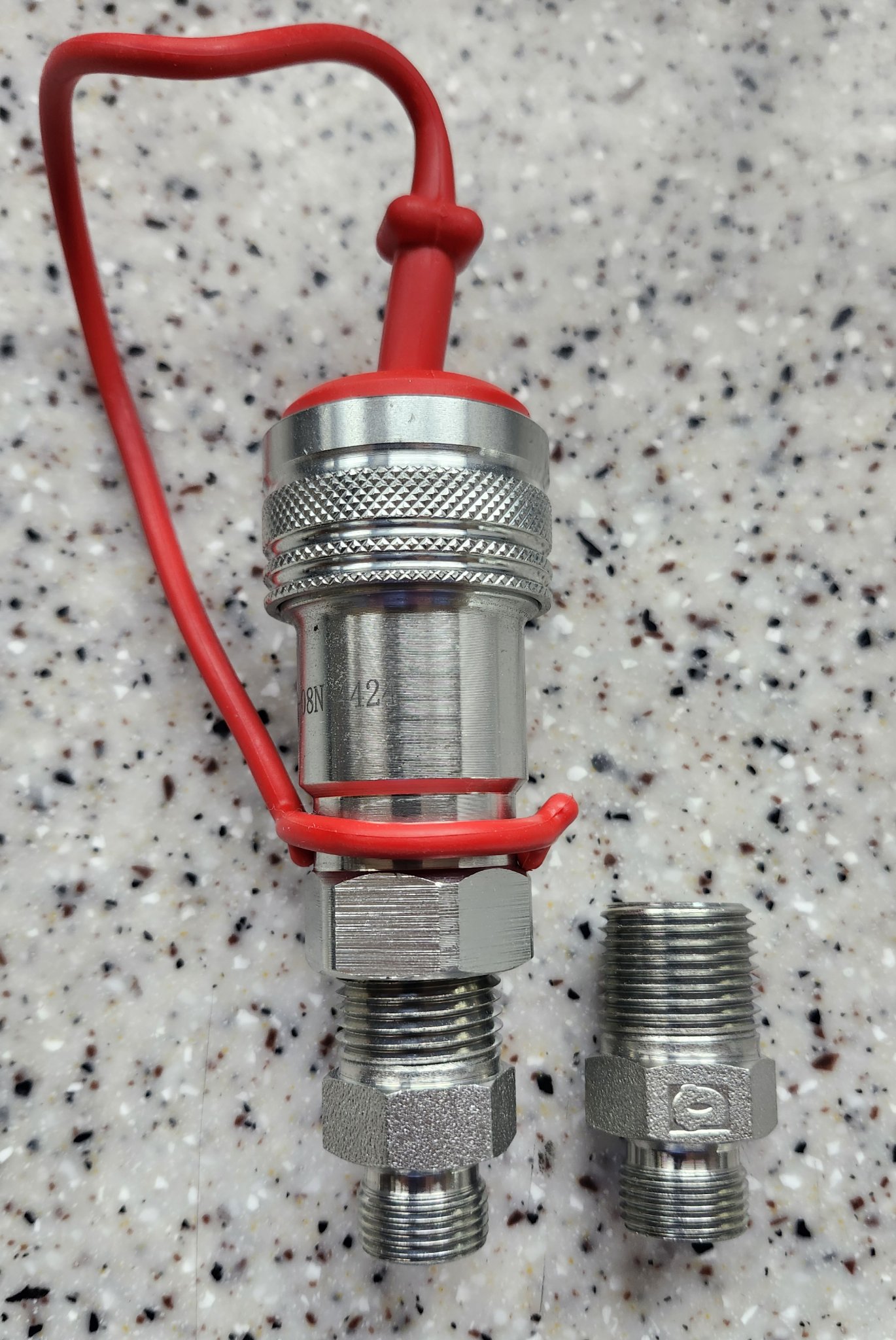

My boom sprayer has some form of paste sealant on all the pipe fittings. It doesn't take much to plug up the nozzles given how fine the tips are, so I'd use some kind of PTFE paste sealant rather than tape. I ordered the stuff shown below (will be here tomorrow) for the BSPP/NPTF to Summit Hydraulic 1/2" Ag couplers.
I'll be interested to hear how it works out. Which parts are BSP and which are NPT? Same tpi, but different thread forms I thought were not reliable for leak tightness, even with doping, in hydraulic pressure situations.

The male 3/8 BSPP end of the adapter threads into the valve bodies at the rear of the tractor. The other male end of the adapter is 1/2" NPTF which threads into the female 1/2" NPT thread at the base of the 1/2" Ag coupler. I'm only using the PTFE paste for the NPT connections. The BSPP uses o-rings.

... I'm only using the PTFE paste for the NPT connections. The BSPP uses o-rings.
Thanks I was curious to know if the BSPP and NPT were being asked to play with each other. They aren't, so I can relax :)

Good grief!! You thought I was going to thread BSPP into NPT!! 😂 How dumb would I have to be to do that? The only reason why I'm using an adapter is that I couldn't find 1/2" Ag couplers that have 3/8 BSPP male threads on them like the piece of junk Faster ones do.
I have rebuild kits for the six Faster couplings and will put them on the "for sale" forum in the hope that someone might actually want to use them, with full disclosure that I have very little regard for them.

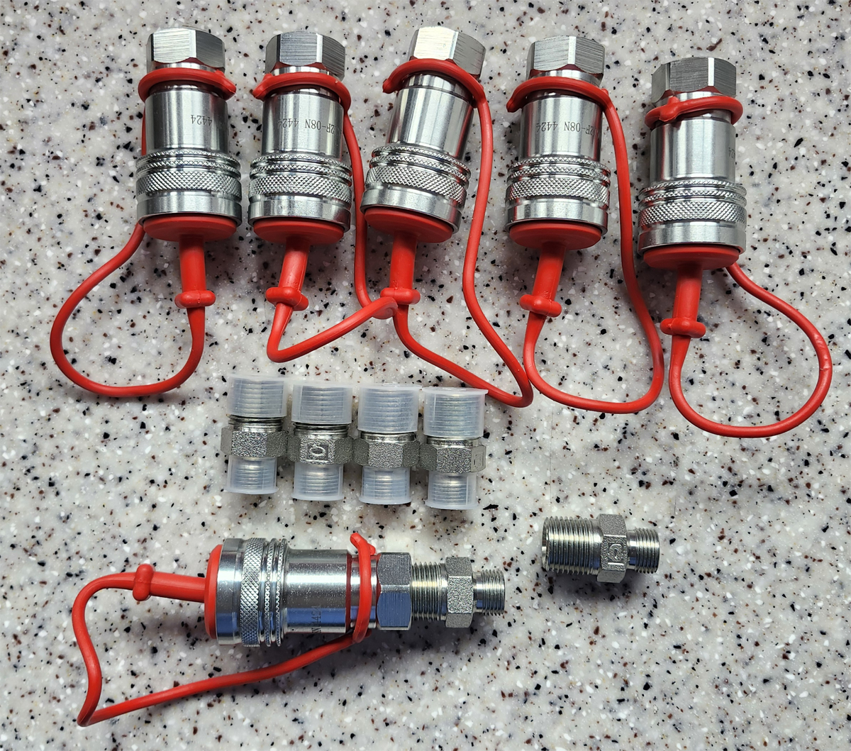

A picture is worth a thousand words right? The Summit Hydraulics couplers arrived today but I'm still waiting on the PTFE paste that was supposed to be here last week. You can see the arrangement of the coupler and adapter (screwed in hand tight) which will replace the Faster 3CFPV couplers.
