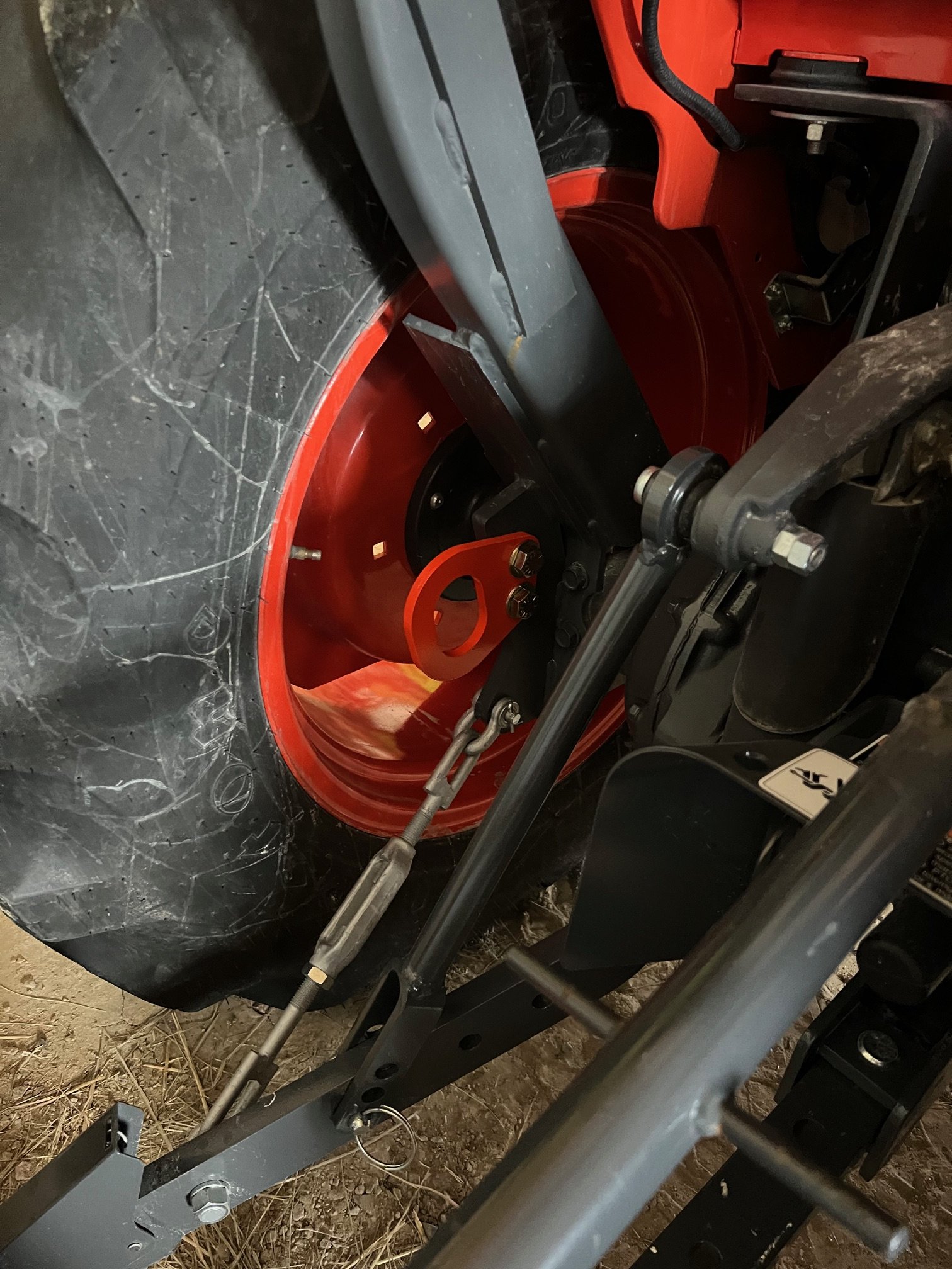

I've read a few threads on here and wanted to get some opinions on this setup. Tractor is L3560HST with LA805 loader. Filled tires. QH15 on back. Going to be renting a trailer 2x a year to haul it 400 miles each way for some farm work.
I added the JU Fabworks tiedowns on front and back. The front ones seem to provide a nice line for using chain tiedowns. Like a direct line to trailer if that makes sense. Pic attached.

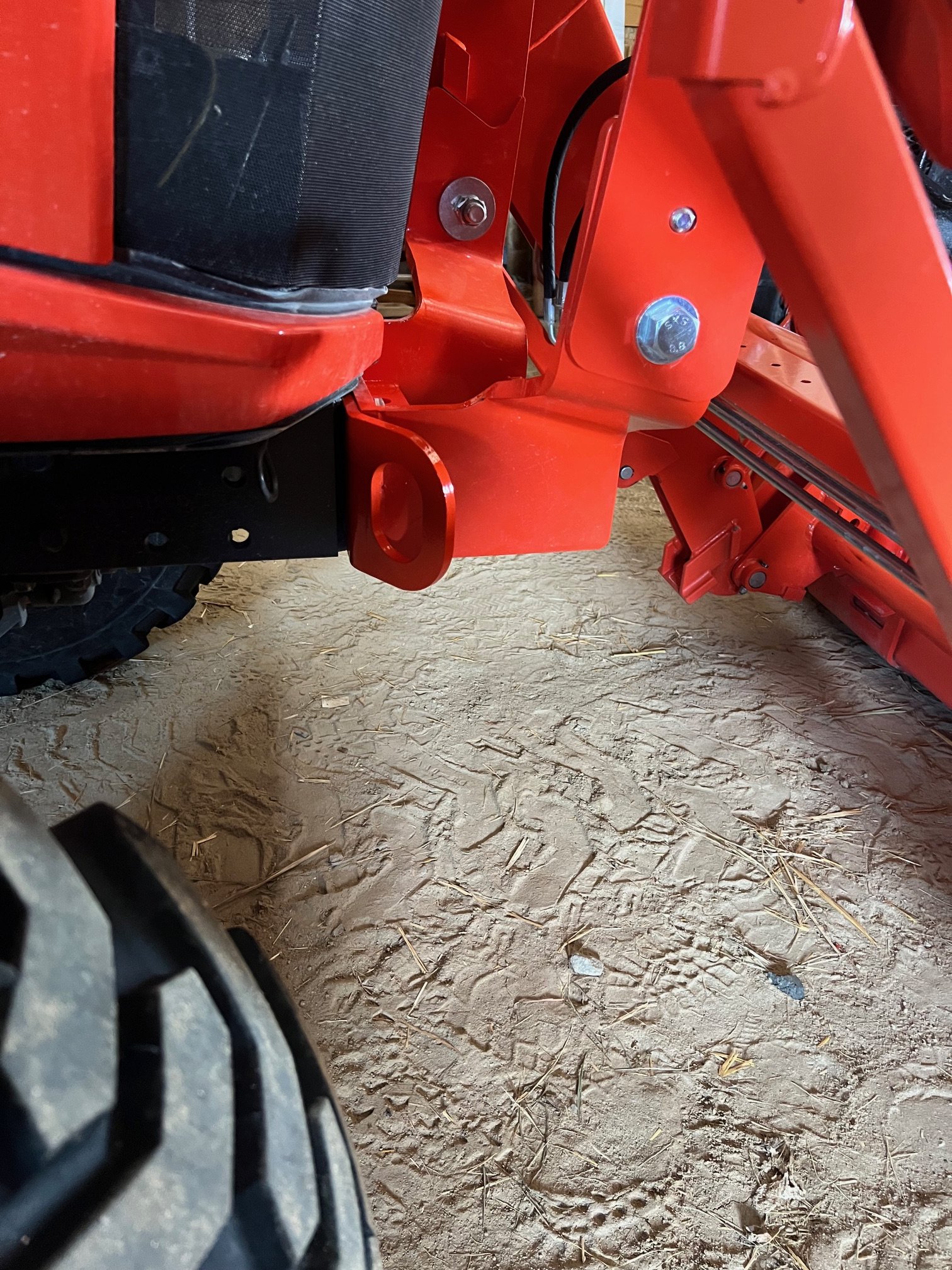

The rear ones are well inside the R4 tires. Would a guy strap to the tie down and have chain wrap around tire to side of trailer? Or would I need to try and strap directly back to end of trailer from each tie down?
Or would using a big loop on tractor drawbar and just running chain there be safe? Lot of question but new at trailering a larger tractor and wanted some advice.

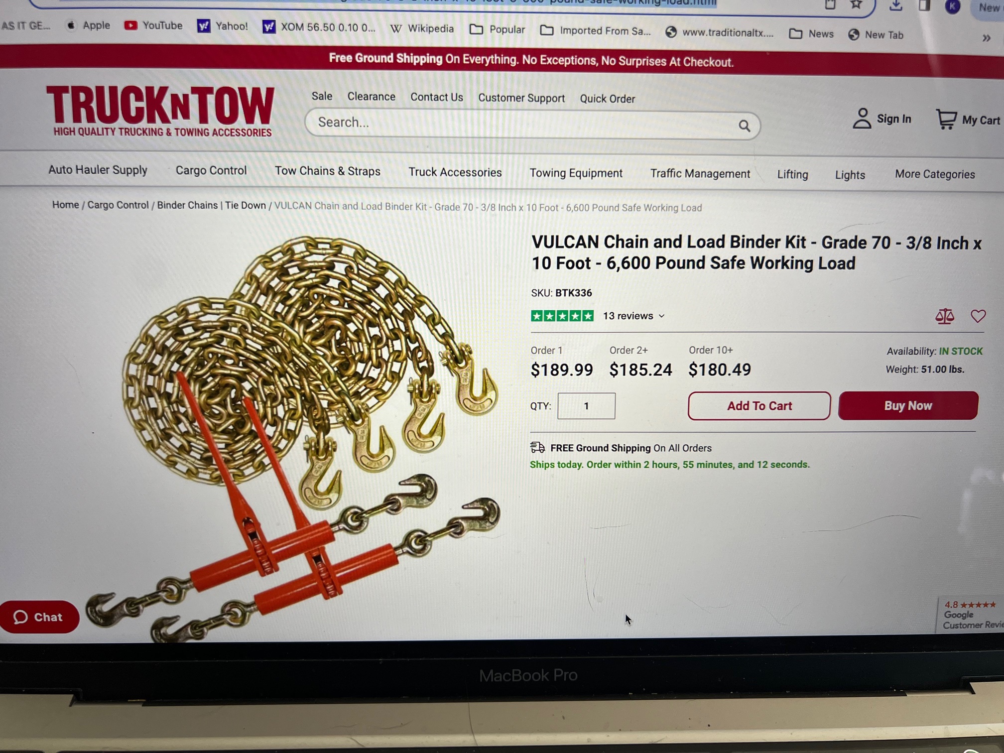

Lastly, these are the chains I am looking at. Thank you for any ideas.

I'd also suggest that you use 5/16" grade 70 chain instead of that 3/8". That chain that you show in the image is just too heavy to work with and way overkill for your needs.

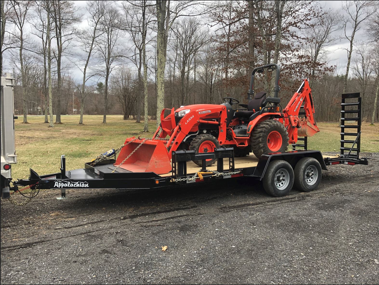

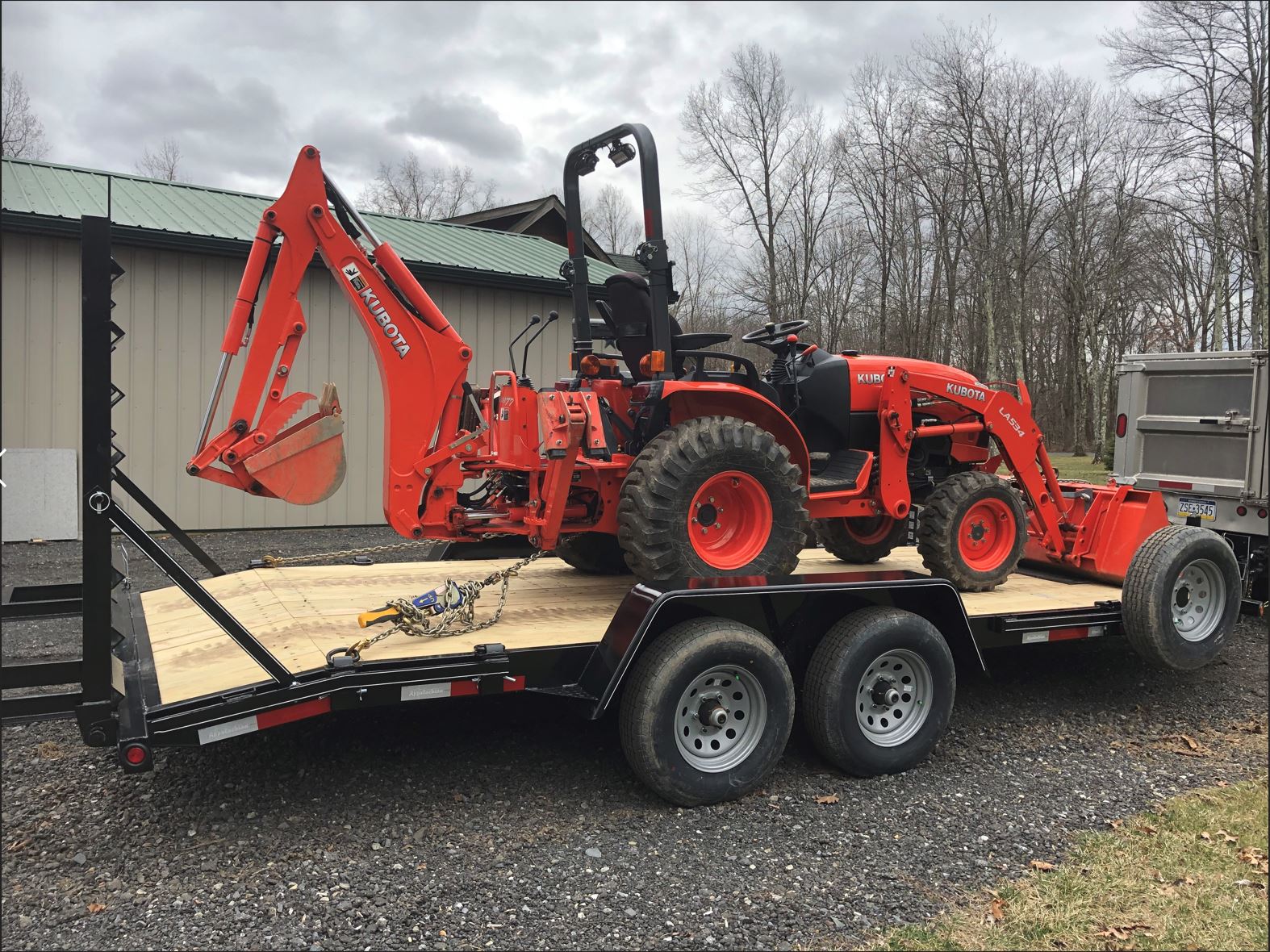

here's all I do..if I happen to have a boxblade on instead, I just go right over the top of the boxblade to anchor that down as well. Gotta remember, most of our tractors are way under the 10K limit which carries some more DOT requirements...

I might be wrong, but I think NIW was referring to this specific situation, and crossing the chains as an example of 'best practices", since the OP put those tie down points on.
When I don't have an implement on the back, I also do the "clevis in the drawbar" trick.

Here's one interpretation. In cases where the chain attachment to the tractor is forward enough that it interferes with running the chain to the same side of the trailer. If the chains are attached to the trailer without crossing them (RED) they pull against the tires. If crossed (GREEN) they don't.

I see / understand what saying there…are you using the BH subframe then for a tie down location? Does your chain not contact your 3pt arm stabilizers?

I use the tie down location on the BH if it’s on, or a clevis on draw bar when no BH. My preference would be to actually cross the chains, but I have not figured out a good way without potentially damaging something else…I am hoping I am overthinking things and there will be a KISS solution shared.

This picture is of the rear end of my L4240 that I never hauled. This was just to illustrate "crossed chains". I have hauled my L3200 and B7500 when I had them. For that I used a clevis through the (real, not 3 point) drawbar and ran chains in a V without needing to cross them.

Got my 4 ratchet devices. I decided to use 3/8" chains on the rear to keep tractor from going forward in a hard brake situation or at least hopefully prevent that. Using 5/16" chains on both sides in front. And have some heavy duty straps to get over the bucket or brush hog.
