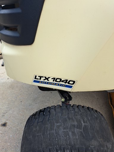

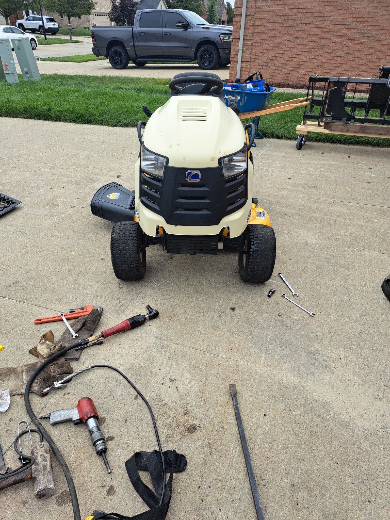

As you can see the starboard tire is bent inward, but it looks to be in "OK shape"

So the steering linkage on the right side is all bent to hell. I'm pretty sure thats what he was calling the axle.
So I take the torches out to heat it up and bang away at it with the BFH. It moves a little but not like it should have......Hmmmmm.....something is amiss......
BAM there it is......It hits me like a sack of hammers.......all the grease zerks are factory new with no grease on them.....
I disconnect the "tie rod" and the wheel is frozen solid.
I try greasing them, but its still frozen.

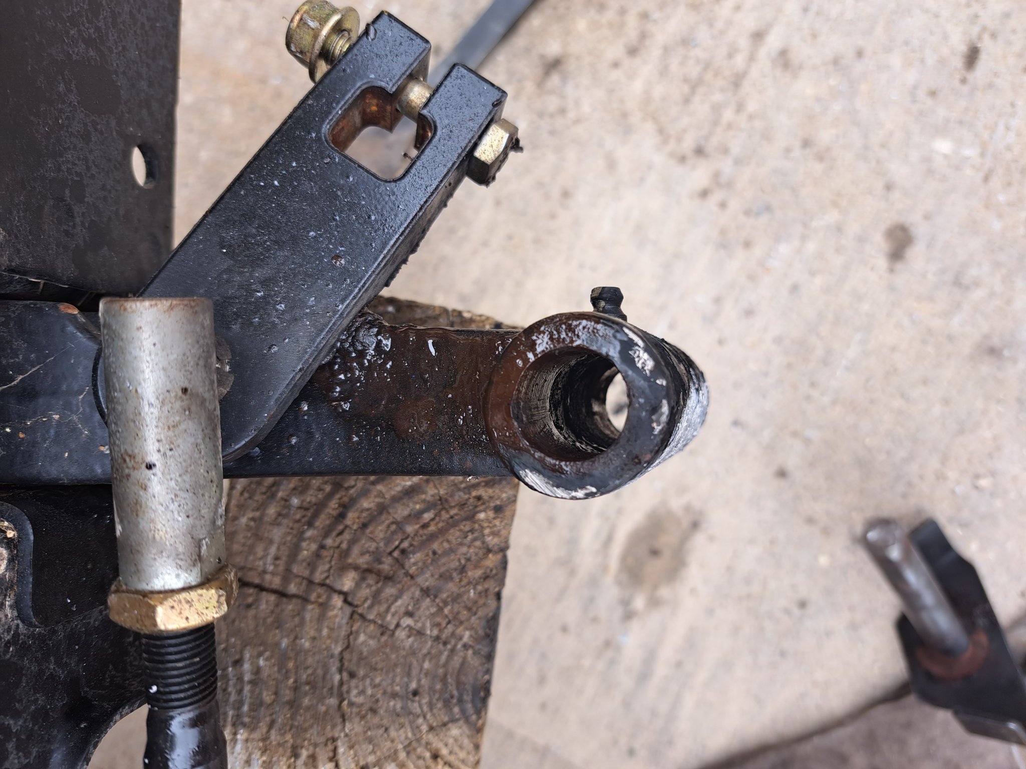

I decide to take the tire off and grab the torches, and begin heating up the "King pin" (I have no idea what it's called)
2,931
3,595
after a a minute or 2, I grab the impact chisel and have at it.
It moves a little, but its time for the BFH.
I start whacking at it, and it moves some more, but the top begins to mushroom a little.
I say F it, I pour some more heat into it and some more whacks with the BFH and Whala
It pops down, but I mushroomed the head too much for it to come out. A little work with the grinder and it's out.
Then a few seconds with the Bench wire wheel

dang you're one LUCKY guy !!1 Looks like a very nice condition MTD !!!50/50 ACE/ATF dribbled in the 'joinery' will loosen it up overnight. cheap MTD have stamped steel axel, better(lke Cub cadet ) will have cast iron ones. One of those EASY fixin jobs..add oil, go to something else jobs.

After wire wheeling it and a little grease, It slides back in like "Budder".
Reassembly is quick and easy. But the alignment is still off by a mile.
A few turns on the tie rod ends and I'm in the ball park.
I decide to leave it slightly "toed in"
Well I don't think I'll be turning laps at Daytona with this alignment job, but it's good enough for doing laps around a 70' x 125' yard....LOL

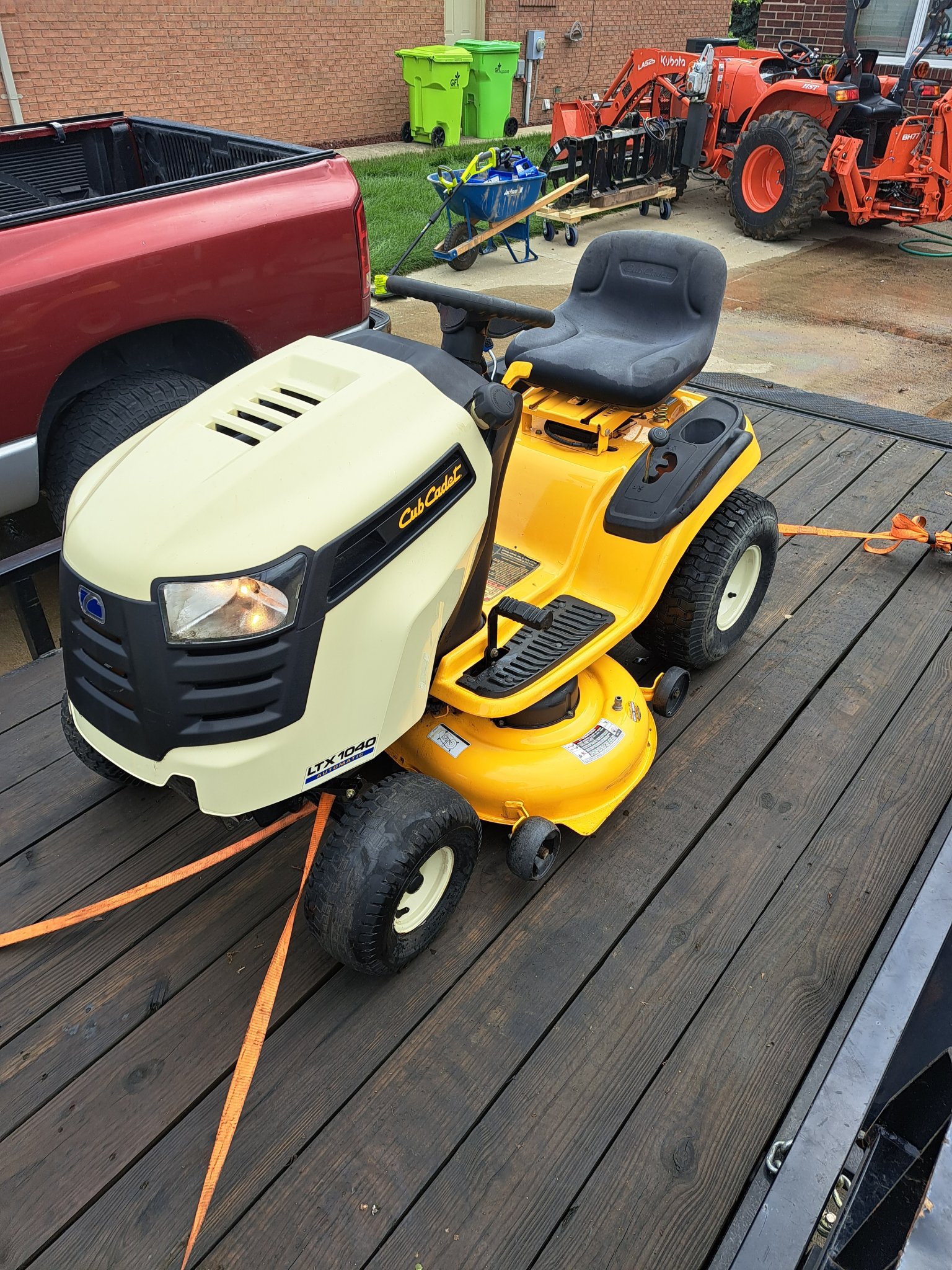

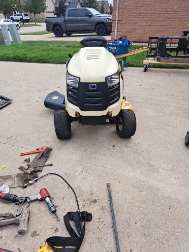

And here she is in all her glory.....

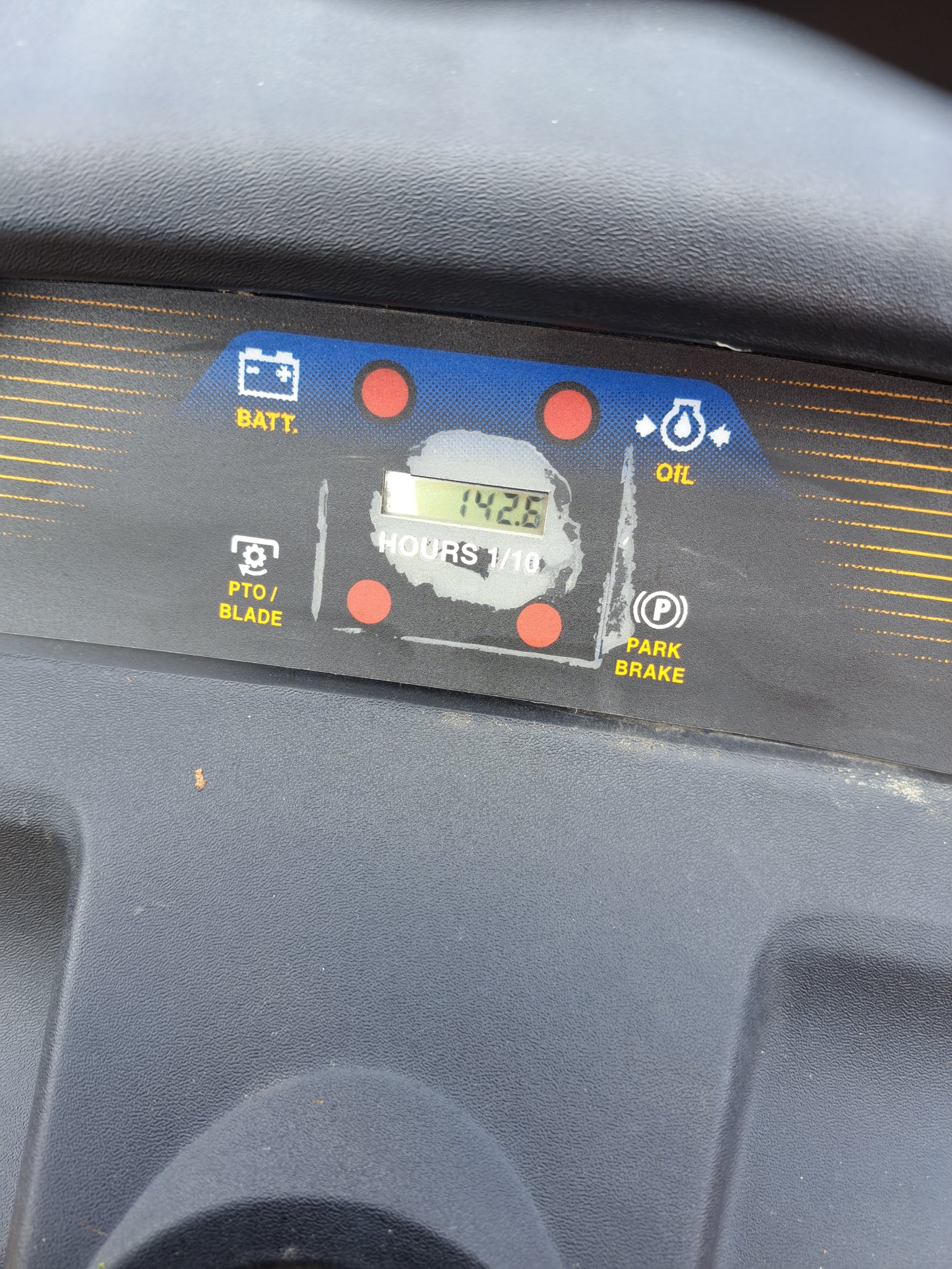

turns out to be a 2011, with 142 hours on it.
A little soap and some easy pressure washing
2,931
3,595
Here she is, ready for delivery.
She looks damn near new.

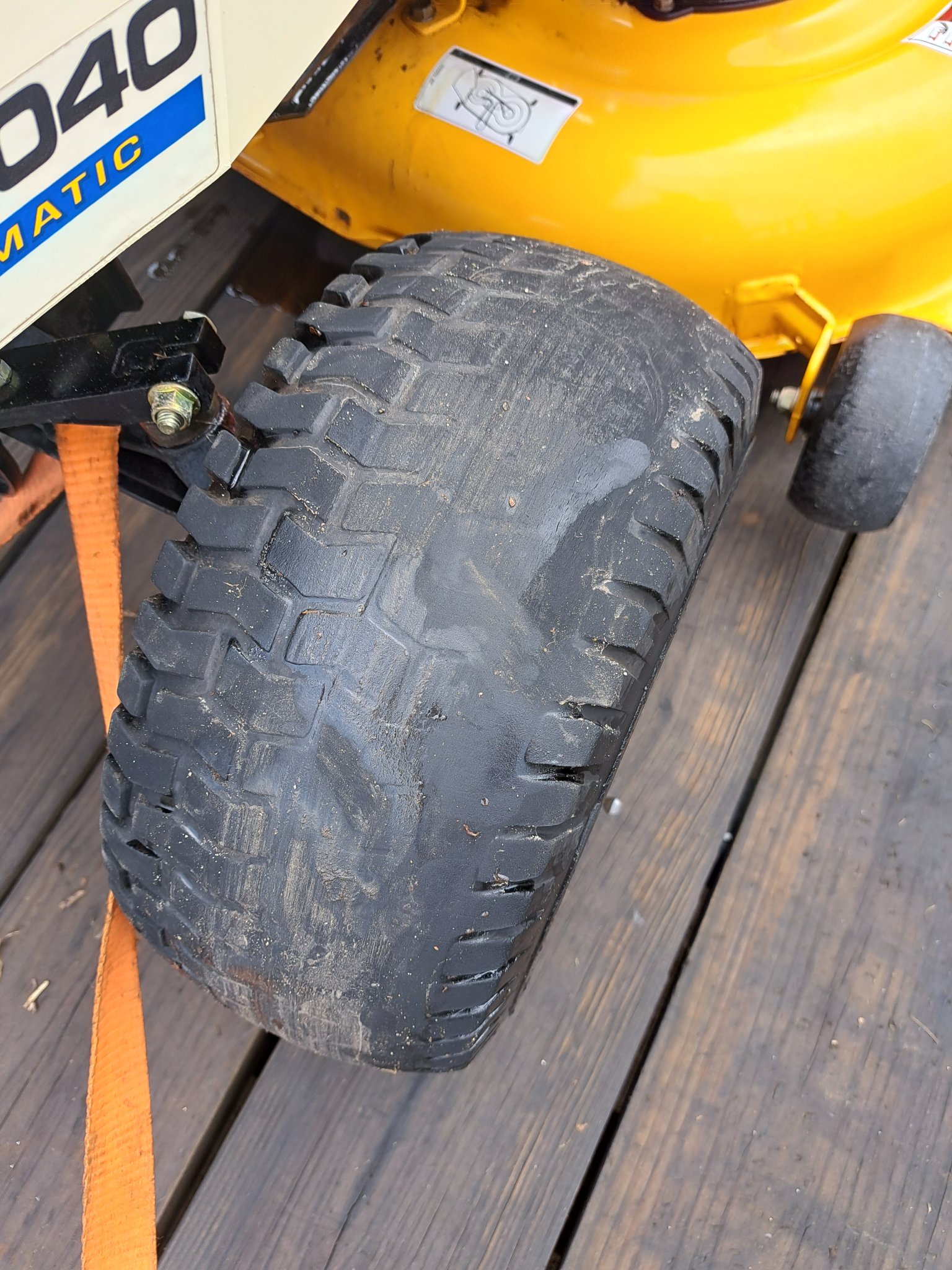

Front tire is wasted, but it will work for now.

Actually this one wasn't bent, it was rusted in that "turned position" because he never greased it.

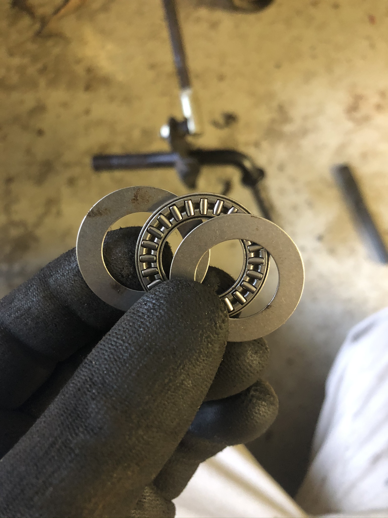

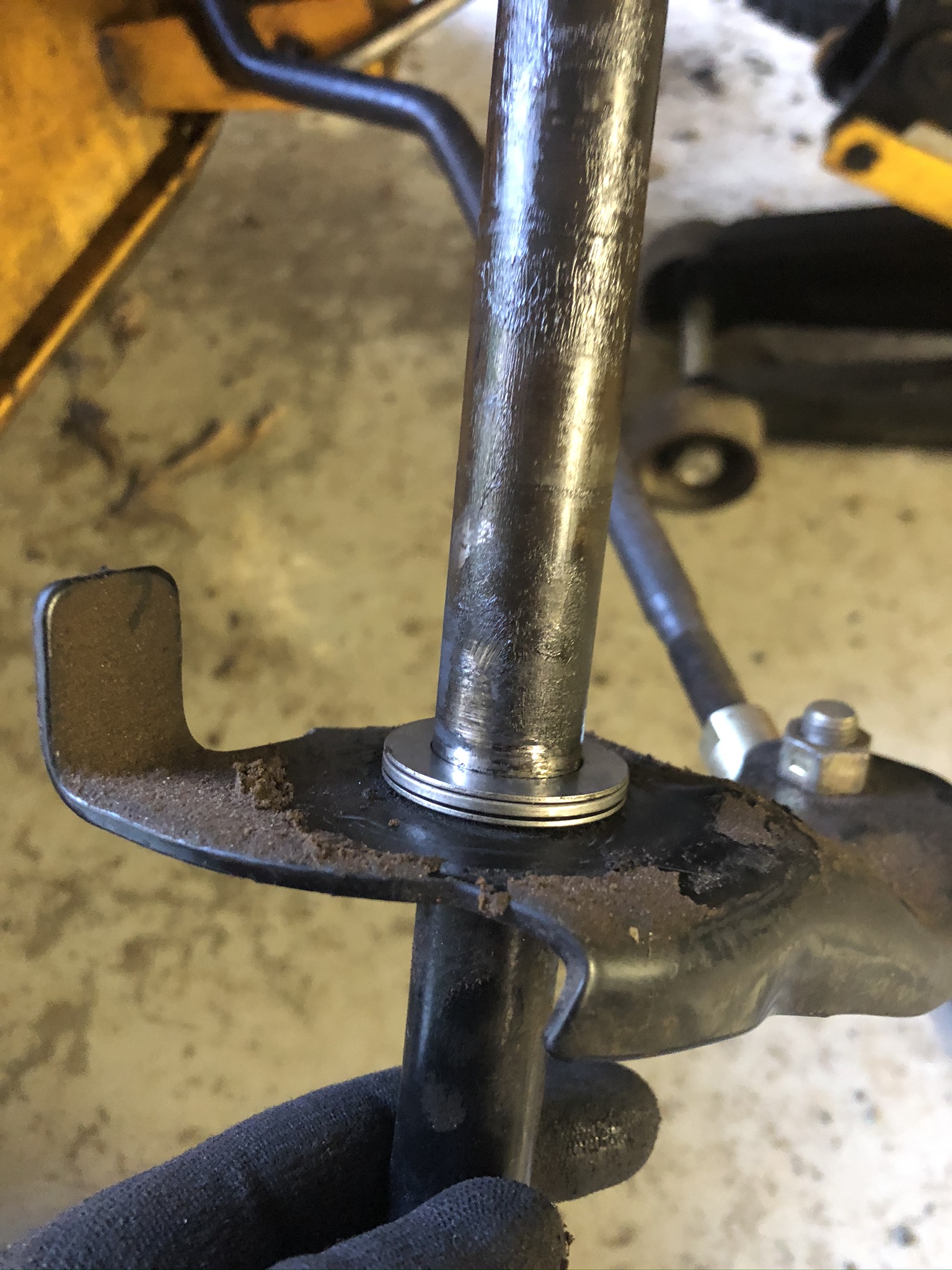

If you want that thing to steer with one finger, get some needle roller thrust bearings and machined washers. I did the same on my cub and it is awesome.
My setup is a bit different than yours, but should still work.

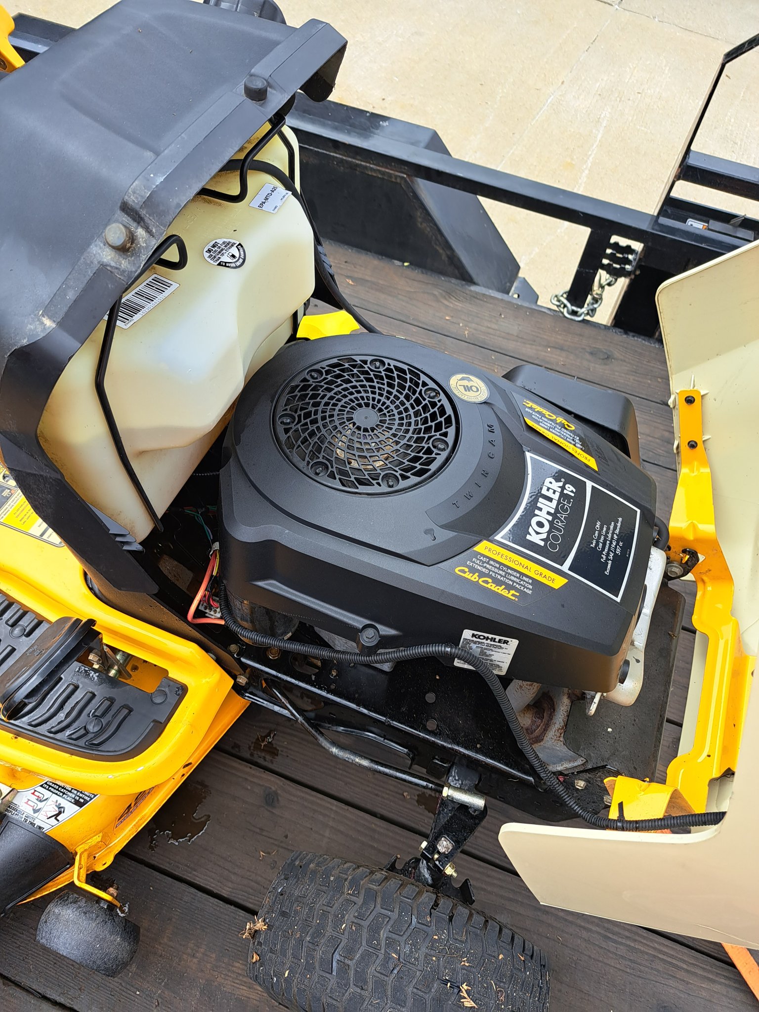

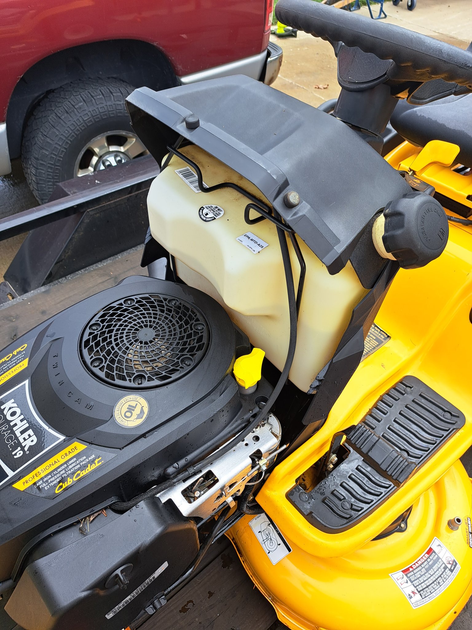

Also, that kohler 19 is a ticking time bomb. Pull the fan cover, and flywheel and lock tite a few bolts so they don’t wiggle loose, hitting flywheel and breaking the block.
