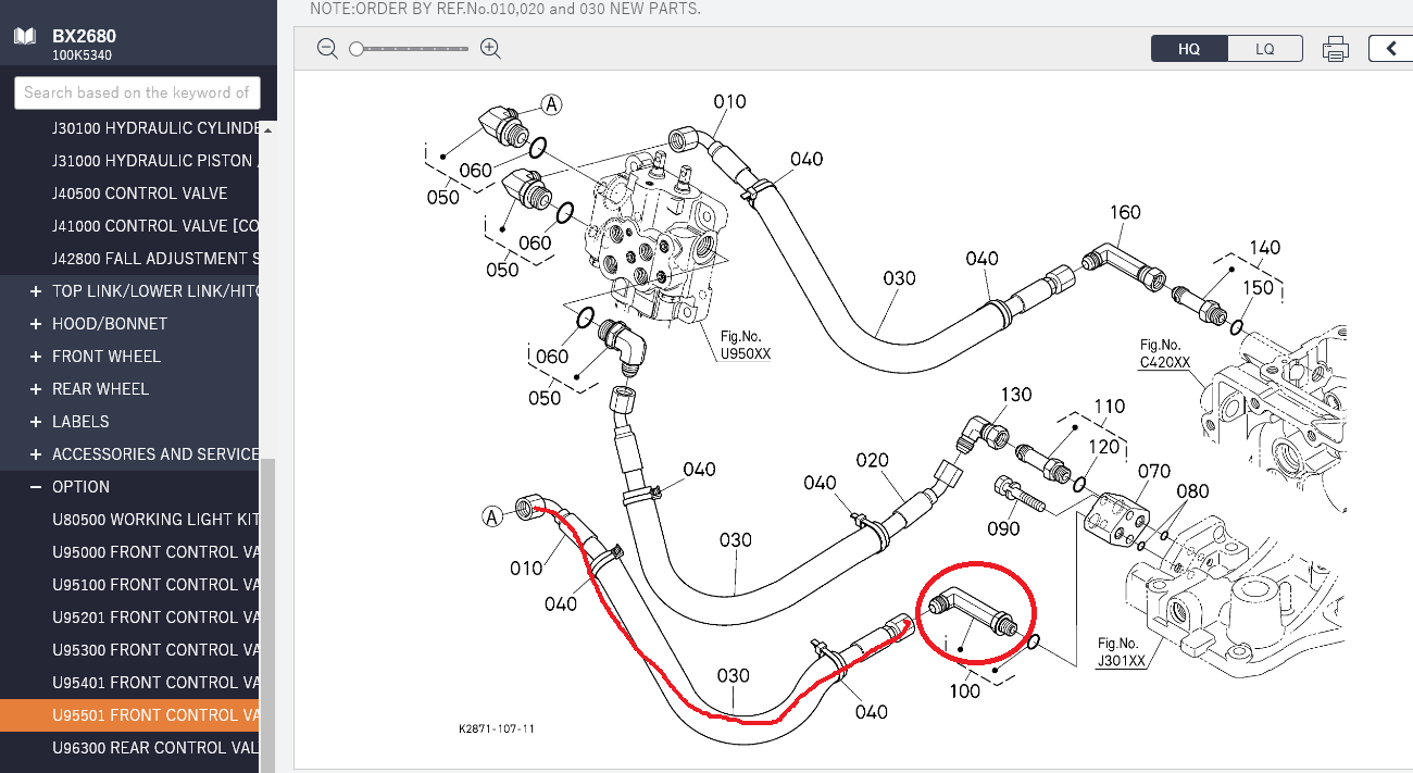

Well if I ever get a 3rd function I'll be coming back to this thread.. maybe it will help with my 2680. Been wanting a grapple for a while. Thanks for all the pics B737!
9,896
5,240
The BX2680 loader valve uses hoses rather than steel pipe for the connection to the hydraulic outlet block. Even easier to hook up. Assuming no backhoe:
  1. Remove right rear wheel.
  2. Disconnect hose #10 from elbow #100 at outlet block #70
  3. Connect free end of hose #10 to pressure in (P) port on third function valve
  4. Using new hose connect tank (T) port on third function valve to elbow #100.
  5. Replace wheel
I would expect all connecters and hose ends to be JIC-8 or possibly JIC-6

Even better., Thank you!
