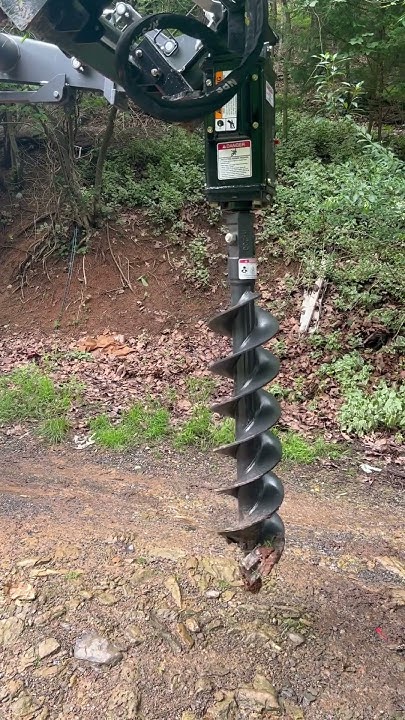

Still learning! This hole was on the side of a hill so getting the angle right wasn’t easy, especially as we went lower. Yes, I stalled the tractor at one point but we ended up getting the hole finished, this was the only time it stalled the entire time so of course it was when we decided to do a video... We put in 10 posts, the holes were the easy part. Setting the posts is now the hard part. This is by far a much better solution than a 3pt auger. Drilling 10 holes in rough rocky ground only one hole had to be moved first spot we encountered a LARGE rock less than a foot down. The rest of the holes encountered rocks but the auger either went through or pushed them out of the way all of them were easy except the one. We didn’t have time to get more filmed as I didn’t have help for a good part of the job.
Definitely would highly recommend this solution to any one with third function hydraulics, the gpm flow for mine minimum is ~8-10 gpm although I believe land pride has one that runs as low as ~5 gpm (I think). Be sure to have spare teeth if you have rocky soil. Haven’t broken any teeth yet but already see a little wear, not a lot but enough I know I’m going to need spare teeth on hand.

Thanks. Looks like you need to creep down hill as the hole advances to try to keep a plumb hole.
