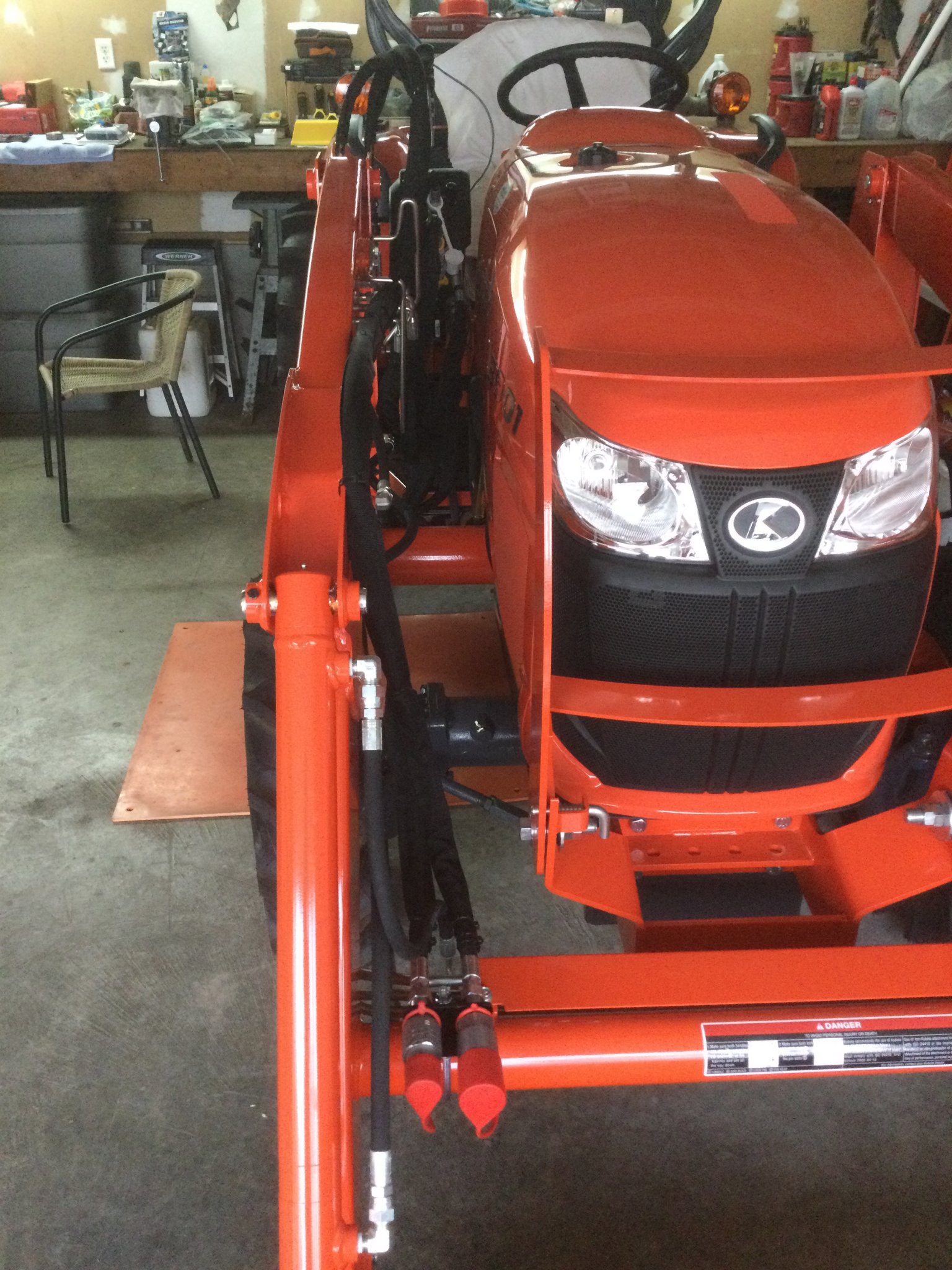

Everything is plumbed following the provided instructions. I’m waiting on heat shrink to arrive to cover the joy stick handle wire. And nylon loom to run the power wire, so I haven’t operated the 3rd function yet. So far only able to check for any leaks, all good there.

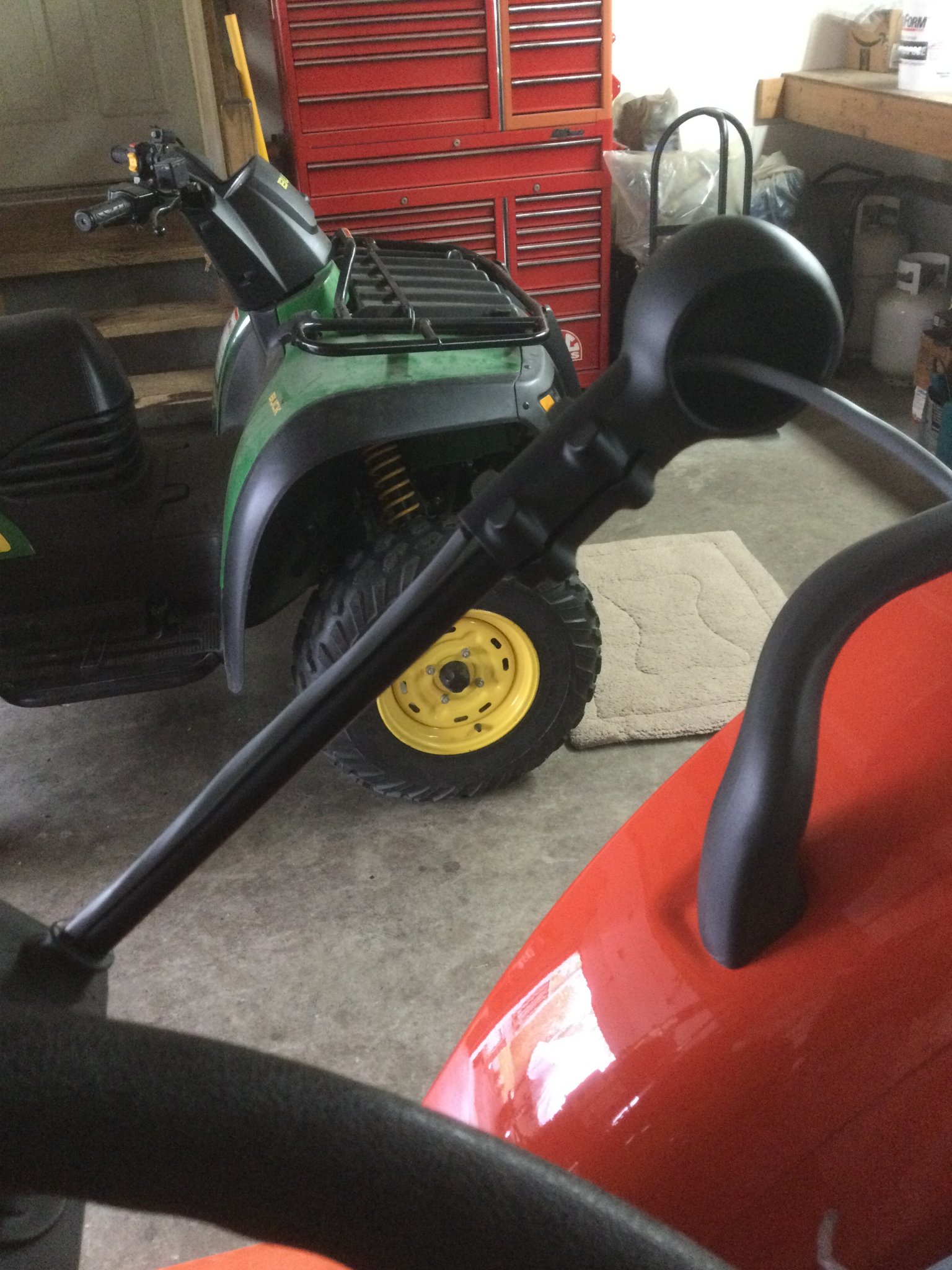

Im impressed with the Summit kit, especially the joy stick handle, which was what pushed me to buy the Summit kit in the first place. The buttons in the handle can be clocked to fit your likings. You can have them vertical, horizontal or set to 45 degrees.

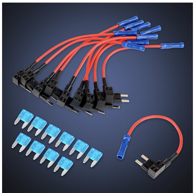

Wanted to mention the item below is what I used to easily add power (along with a fuse) to the 3rd Function Valve I installed.

Care to share a link to where you bought theses? I’m going to pull switchable power from the fuse panel.
These came from Amazon
I used the same circuit as my hazards so I could have the tractor off and still take the pressure out off my dual lid grapple hoses right before disconnecting them.
Excellent idea!
I was trying to save that circuit for the ROPS leds for power with the tractor not running

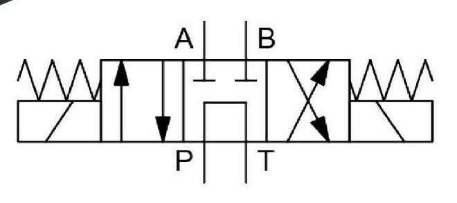

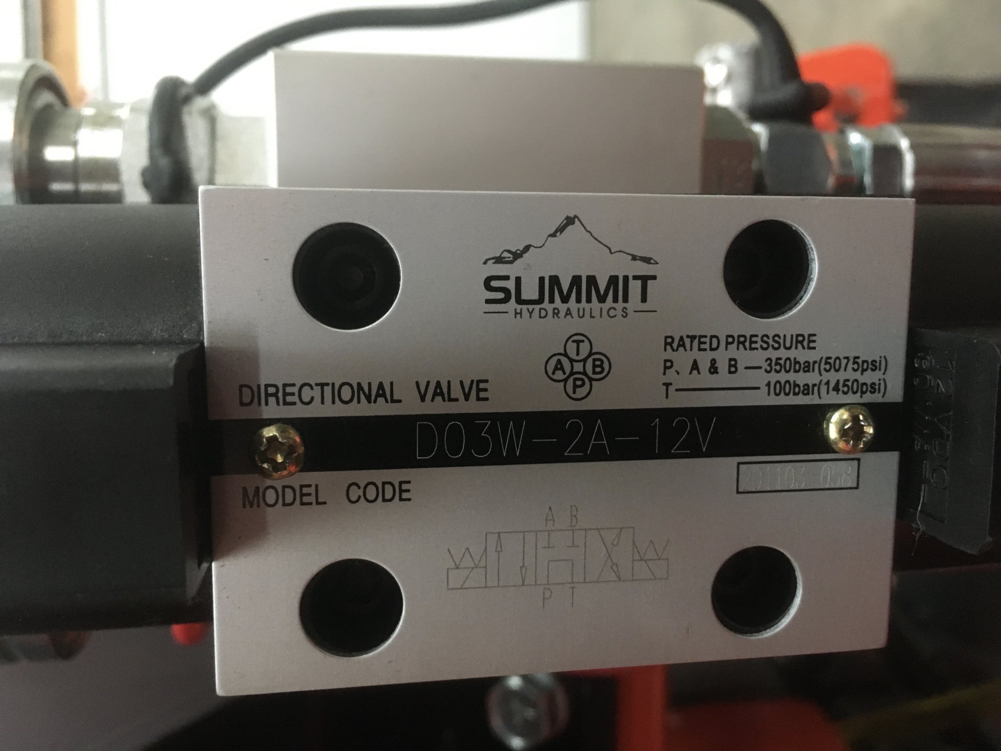

Looking at Summit's images it looks like the nameplate on the valve has a hydraulic schematic printed on it. It is hard to see in the pictures but I believe this is what it shows.
That is a solenoid actuated open center spring centered double acting directional control valve. These types of solenoid valves are widely used modular components designed for sub-plate mounting and this one is attached to a simple aluminum plate with 4 x SAE ORB threaded ports corresponding to the four base ports in the valve body. The only thing "special" about this valve and assembly is the tank port has a pressure rating very close to the pressure rating of the P port so for all practical purposes T and P are interchangeable. As you can see from the schematic cylinder exhaust oil will be routed to the T port (P port if you hook it up backwards) which is the basis of my concern. It will work fine plumbed either way but it is not the best (I would say a poor) choice for use in a circuit with down stream valves. Their Z50 valve with an additional power beyond port would be a better choice.
I think my intellectual itch has now been scratched and you can now relax and enjoy the third function on your loader.

From my valve
OK - spool characteristics confirmed but missed on the T port pressure ratings and that adds another more significant element to my concerns. The T port pressure rating on the valve is only 1450 PSI and there is no internal relief and it wouldn't matter if there was because their is no direct to tank connection to relieve through. The valve relies on an upstream pressure relief device for protection.
It is installed in a circuit with both tractor and loader system pressure relief settings of 2437 PSI so any time you stall the 3rd function cylinder or ANY downstream cylinder that T port will be seeing 2437 PSI which is almost double its max pressure rating. Even a heavy load on a down stream cylinder (e.g. 3pt) could be enough to over-pressure the port and I would expect that to be a common occurrence if you are lifting heavy implements. I am not a hydraulics expert but my understanding is the main pressure concern on the tank ports in these types of valves is the solenoid seals. Only time and field testing will tell you if that is a problem in this application

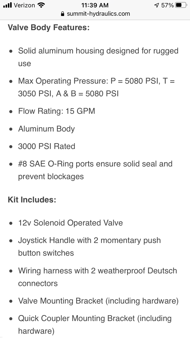

This is from Summits website describing the valve in the 3rd function kit. According to the description the T port is rated at 3050 psi. But is stamped differently on the valve apparently. Time will tell I guess on how it holds up. If it doesn’t I will replace with the valve you mentioned with a dedicated pb port.

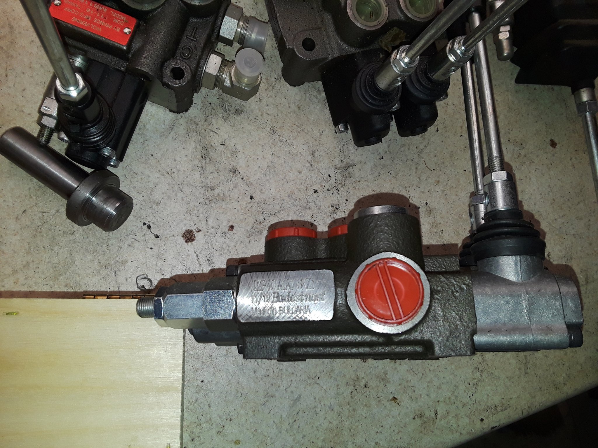

Yes, that description was the basis for my initial comment. Summit is a distributor not a manufacturer and they put their own nameplates on the valves they sell so take that data with a grain of salt. If you look at the body of the valve you may find additional information stamped there. For example this is one of their P40 mono-block valves I have in the shop. The manufacturer's name and full order number is stamped on the casting. If you can find something similar on your valve it may be possible to find a full catalog description of the valve. Many distributors provide those documents on their websites but Summit does not.
