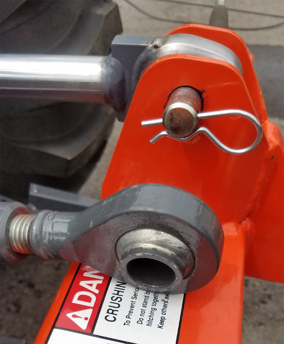

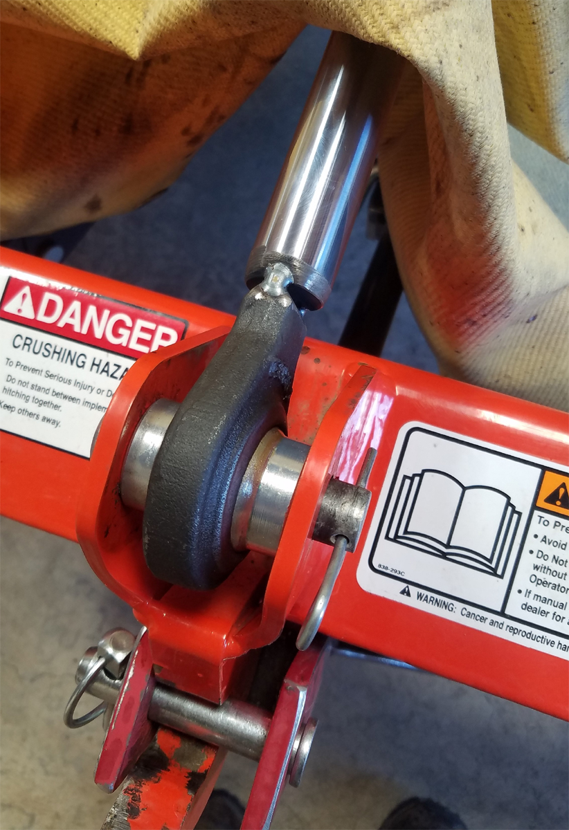

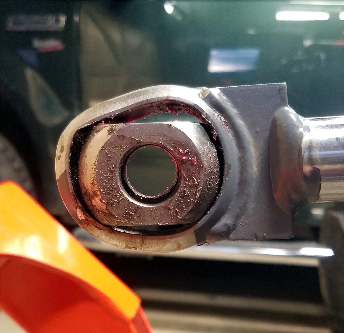

I was using the pressure washer to clean the MX this morning and noticed that the end of the top-n-tilt top link where it mounts to the top of the quick hitch looked odd. On closer inspection I realized that the outer ring has stretched into a rectangular oval if that's such a thing. I've been shortening the top link to pick up the rotary cutter to move short distances which obviously puts a lot of stress on that top link. I didn't think it'd be a problem but the Cat I/II design of the ball which has two holes and four faces means that the outer ring isn't fully supported by the inner ball as it is everywhere else on the tractor, and also on the two links that were replaced with hydraulic cylinders. Clearly there's nothing wrong with the weld since it looks solid, but that heim joint is a poor design.
You can see in the photos below that the outer ring has stretched and elongated under load. The local dealer gave me a new heim joint to weld on which is much stronger and has the standard single hole and ball that supports the outer ring. You can see the heim joint on the end of the top link that came with the tractor along with the new heim joint.

This photo shows the damage really well. That outer ring is supposed to be circular. Regardless of how it happened, if the ball were a complete sphere this couldn't have happened.

That heim joint needs to hit the gym and bulk up!!
Very poorly designed with such a thin walled outer ring that’s heavily point loaded by the square-edged “ball”. Just nothing to support it from collapsing.

I agree and I'm going to replace it with the Cat II heim joint shown above and use a bushing. This is the Kubota top-n-tilt factory option so I'm kind of surprised they made them like this. They should have gone with Cat II and provided a bushing and be done with it. I've asked the dealer to pass these photos up the food chain but I don't know if that will happen. I did get the new heim joint for free but it's only $16 or so anyway.

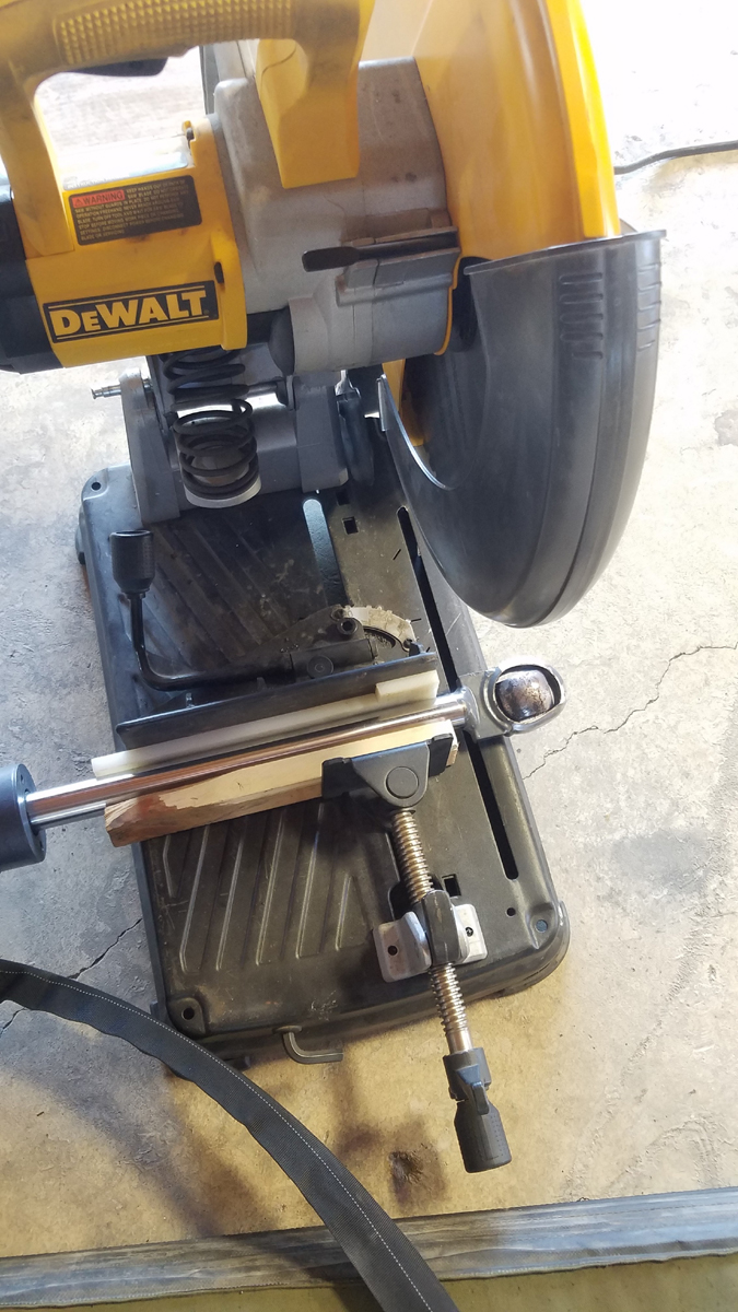

I have a DeWalt steel blade chop saw so If I can get the end of the ram cut square it should improve my chances of getting the new heim aligned in one plane at least. This is the time when I wish I had a nice horizontal band saw.

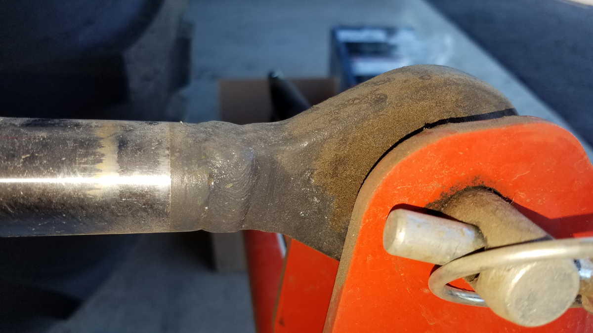

I got the damaged heim joint cut off fairly square, cleaned up the old weld, and used the quick hitch/receiver along with the link I made to align and hold the new heim in the correct orientation relative to the ram so that I could get a few tacks on. I need to finish weld the joint and paint. Probably going to run some 6011 in first followed by 7018.

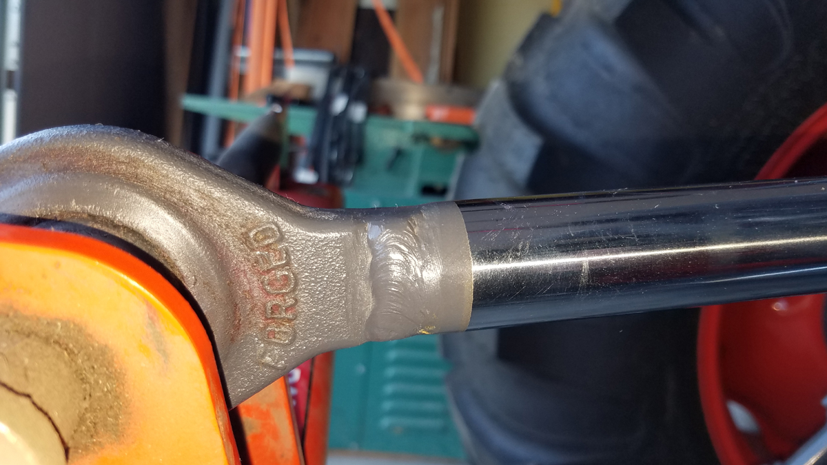

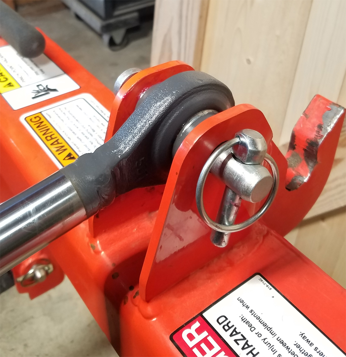

I was able to finish up welding the new heim joint (6011 & 7018), paint it and get the cylinder and quick hitch back on the MX. Hopefully I don't have to revisit this problem. This is how it should have been in the first place. The local dealership manager (who bought my BX) is going to send the bad joint off to Kubota headquarters for them to review.

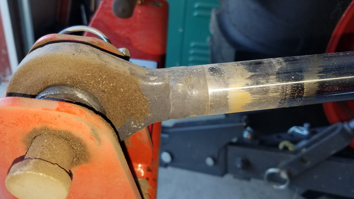

I wanted to give an update on the replacement top link heim joint that I welded on. I've put 25+ hours of hard mowing (rough terrain) with the 1,000 lb RCR1884 as well as a bit of box blade use on the new joint. I've raised the cutter off the deck many times and the joint is doing fine with no sign of impending failure. I run the rotary cutter with the top link connected. The first two photos taken this morning show the top link in its normal state. The bottom photo shows the top link this morning after wiping the crap off. 7018 for the win!! :D
