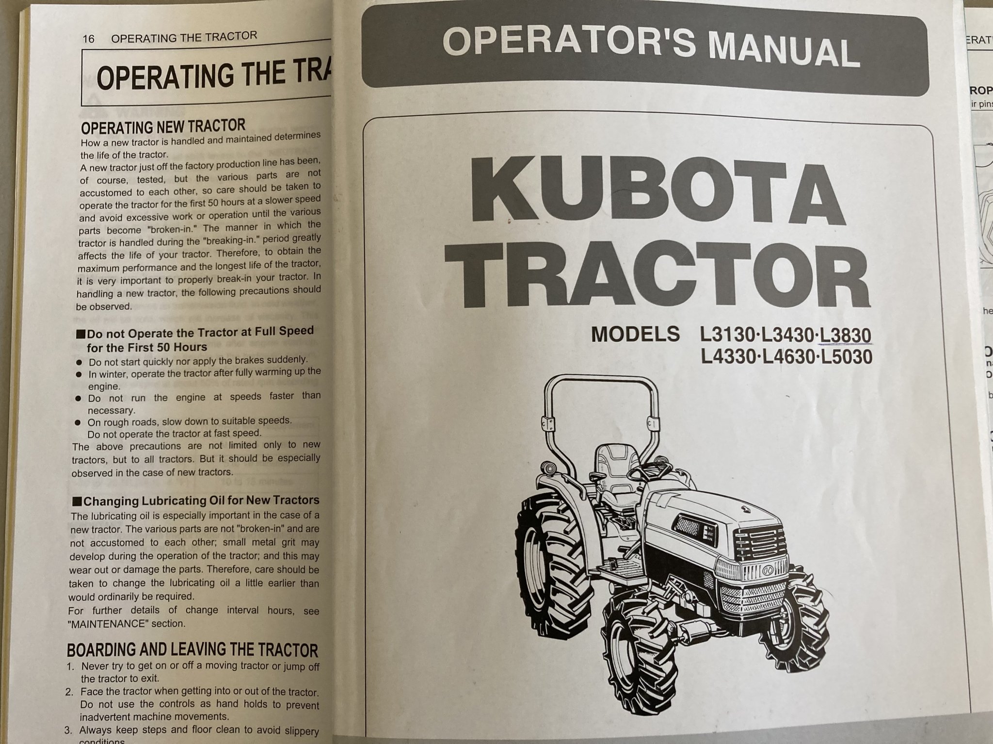

Just use it reasonably. Kubota says nothing about a break in period. Most of these Kubotas need to be at or quite near the max rpm to have the proper PTO rpm. Generally you don’t need quite that high an rpm for loader work.
Dang if my manuals don’t say to keep it in a glass bell filled with Argon gas and do anything but use it reasonably. Or, wait maybe keep it reasonable is what they suggest? Don’t jackrabbit start, go too fast, brake too hard or run the engine rpm higher than needed. Warm it up in the winter. But you should do that anyways, but especially so with a new tractor. And then do a 50 hour service? Probably reasonable.
