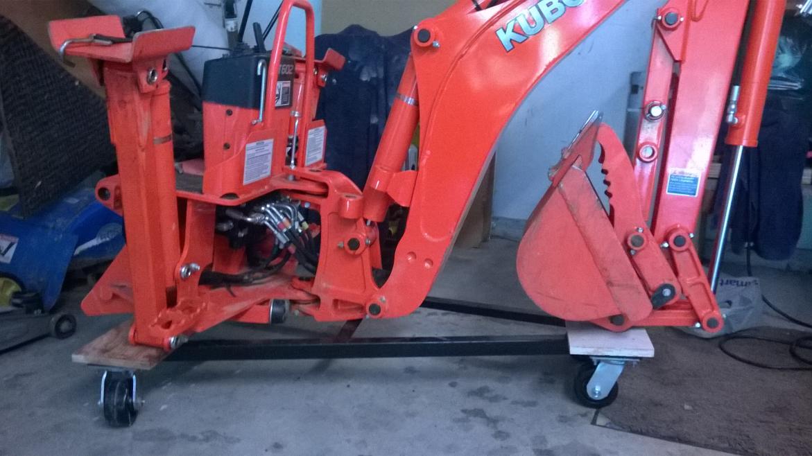

I had asked if an old bedframe was strong enough for backhoe dolly and concluded probably not. But having found some 1/2" x 5" skid plate in my supply I decided to give it a try on the theory the plate would hold the wieght; the frame just ties it together. I added plywood to the top to recess the wheel bolts and make it a little easier on the paint.
It works, but, I would still use something heavier than a bedframe if I did it again.

It works, that makes it a success. Thanks for posting the finished dolly.

Andy - excellent work!!!

Nothing wrong with that design! Having those arms flexible keeps the casters in contact with the floor. That's a good thing!

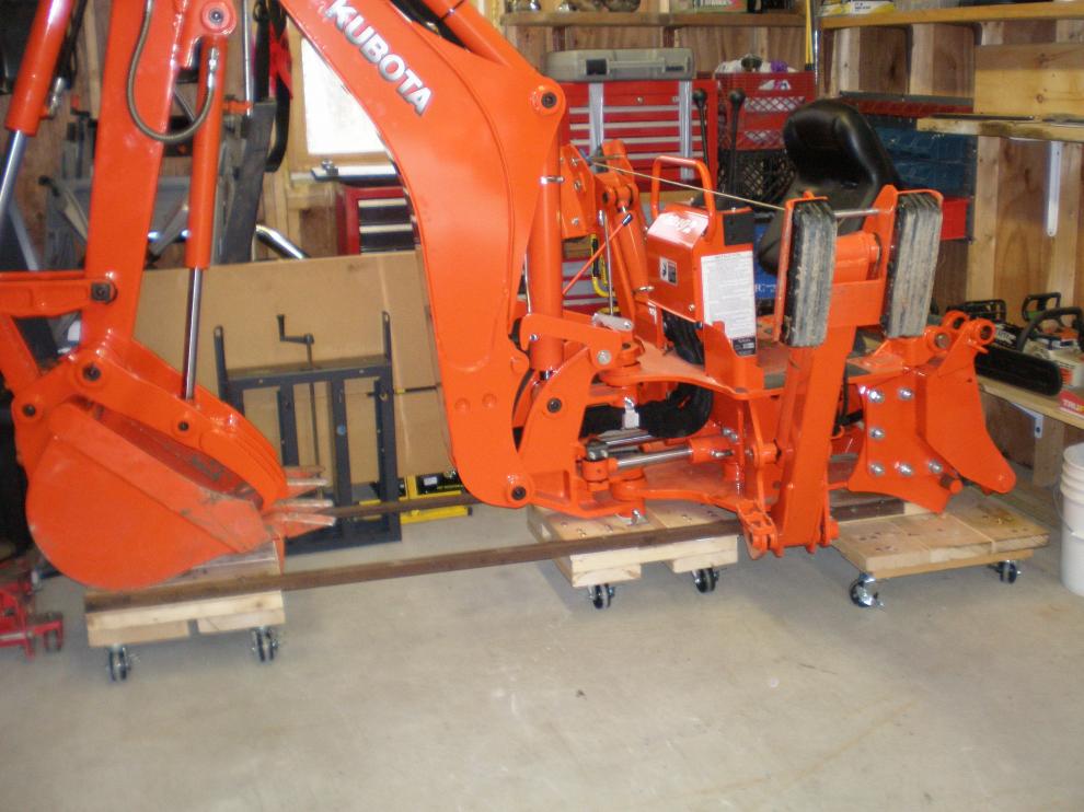

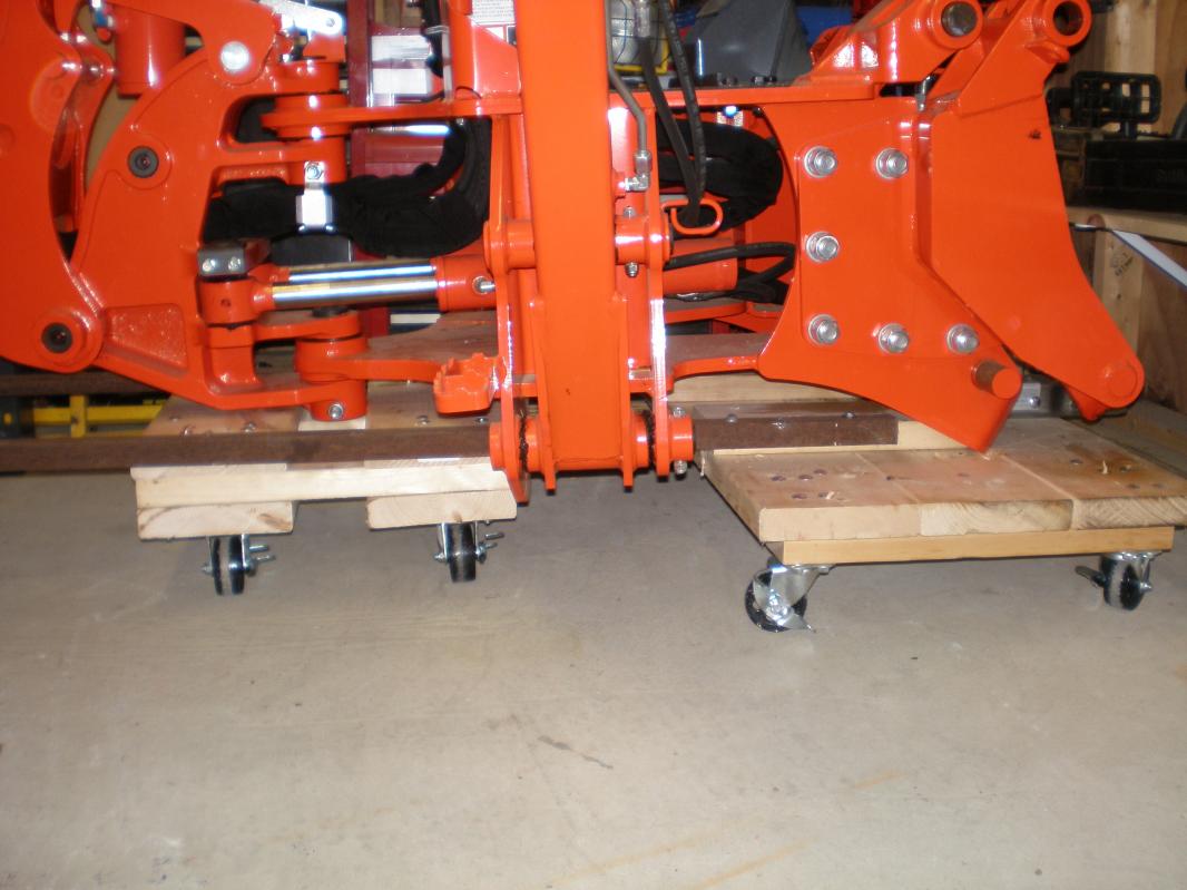

I had a challenge with my BH92 for my L3560 tractor. I originally used all wood, but the 2 X 6 boards I used as connectors from the bucket end to the control end would sag when the hydraulics would relax. I ended up using angle Iron and a 3rd pad for the middle.
