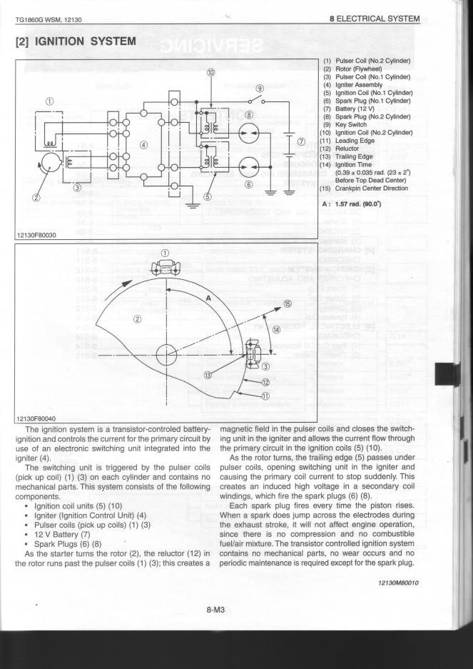

I also have a TG1860G that started to barely run after 30 minutes or so last Fall. Now it won't start at all and just like Kenbutts I checked the safety switches, plugs and coils - switches are good, plugs are great and there is 12V at the coils but no spark. I also assume it is the (very expensive) Igniter - where under all those shrouds is it located??? I hate to take everything apart only to find it is relatively easy to get at!
33,320
8,662
If you have 12V to the coil and you break the connection do you get a spark?
If not you have a bad coil. ;)
