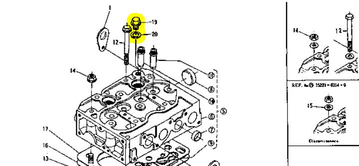

North Idaho Wolfman Moderator Staff member Lifetime Member Equipment L3450DT-GST, Woods FEL, B7100 HSD, FEL, 60" SB, 743 Bobcat with V2203, and more Jun 9, 2013 34,198 9,393 113 Sandpoint, ID Feb 21, 2021 #2 Right rear of the head pull plug and replace with temp sensor.

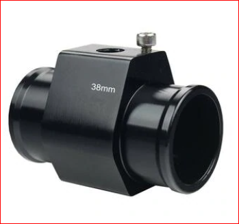

85Hokie Moderator Staff member Lifetime Member Equipment BX-25D ,PTB. Under Armor, '90&'92-B7100HST's, '06 BX1850 FEL Jul 13, 2013 11,012 2,871 113 Bedford - VA Feb 21, 2021 #3 Another way to skin the cat is to cut the top radiator hose - insert this aluminum "TEE" and place the sensor in there make sure you use the grounding screw to make the electrical connection. - the head method is easy when the fittings fit perfectly. The hose method requires the correct ID on the hose. Both do the job well.
