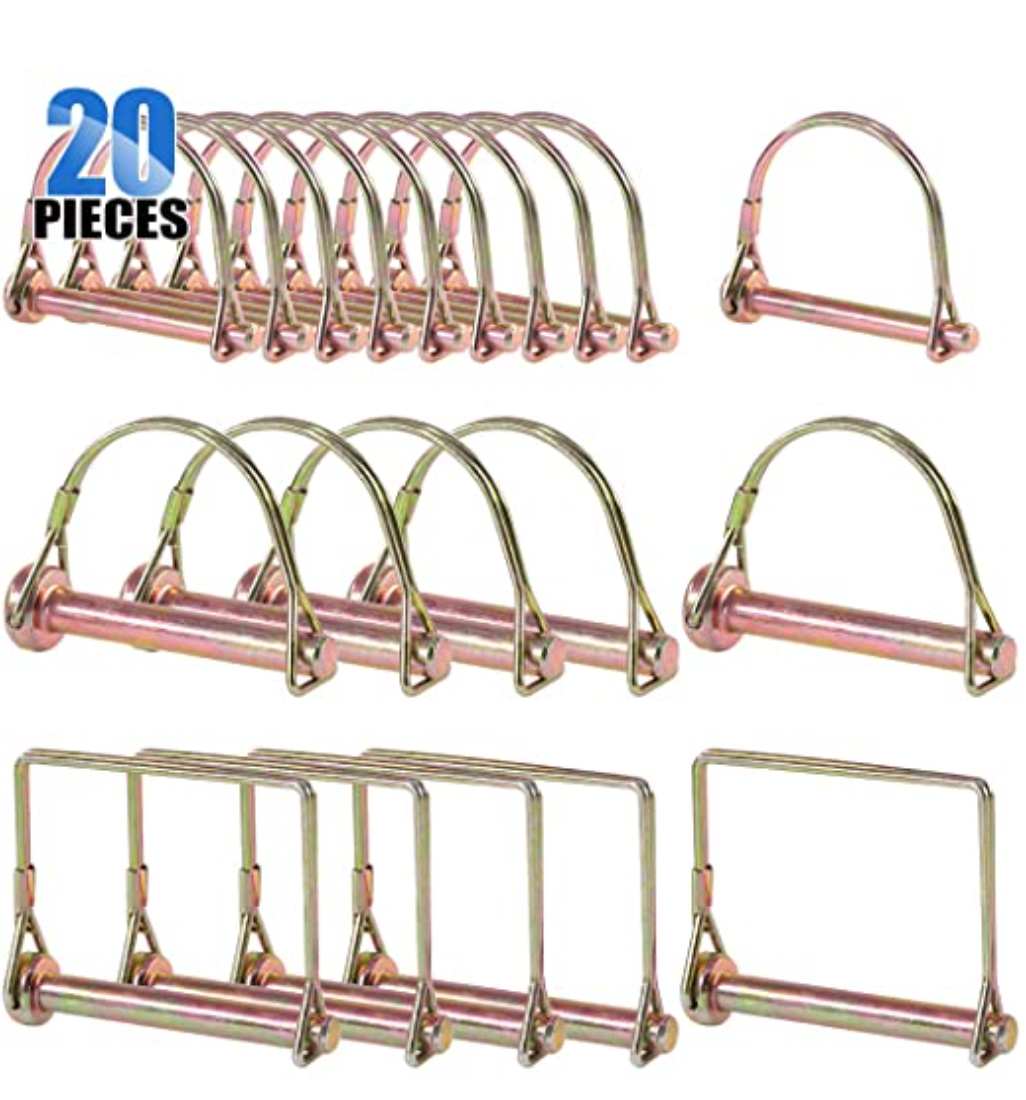

Yesterday I installed the L8430 kit on my L3800. I have the same issue with the hitch clips. Even if it wasn't cold out my fat fingers would find a way to lose them out in the field. Today I'm waiting for Amazon to deliver this:
Got to love Amazon :)
