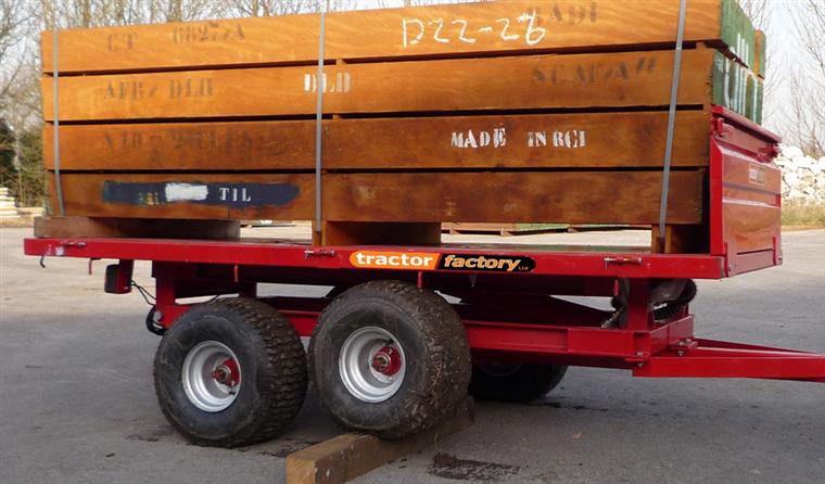

thanks for the reply, sort of but bigger.
found this pic before i saw your reply, but this is a 2 ton trailer , i'm thinking more in the region of 1 - 1.5 ton capacity.
there does appear to be numerous way to achieve this setup by the looks of things.
