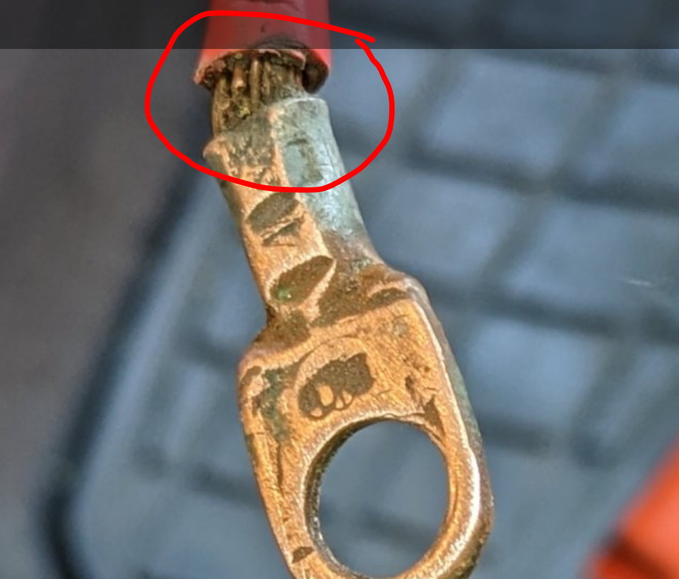

I tested and clean battery connection before, did it again. See attached pic. I got new battery last year, it has 12.46V now. I will charge it for a few hours at 2amp

This certainly doesn't look "great". Might not be the issue, but if you had the capability to cut back and reinstall a fresh lug, that might be an easy thing to try.
I'm not holding it in my hand and seeing it up close so I am not certain if I am looking at good ol' dirt, or some green (here and there)_ from copper oxide which is an inhibitor to current flow. I do note at least one (maybe 2) broken strands. Yes, not the end of the world, but how many more are broken?
Not trying to be a jerk here. Trying to help you.
