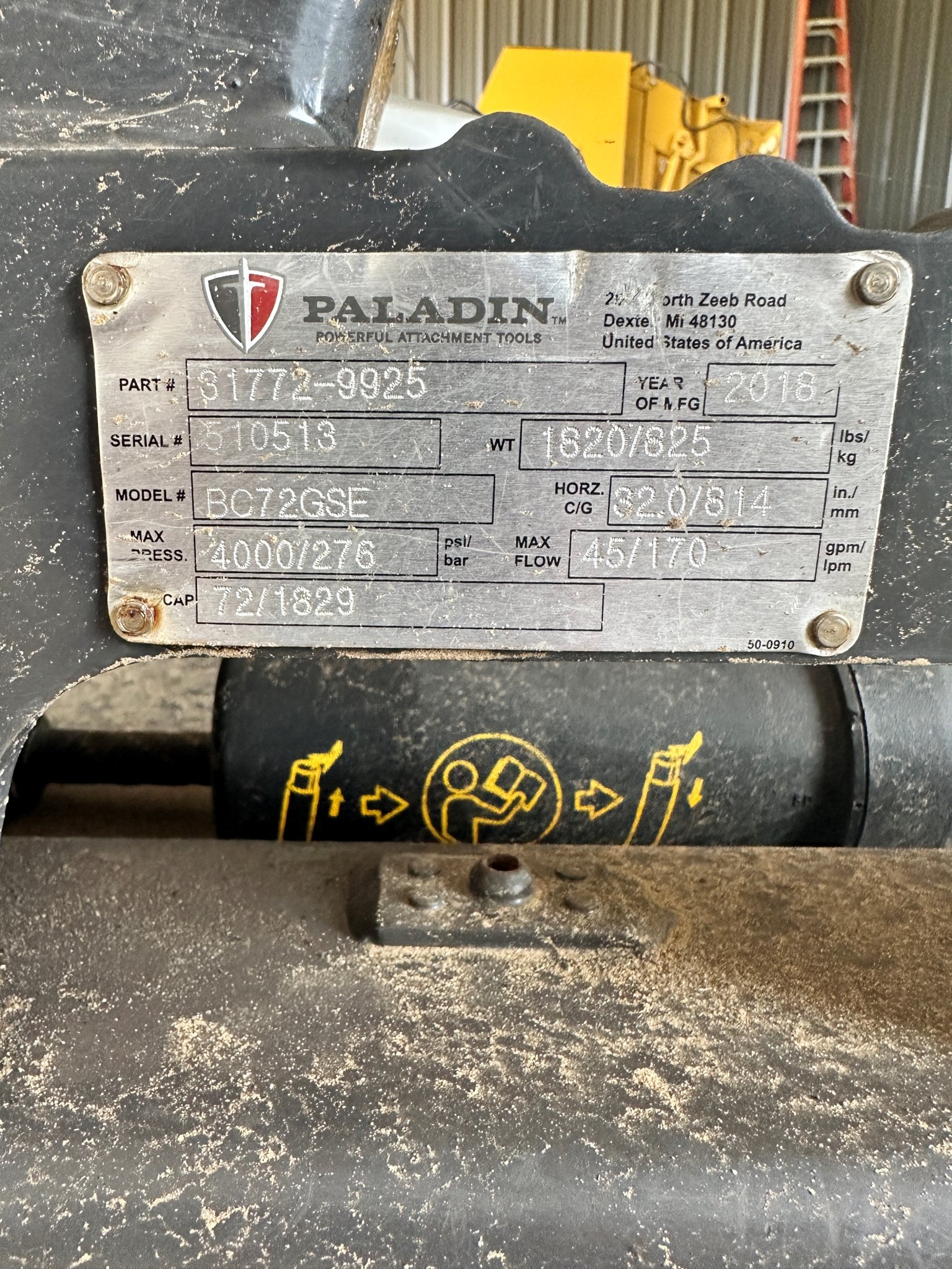

How many people on this thread have a Bradco/Paladin Ground Shark that led to these issues. I’m threatening to sue them for mislabeling their machines. The labeling of their serial number on my machine shows that it is capable of 4000 psi and up to 45 gpm; however, the 72GSE REALLY only allows for up to 34 gpm and around 3500 psi. This caused a relief cartridge valve on the brush cutter to shatter, pushing metal shavings through my SVL 97-2 and now neither Kubota warranty nor insurance won’t cover the $12,300 repair I’ve been quoted to replace the entire control valve inside of the SVL 97-2. I think we may have a class action…please respond or pm/email me directly if you think this is something that you have going on! I was trying to get this resolved for myself, but now that I see similar issues here, it sounds like we all have problems that Paladin/Bradco may have caused. image002.jpeg
