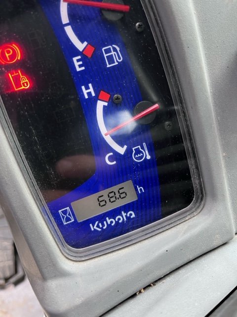

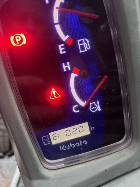

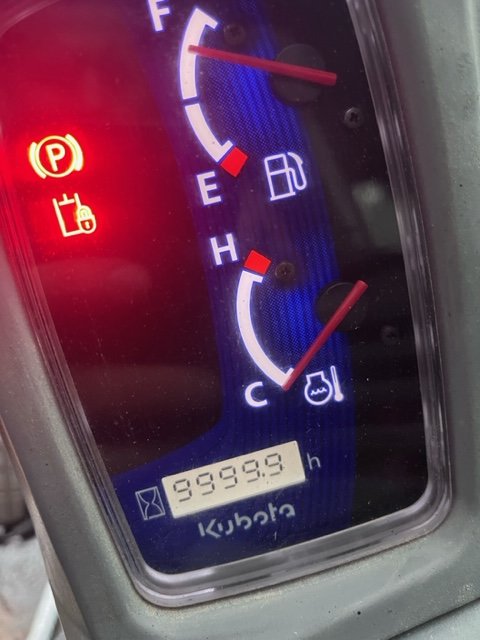

I have a 2017 SVL 95 that has 740 ish hours. I used on a job for a few hours and parked it while cleaning up a few days ago. I went to load machine on trailer and noticed the hour meter was at 9999.9 hours and upon starting and unlocking hydraulics the machine threw a E:020 code. the machine will not move and rpm wont change. Loader arms and bucket moves. After checking fuses and generally looking around the machine for 15 minutes the machine started and hour meter was back to normal hours and no code was present. Got in the machine today and noticed the hour meter was at 68.6 hours but functioned normally. Parked it to start cleaning and upon starting it I again had 9999.9 hours and a E:020 code. Any help would be great! I have found is the code definition ( E: 020. Electronic Travel Torque. Management System OR E:020. Anti-stall solenoid error). Anyone ever had this issue and knows what to do!? thanks for your help

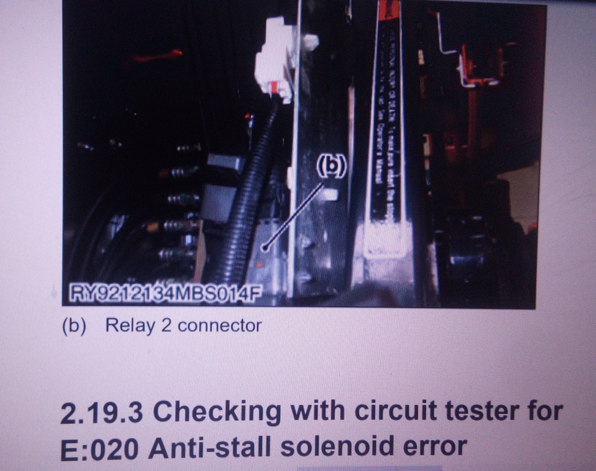

I have check you the solenoid connector, solenoid pins, and main connector and did not find corrosion at all. I checks ohms of the solenoid and compared it to the other ones with the same part number and they all were the same ohms at 3.8ohms. I did switch the anti-stall solenoid with another to see if the code changes. I will post how that turns out. the thing I don't get is the hour meter reading wrong. it when to 0.2 hours then back to 68.6 after a lot of key cycles. but has not returned to 740 hours like the machine has...

yea i figured that was coming. where did you get the info for troubleshooting thst code? is that the workshop manual?
