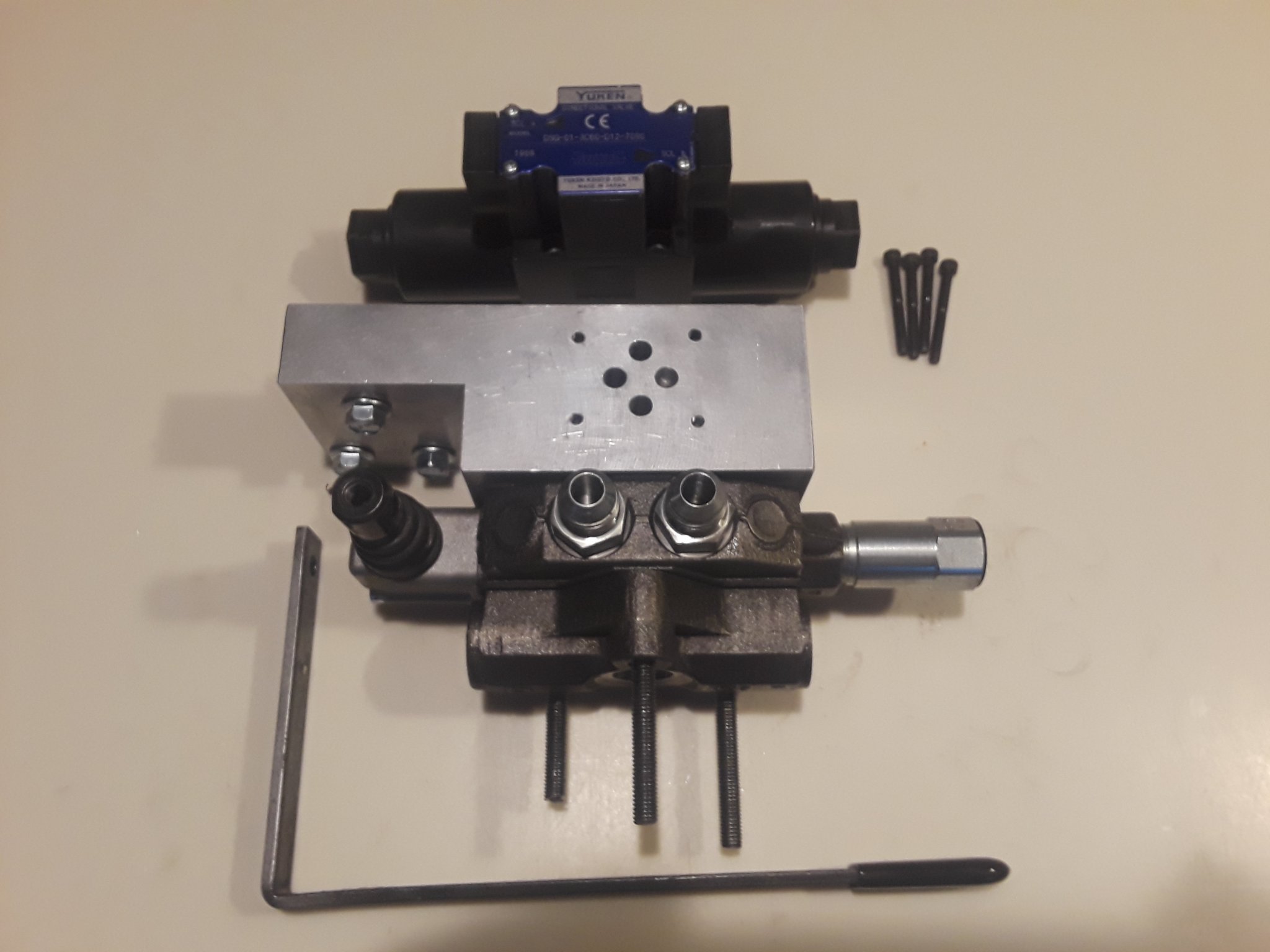

My thoughts exactly. I have a bunch of 1/4" and 3/8" couplers around from my cubs and yanmar. (Little bit bigger then the cubs) so that was pretty much my though for quick connect size. This pictures you have posted above of your outlets looks great, I had actually thought about doing something similar, but finding a small enough valve with power beyond to continue to power the 3point seems to be the hard part. Ideally I'd like 3 remotes, but could live with 2. I have a electric diverter valve up front for the grapple, but that just sends the bucket function to the front remote. Not quite sure what to do about the rear for a clean install.
6,959
3,353
Finding a valve should not be a problem. Here are a couple that I have used in the past.
The sectionals that I am using on the L3901 are very nice valves. They let you mix and match spool types and can be expanded or modified later but are more expensive. Three DA work sections with inlet and outlet covers is a bit north of $400.

Hay old timer your valve assembly shows 2 hose conections / Yet you have 8 ports on your back panel i'm confussed how dose that work ???? Not being a wise ass just missing something???
6,959
3,353
You are looking at the prototype. There will ultimately be three of those sectionals under the seat - that is six of the outlets. The other two are constant flow for my log splitter. They are turned on/off by a selector valve on the right side. And of course two more up front for the third function valve.
