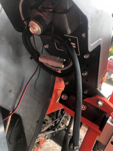

My challenge was the wiring. The wiring harness from the stick and valve is considerable and I don't see a great place to tuck it all away. I zip tied it all together and tucked it up under the housing for the loader stick. Clearly not factory but I'm not sure how else it can be done. It's acceptable and I assume all kits will face the same challenge.
Now to get a hot wire and ground? The instruction had me hooking directly to the battery, I want it switched on with the ignition. I looked behind the fuse panel and at the rear lights. Kubota does a great job of tucking all the wiring away and securing it out of sight. I was not comfortable tearing things apart to find an entry point. I ended up going to the battery and found a nice path following the existing wiring through the engine compartment. The supplied blade fuse holder looked weak so I replaced it with an HD one I had on hand.
Its now hot all of the time ( I pulled the fuse ). I have ordered an in-line switch for the line. This will be my solution vs wiring it in post ignition unless I can figure out a good way in.

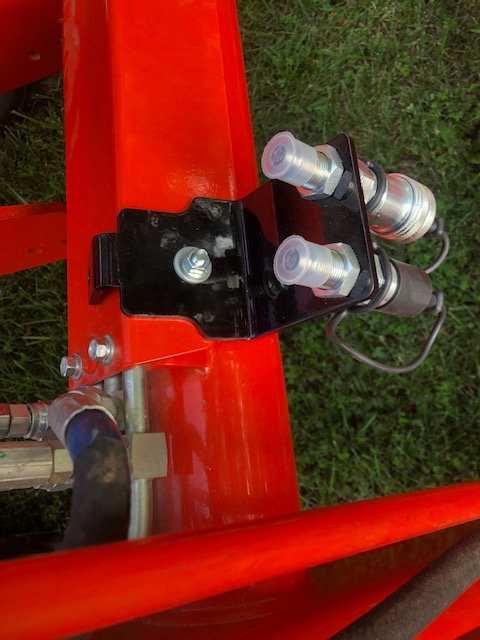

Up front, the mounting bracket did not fit anywhere on my cross bar. They did tell me at order modification would be necessary and they were correct. I'll have to figure this out ( looking at options ). Summit has a u-bolt option which should work.

Just to put a wrap on this job. After pondering a while, I decided to drill a hole in the cross beam line cover to attach the bracket up front. I put in a stout bolt and I believe its good for the long haul.
I hooked up the lines and blamo! I have a functional grapple. My first job was to move a log to the burn pile. I'm going to get a lot of use out of this tool.
If I had to install another, it's an hour job. The toughest part for me is the wiring. Many ways to go and none of them real easy. The in the instruction have a direct wire to the battery which I was a little uncomfortable with.
I do recommend the Summit Kit. Fast shipping, fair price, good support ( they answer the phone! ). They told me up front I'd have to figure out a mod for the front bracket. Here it is. Hope this helps someone down the road.
