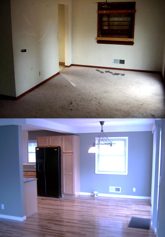

We bought this house just about 2 years ago. The PO had stained the oak hardwood black. When we first looked at it, it looked pretty cool. Then we moved in with 2 dogs. Within a month my wife was on the warpath to have them redone to the natural state. In addition, for whatever reason, there was carpet in the first floor family room. It cost us almost $9000 and we had to move into a hotel for 5 days but the outcome was awesome. Here is what the 'wood flooring doctor' did on our 1st floor:
Scope of Work:
- Hanging Plastic to minimize dust spread.
- Sanding Floors 1552sqft.
- Screen floors after sanding.
- Sand and refinish Stairs. This does not include the risers or stringers.
- Remove carpet and Install 300Sqft of red oak 2 1/4 clear 1
- Vacuum Floors to remove dust from the surface before finish is applied.
- Using a tack cloth on the floors between each coat of finish to achieve a clean surface.
- Loba Water Base Finish 2k 3 Coats.
- Second Coat will be applied on the same day of the First Coat.
- Screen Second Coat 24hr later so it can be ready for the 3rd and final Coat.
- Manufacturers Specs / light use after 24 hours, fully cured after only 5 days. Allow to dry for 5 days before replacing rugs. NOTE: Drying time will be increased by high humidity, low temperature.
- No Stain will be applied.
- Natural wood Finish.
- Sheen / Satin (Low Shine)
The new oak abutted existing in 2 areas - a perfect match. The guy, Felix, was great to deal with. I stopped over a couple days to see what was going on. It's a crappy job to do - what a mess you can make.

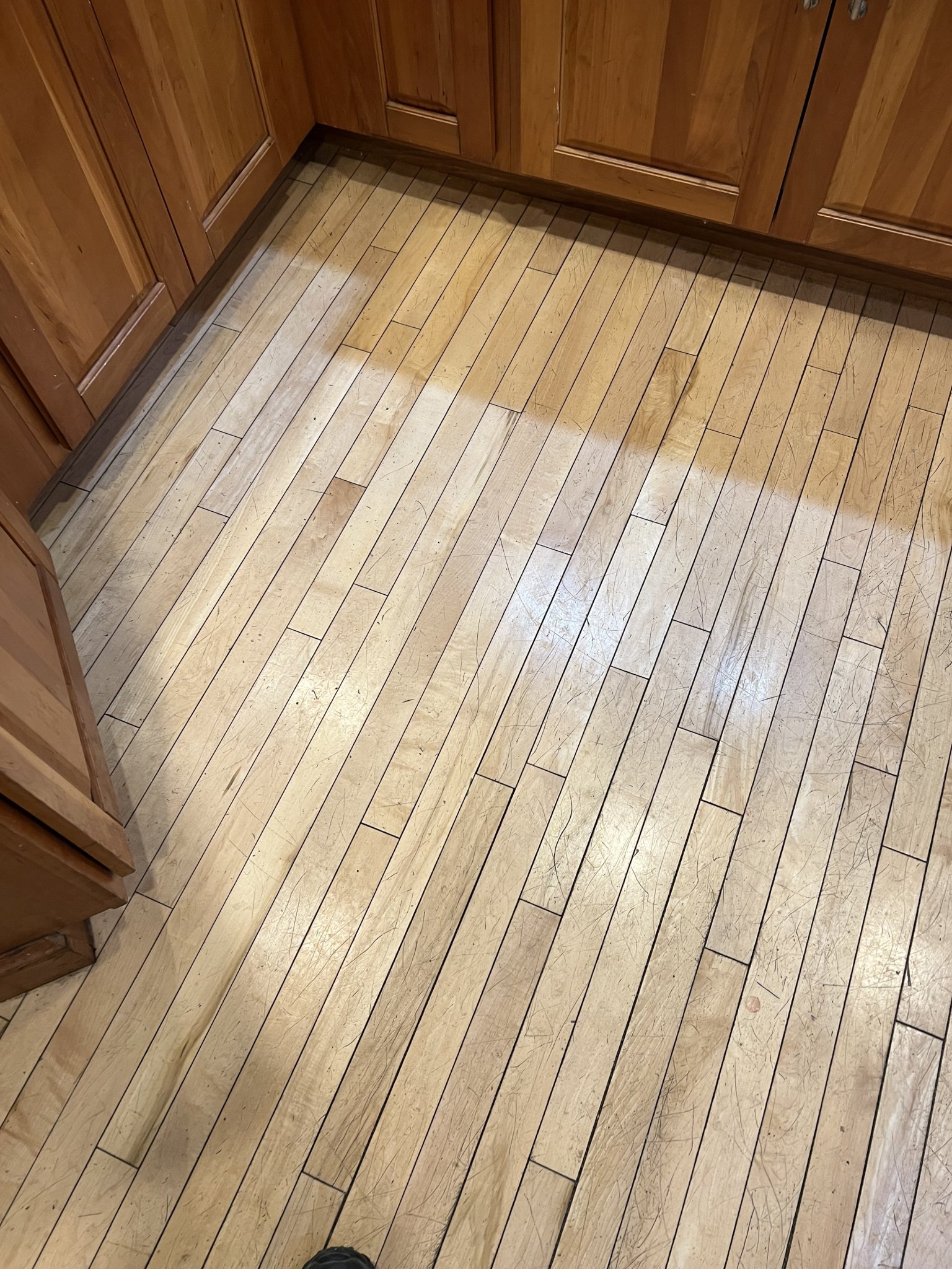

Years ago we redid our kitchen with a new pre-finished maple floor and had oak in the adjoining living/dining room refinished.
The maple kitchen floor has taken a beating over the years with 3 kids and 4 large dogs….plus me and the Mrs.
Far from pristine, but I love it.
Given another opportunity, I would have done hickory, and a much more “rustic” grade. Hides blemishes better.
Much harder than maple.
Adjoining room was oak original to the house (1950-ish) and refinished at the same time. Professionally done with 3 coats of poly.

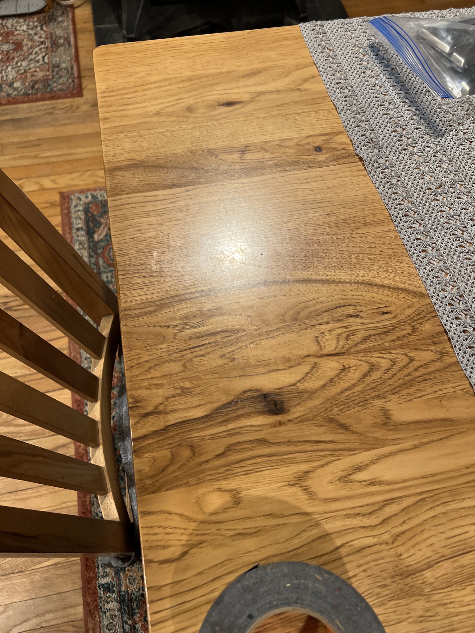

Just an aside our dining table is hickory. Kitchen cabinets are cherry.

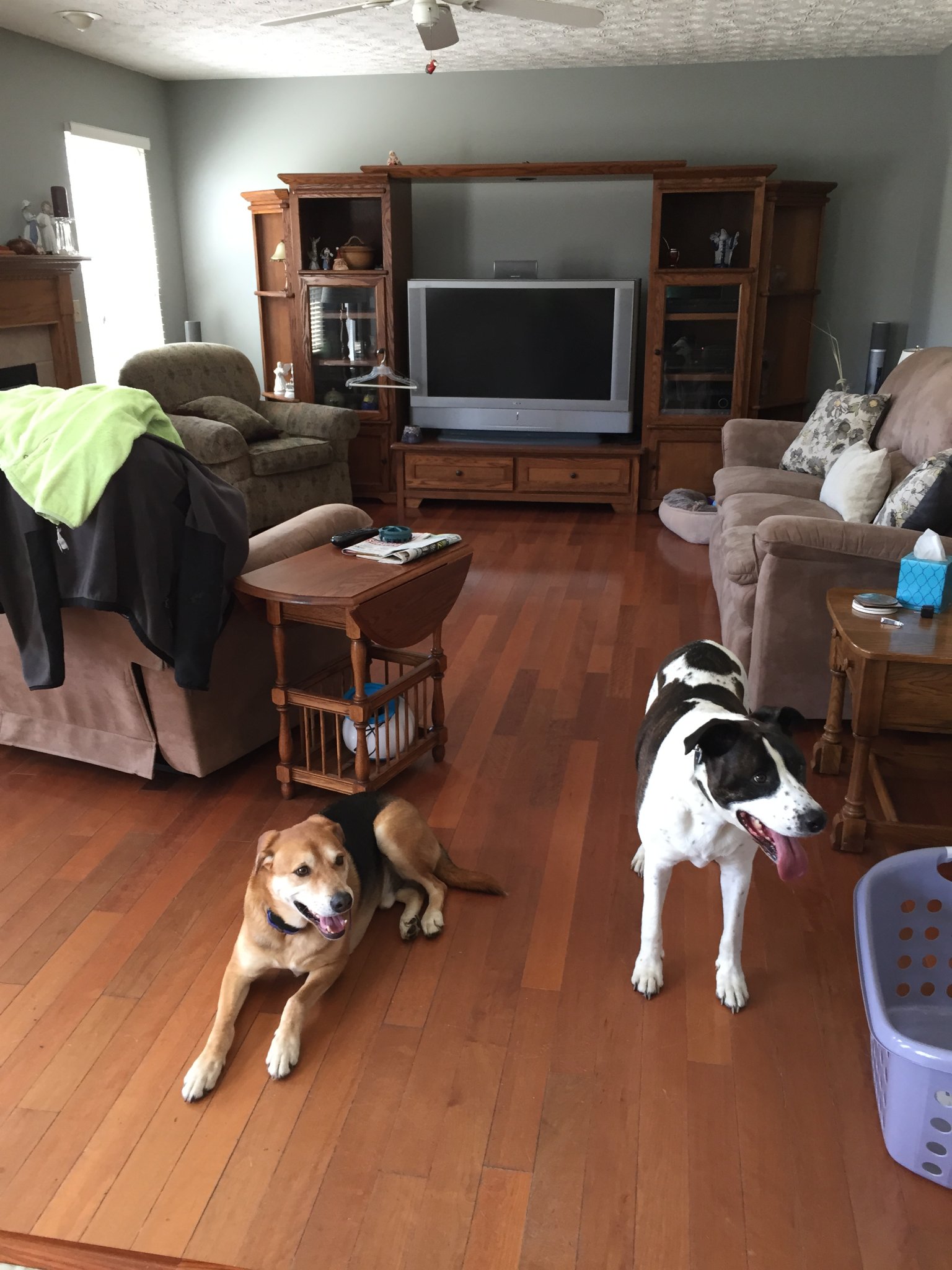

We did a Brazilian Cherry pre finished floor in our old house. Good because you can sand it and refinish. Dog nails continuously left marks in the floor. Other than that the durability of the finish was good. Lumber Liquidators. For my office I did a wood laminate with the top being a hickory. Great finish, cost effective and easy to install. Cuts like wood because it is. No floor stapler or glues. IMG_0125.jpeg
I don’t have a photo of my office floor. Will be doing the wood laminate floor in our MBR room when I pull the carpet this spring.
The rest of our house is laminate. Holds up good to dogs IMG_3890.jpeg The only area we have issues with are where my office chair rolls. Need a floor protector. I’d need this for any floor though.
If I could get the same flooring as we have in the main house , I’d probably do that in the MBR but it is almost 3x the cost of wood laminate since it has to be shipped from AZ.
