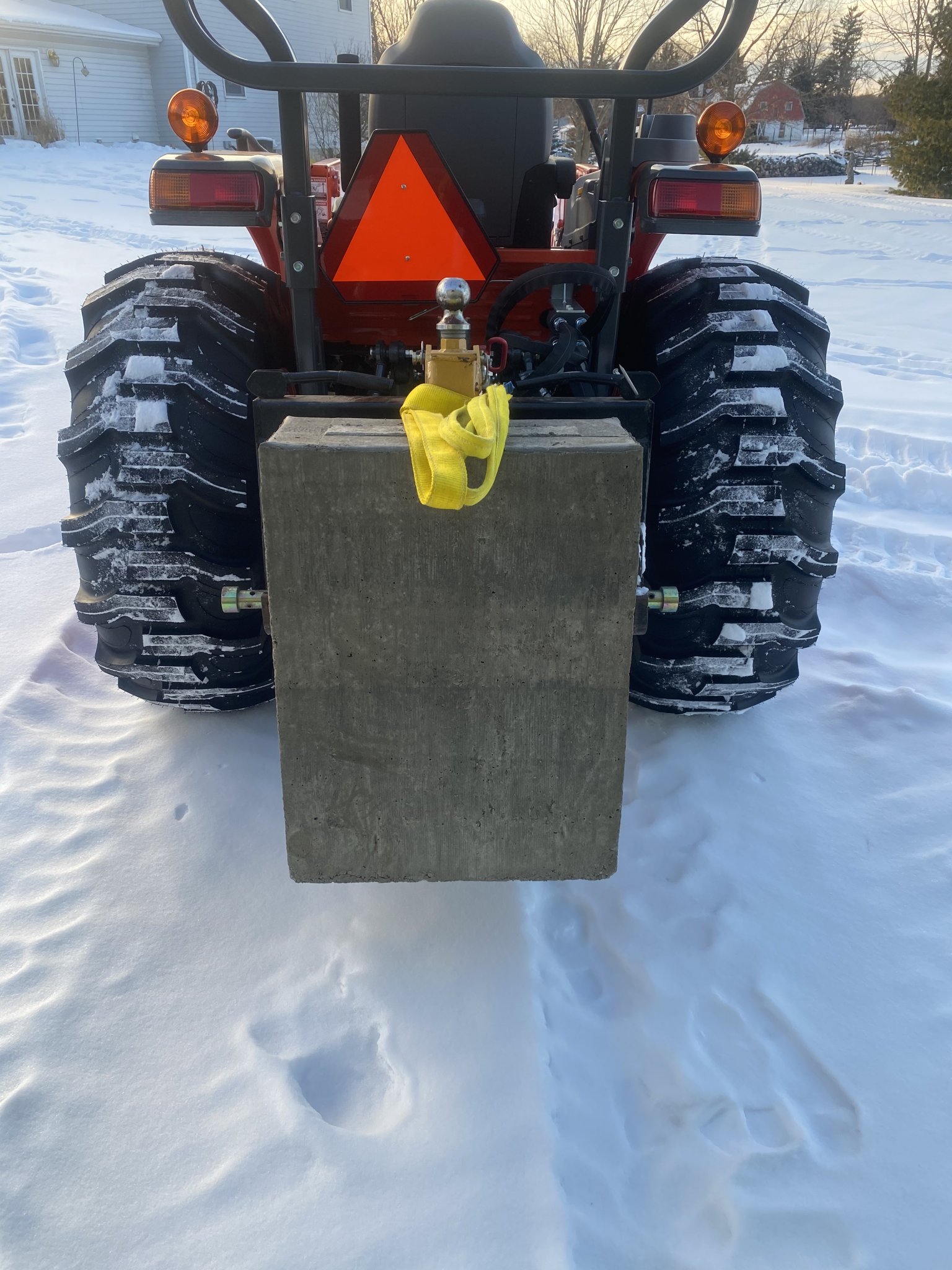

Now the wait.....
16 bags of 60# mix with some 1/2” rebar I had laying around wrapped around my trailer mover to keep it quick hitch compatible.

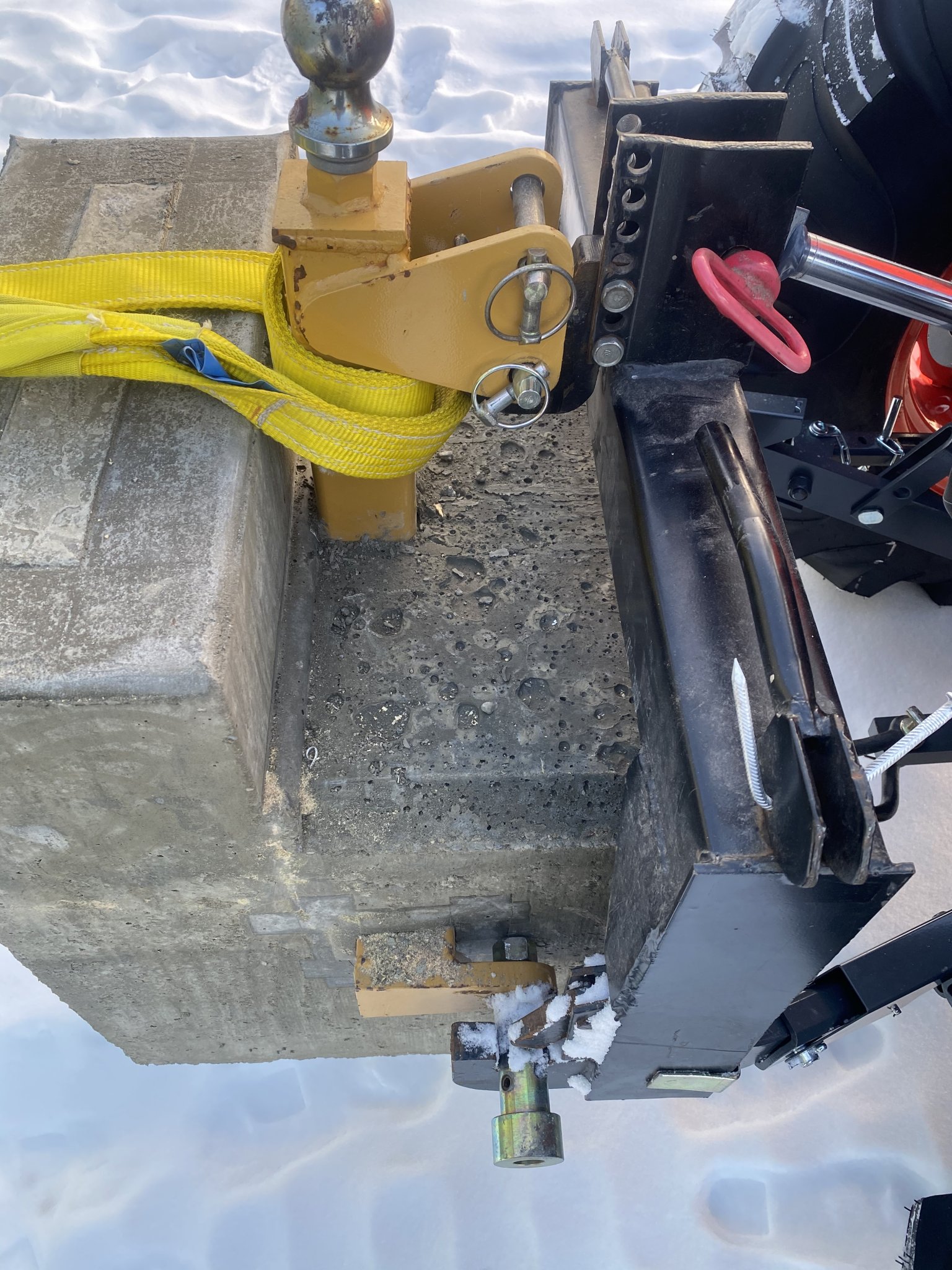

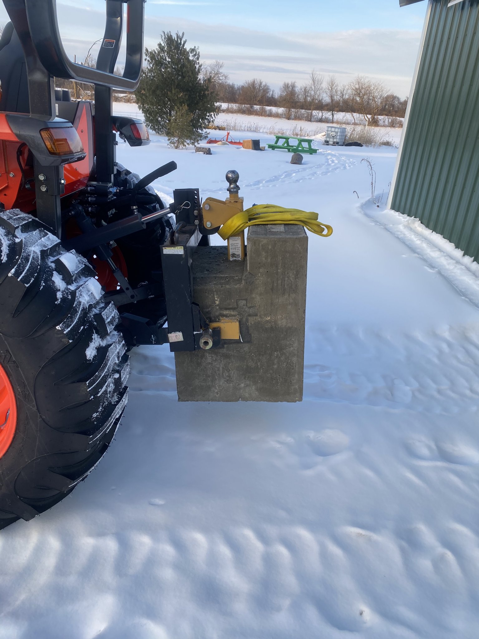

I’ve been a bit concerned about the curing. It’s been single digits here for awhile and was in the low teens the day I poured it. I did keep a heater on in the garage for the first 24 hours to keep it from freezing and the garage is insulated. It’s been out of the forms since Tuesday and today is the first time I’ve touched it to move since the pour.
So far so good and I’m pleased with the outcome. All of my measurements were spot on and the only thing I had to do was take about an inch off the threaded end of the lower pins so they would clear the concrete.
Tractor picked it up like it wasn’t there.

You'll find that concrete is giving off quite a bit of heat as it cures. The Calcium Chloride in most concrete mixes helps warm the concrete to make it set faster. Calcium Chloride reacts with water and creates heat during the reaction. If you don't see any cracks yet, you're not likely to in that small volume. Concrete sets within 24 hours, and cures within 48. When the Hoover Dam was being built, ammonia was pumped through copper pipes that were embedded in the concrete for cooling to prevent the water content from flashing to steam, and creating an explosion. After curing, the pipes were abandoned.
What got my attention was the sling around the top hitch. I really hope you're not using that for pulling. A good friend of mine was pulling a stump with a tractor with a chain over the top of a 3 point hitch adapter. His foot slipped off the clutch, and in his words "I looked around and saw my brains leaking all over the ground." A great guy, and miraculously, he survived the incident. But he will NEVER put anything pulling above the drawbar again.

Giving off heat is a direct relationship to the ambient air temp. Its imperative that concrete be protected from freezing until it reaches a strength of 500psi, or thereabouts. I can assure you, because I checked, there was no discernable heat coming off my pour compared to the heat I could feel coming from the concrete deck we had installed around our pool when the ambient air temp was around 60. That was fairly warm to the touch. Not to say it wasnt generating heat, that's a byproduct of the chemical reaction. But it wasn't enough to keep it from freezing.
48 hours is under ideal conditions and is suitable for LIGHT use. Think sidewalk or patio. A 1000 pound block which is supported at only 3 points, I would not consider "light" use.
Ive seen the documentary on the Hoover damn and read a few articles, that was a fascinating project.
The sling was used to rotate the block so I could back into it and pick it up. That's simply where it ended up when I was done using it.
Good. Had me a little concerned.
I live in the South for many reasons. Concrete freezing before it can set is just a minor one. I was 21 before I ever went farther north than Huntsville. When I did, I went straight to upstate NY, Schenectady/Rotterdam, to be exact, on Labor Day weekend in 1982. Folks up there are different, and seem to get offended if you just say hi to them on the side walk. I won't call 'em mean, just different. Maybe it was their accent that embarrassed them or somethin?
What I meant by set after 48 is that it's gonna be damn hard to get it back out if something's wrong. 'Green' concrete (day-old) is pretty easy to break up and re-do if necessary. After 2 days, you're probably going to tear some stuff up.
