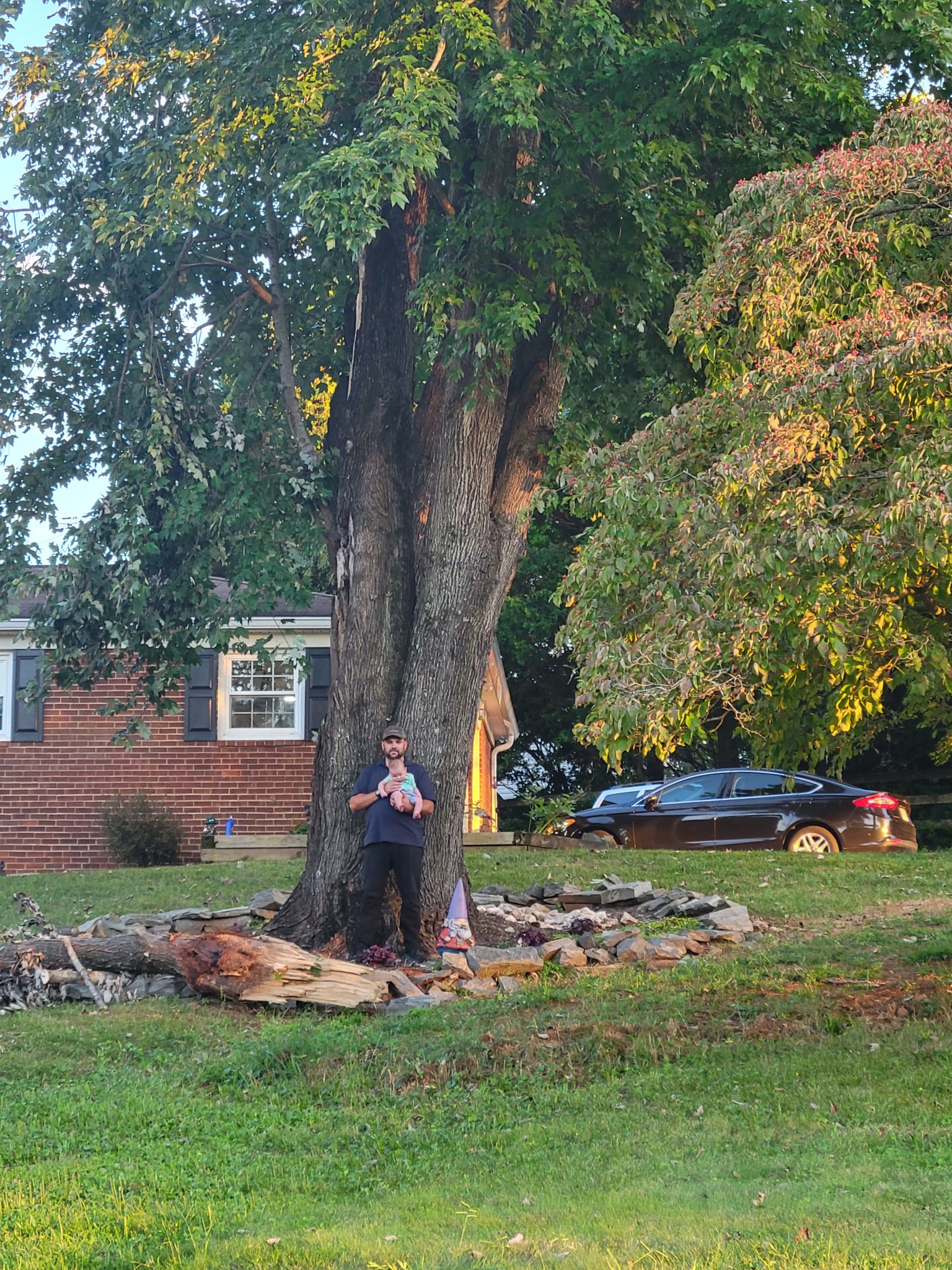

When we bought our little 5 acre spot the previous owner had done some crazy landscaping and then unfortunately let it go as his health declined. We've been tidying it up and making it work for us over the past few years. A year and half ago a large mapple got to the point where it was dangerous over the house and had to be taken down. The stump has been there since as it was in the middle of planter formed up with rocks and we thought about carving a bench or something into what was left but the wife has now decided she wants it all taken up and turned back to grass for now.

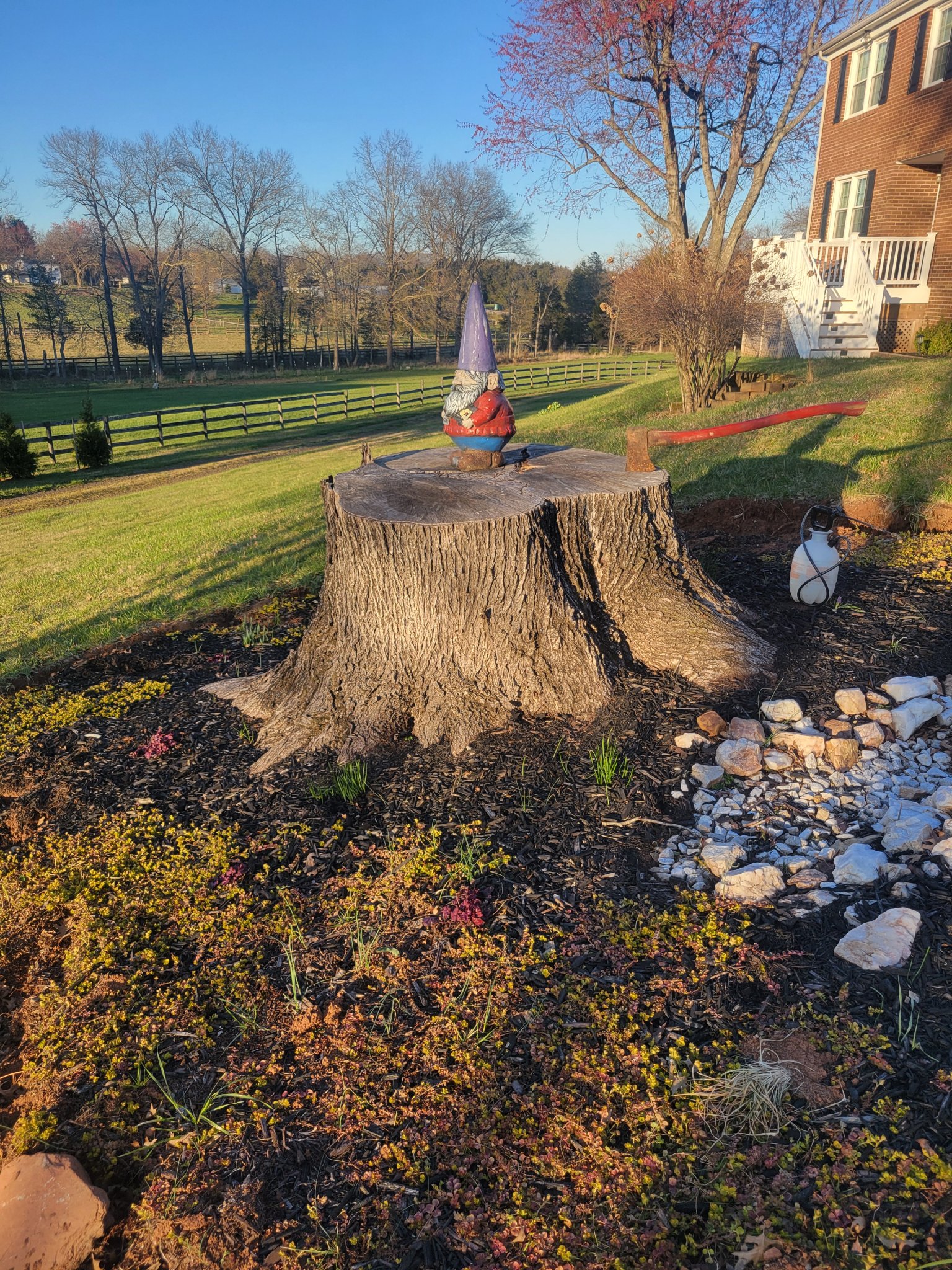

All that to get to my real question. If you wanted to get rid of the large stump and want grass to grow (or maybe a different tree/landscape plan) what would be my best bet? Do I need to rent an excavator and dig it up, cut it low and grind it, burn it...? It's large, everybit of 48"+ across. I'm already moving the stones to the back of the property which will now undoubtedly become a snake garden, but I'll deal with that later. I'll get a picture this evening to show what I'm working with.

Hire someone with a stump grinder, remove all the grindings from the hole, fill with soil. You'll need to get all the stones/foreign objects out 1st.

I have done every version of this game before Kubota & after. Just one stump, that big & critical location, I concur - would get it ground & be done.
FWIW I have hacked, cut with an old CS blade, burned, drilled and waited to rot etc.
It can be done but not fun!

If you want grass to grow there, removing grindings is a must. Decomposing grindings generate heat, and the ground will sink when they break down. Professional arborist 30+ years, I've done a few of these.

Thanks everyone for the insight. I'll cut it down low and have someone come grind it up and then move the chips down to the run in barn to help with the mud mitigation.

Not a lot of money. If you cut it to half foot above grade figure 4 hours at most to grind it out. Probably closer to two. Since most guys dont want a two hour job amd will hit you for additional hours I would be looking for other stumps or roots that need to go.

That's a monsterous stump grinder! I have the numbers for a few guys in our area I'm going to get the top cut down and reach out for some quotes.

You were not kidding! I would also cut as low as possible.
Picture and location confirm the grind choice. IF you had it dug, that would be a MONSTER crater, disruption, take large equipment & time, THEN disposal and leveling (read big $$). As others have said, the area will sink over time, but tossing on more fill is no big deal
