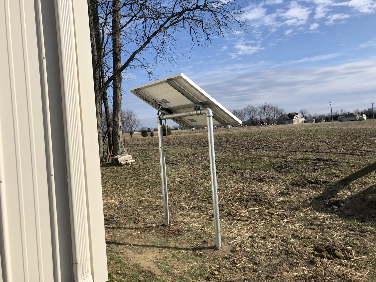

Allow me to get this thread back on track for at least 1 post.
I used a couple pieces of strut to mount the solar panels for my barn. They are attached to saddle pieces made from square tubing that are clamped to the 2” pipe frame with U-bolts. Loosening 4 nuts allows the angle of the panels to be adjusted in the spring and fall.
