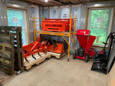

Gave it my best shot, used the loader and a friend to get the mower deck on the scaffolding - not sure how I'm gonna get it off, but I'll cross that bridge when spring comes.
Did learn that the mower deck was neglected quite a lot, scraped at least a pound of dried grass off the bottom and the belt is separating.. crazy for a 2 year old tractor, definitely showing that it all was stored outdoors.

getting it down will be EASY.....
by then, your new pallet fork attachment will have arrived !!!
ONLY a pound of grass ?? I've filled a 5G pail cleaning a 1 year old rider....
idea ?? can you put deck on the ground and the blower on the platform ??
If the platform is in the lowest position,can you easily get the blower on and off ?

It was enough to fill a 5 gallon bucket, maybe it was more than a pound, didn't actually weigh it, just assumed its weight (I know, assuming...).
As for the swap on the scaffolding, I'm sure I could put the scaffold at one of the lower settings, and have the rear PTO all the way up and simply slide the blower on, which is what I'll likely do come spring, which at that point, the mower deck will go on the tractor, so won't need it on the ground. I'm hoping the blower will be low enough to clear the power bagger while on the tractor, but also sticks out a lot less, so should shrink the footprint of the tractor. I will throw up another picture when spring comes, assuming that winter ever makes its way to Maine.

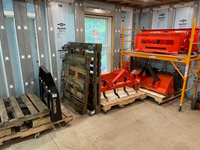

I bought a Harbor freight scaffold on sale and the rest are on pallets with the wheel from the harbor freight dollies as they were cheaper. Everything can roll around to get to different impliments. This is a standard 8ft basement. Just for tractor and impliments. View attachment 93788 View attachment 93785
I have the same scaffolding but a little taller roof line, so I get one more layer out of mine.
Fairly cheap, yet strong and effective solution.
You gotta go up, when you start running out of real estate.

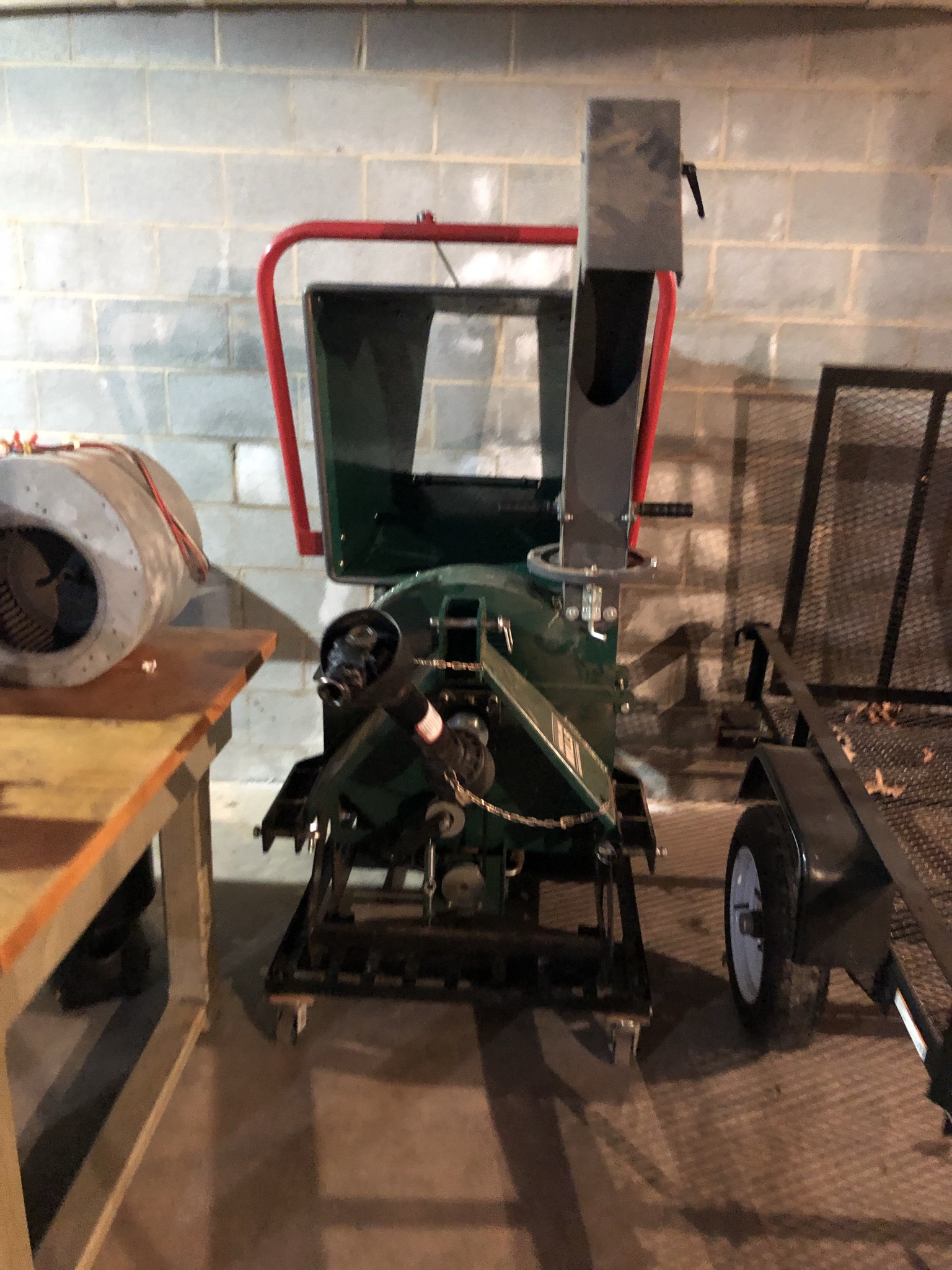

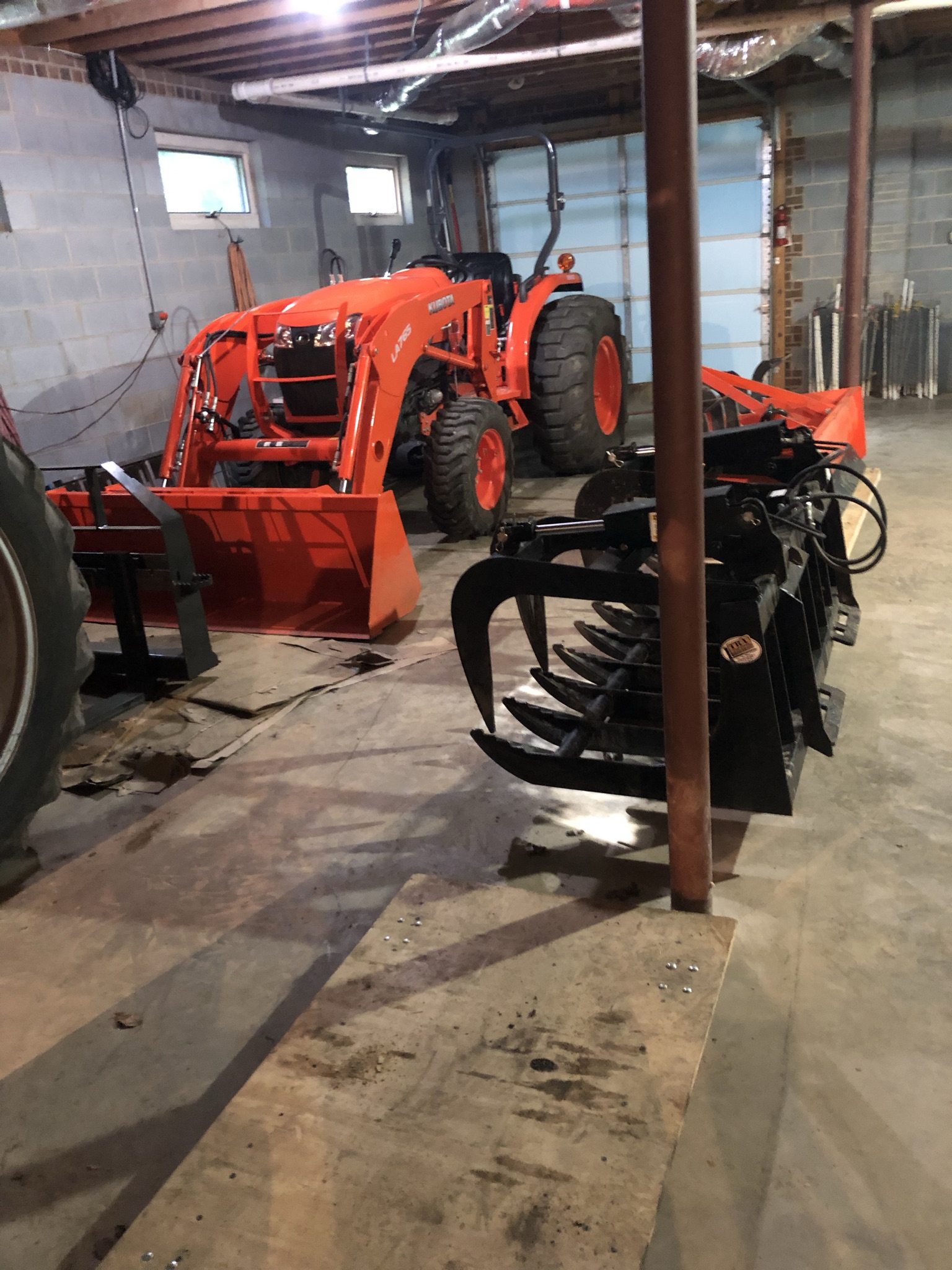

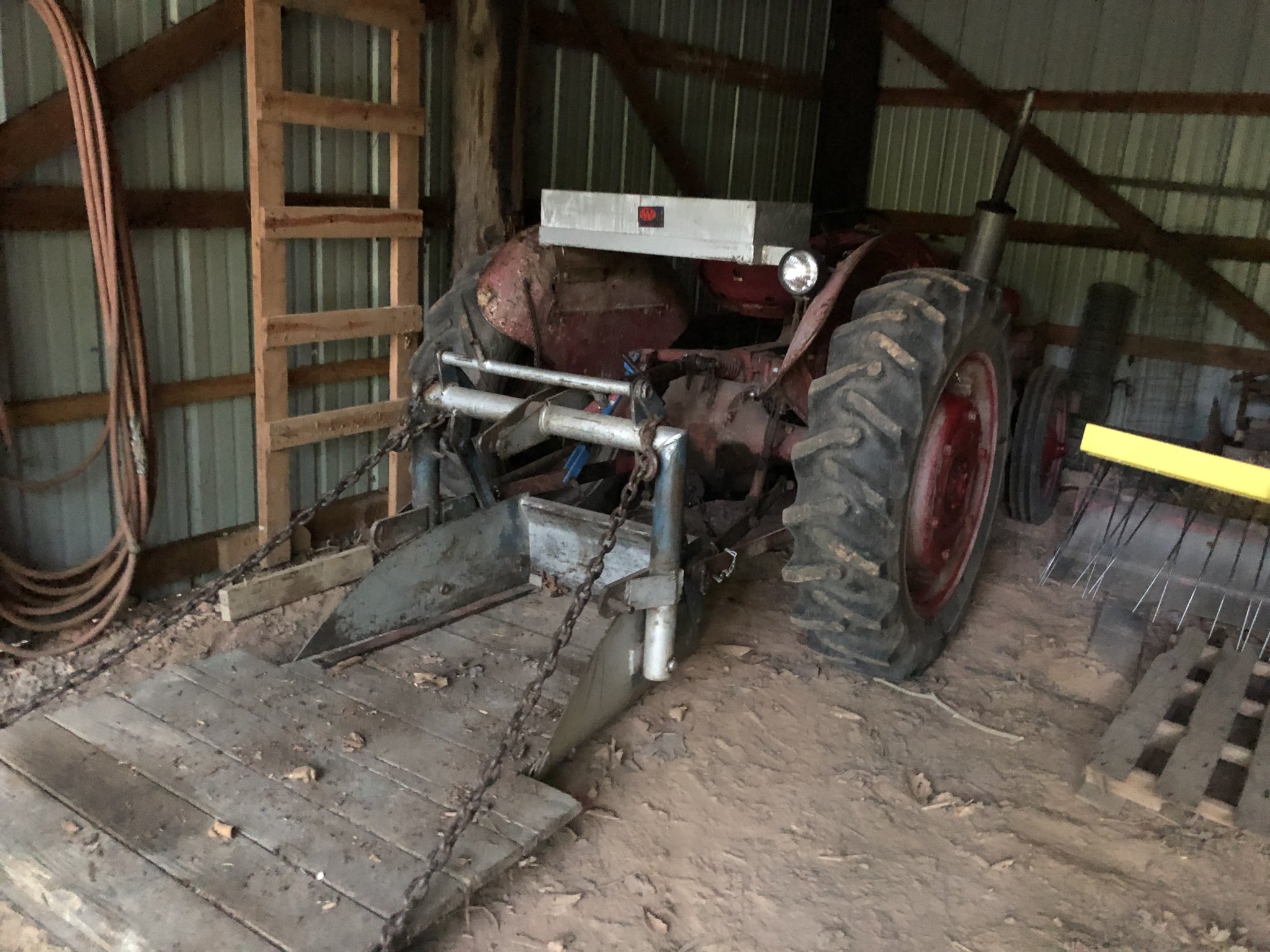

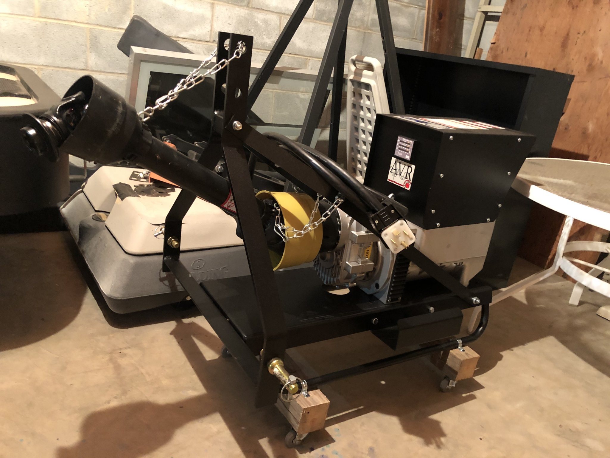

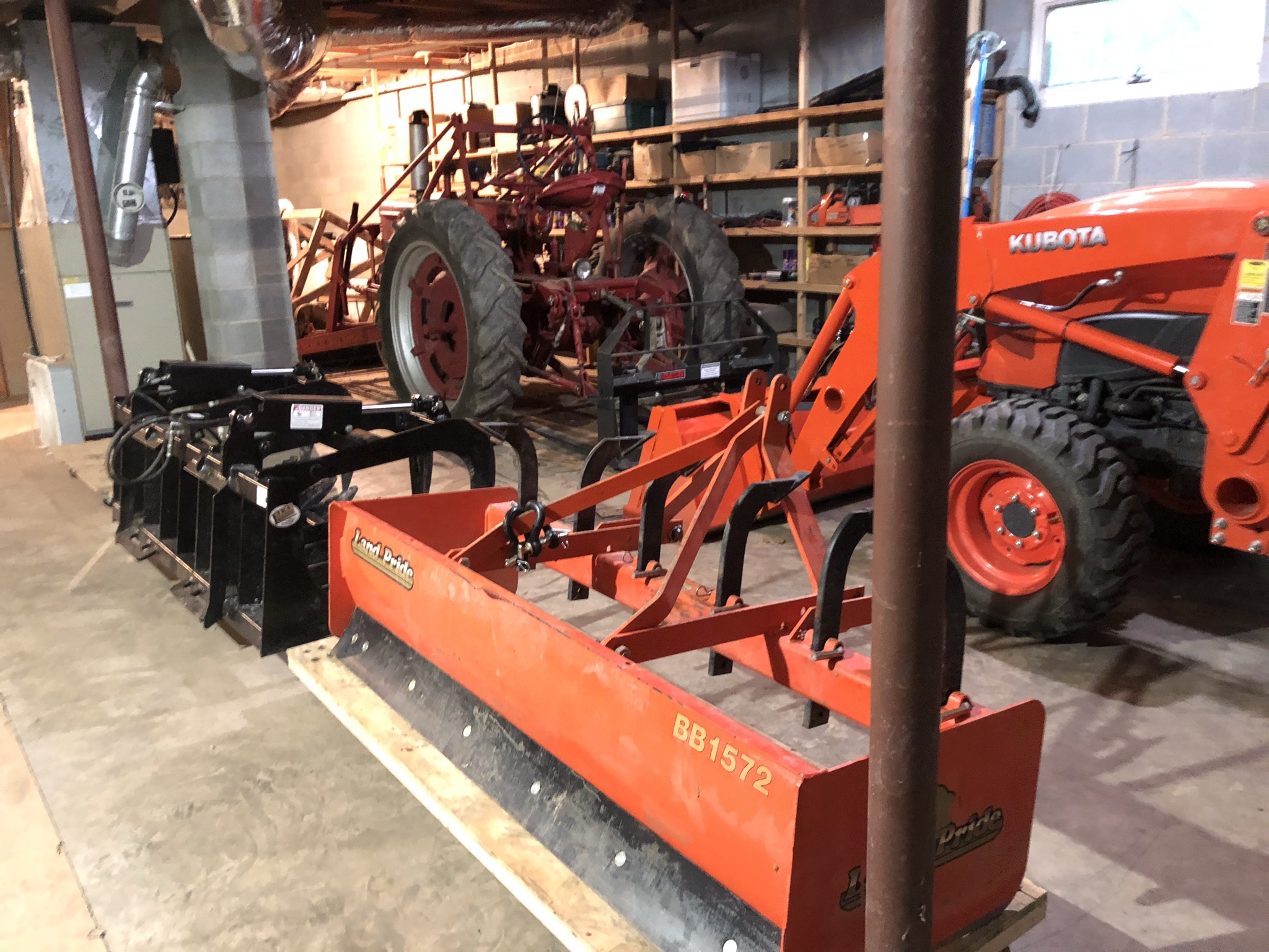

Couple of options:
If you have enough headroom I have seen some put up heavy shelving and stack implements two or three high using the forks on the tractor.
Personally, I keep most often used stuff on dollies to allow moving them around the floor. If I could only store them where the tractor set them down it would be much more restrictive and inefficient. Also allows easily moving them temporarily to free up floor space near the door by easily pushing them around if I need additional room to work on something. A few times I’ve also rolled several implements over by the door and pretty quickly forked them elsewhere for a few hours or days to free up floor space and then set them back in when done. Sitting on a dolly, they’re easily moved with forks. Steel caster wheels, plywood decks, and reasonable 2x subframes are quick and cost effective to put together.
I also have a few implements that aren’t often used and don’t benefit from climate control which stay in this dirt floored shed. (i.e. generator in climate control; leaf rake in shed). There’s no rolling or sliding that stuff around out there. Most is way too heavy for manhandling and caster wheels useless on dirt. Quite a bit less user friendly but relatively cheap storage. View attachment 93754 View attachment 93747 View attachment 93748 View attachment 93750 View attachment 93751
what is the implement on the farmall ? i too have the woodlandmills wood chipper WC68 great machine
The thing on the front is a trip bucket loader. The back is an aftermarket 3 point hitch with a trailer mover which doesn’t show very well in the picture. It kind of looks like the black thing is on the back of the Farmall but the black thing is the SSQA forks for the Kubota that are slid up under the back of the Farmall to minimize the floor space they occupy.
