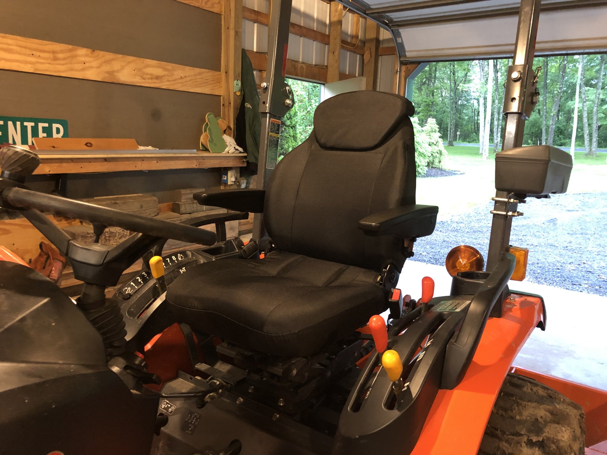

Get yourself two bolts (i'll look for the size) and tighten them down. Alternatively, you can buy the knobs that come on some BX series from your dealer. They thread into the front of the ROPS at the joint. You'll see a welded nut on the front side.
I can't remember which thread I sued but it was one of these two sizes....
ROPS Jamb bolts Thread size metric M10x1.5mm, M10x1.25
You can see them installed here (two shiny bolts).
Bingo.
I did much the same with my B3350.
Problem solved.

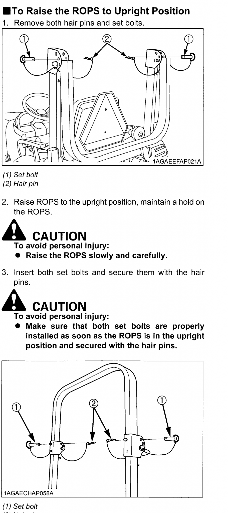

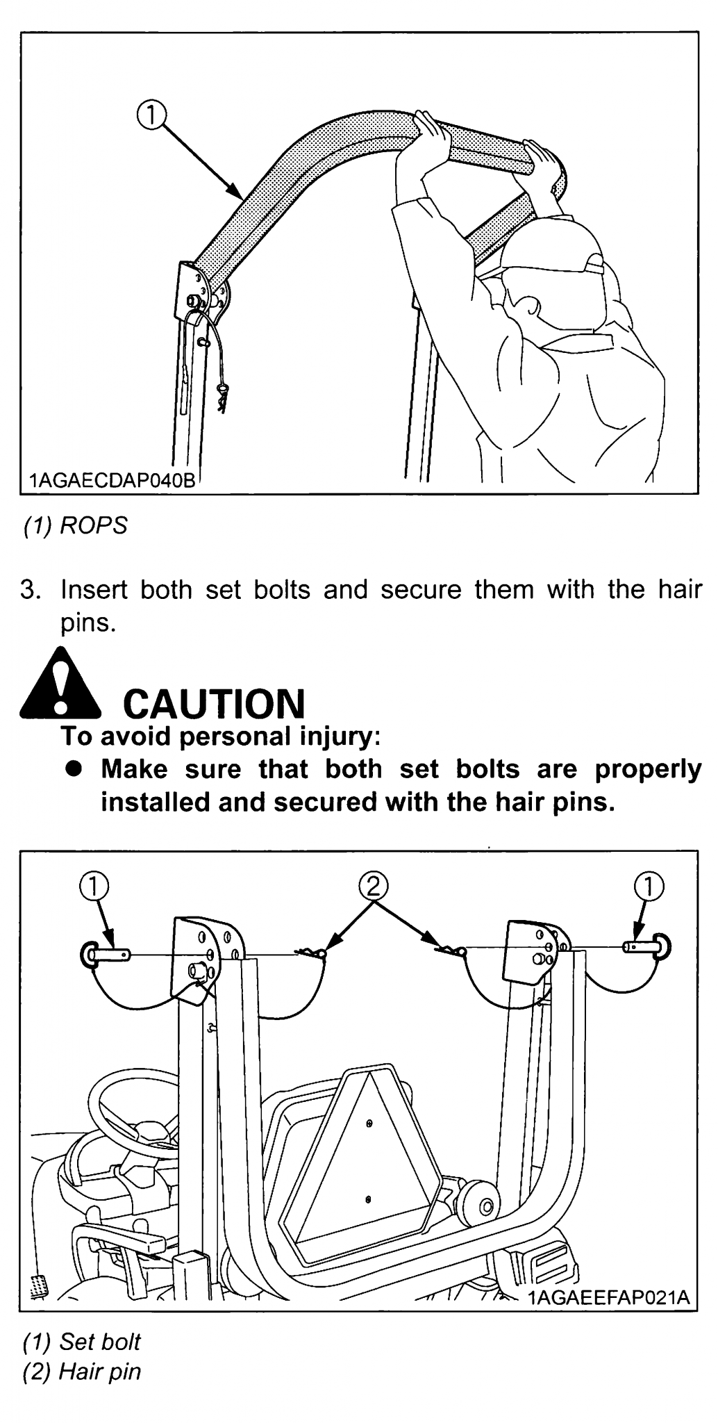

There are two drawings showing the proper use of the center hole, one of them is posted above.
There is this line you missed:
• Before proceeding to fold ROPS, check for any
possible interference with installed
implements and attachments.
If interference occurs, contact your KUBOTA
Dealer

Not clear as to what is shown. Are the middle holes to lock the bar in the fully down position?
It's working great with the top bar at 45 degrees. At a height to fully protect my head and low enough to clear doorways. It's great.
