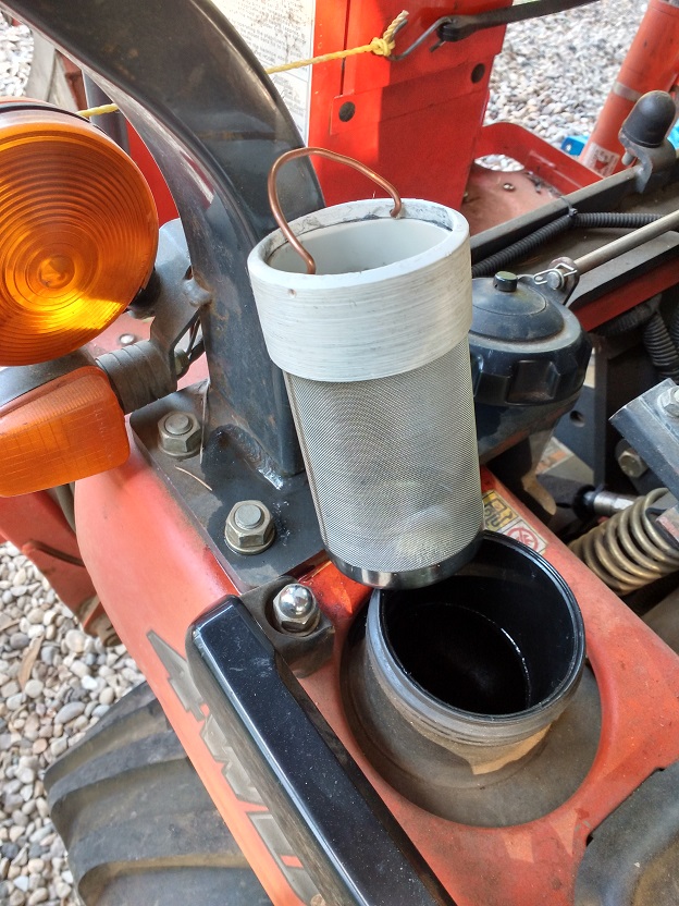

Hope your recovery goes well but I cannot help you with the step assist. However, if you get one of these, or something similar, you will not have to deal with fuel tank contamination from small items.

I will bite... where do you get these? I searched eBay and amazon, and nothing.

That particular one was custom made by me from some pvc pipe, and stainless steel tea strainer from Ebay. However, if you Google Fuel tank inlet strainer you will get plenty of hits, just need to select one that fits.

Thanks. Is that one sold by Filters fast of NC, I belive. I was thinig the #4 size would work. Slip over the neck and use large radiator clamp to gently hoid it in place. I assume toss after use??

Thanks. Great idea.

BTDT, I got my strainer from a $store. Supposed to be a stainless steel 'lint' strainer for a laundry tub. Just had to trim down the lip to get it to fit on the neck and get the cap back on. Best $2 I ever spent !
I like 07WN version, deeper,easier to fill

Makes a lot of sense. Wonder even if the filters used in showers or kitchen sinks would work. Appreciate the sensible idea.
