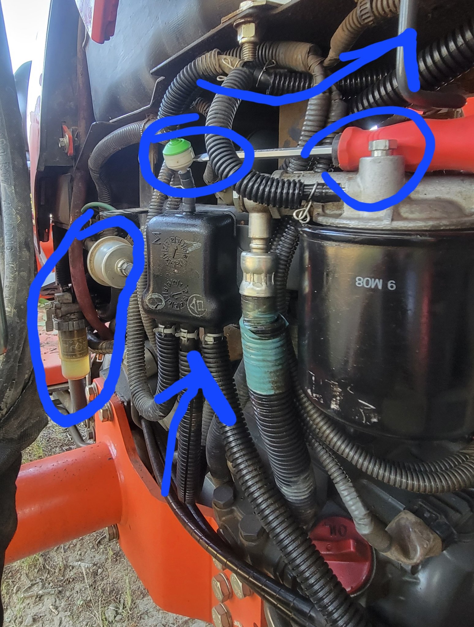

That's not a fuel filter it's a check valve (in blue) and it's for return fuel.
The black box below it is a reserve fuel tank (it's a system buffer).
The fuel filter is in RED
The water separator is in Green
And the low pressure lift pump is in Purple
You will need to replace the check valve that you poked a hole in before you run it any more!
without the check valve in place and working properly you risk serious damage to the entire high pressure fuel system!

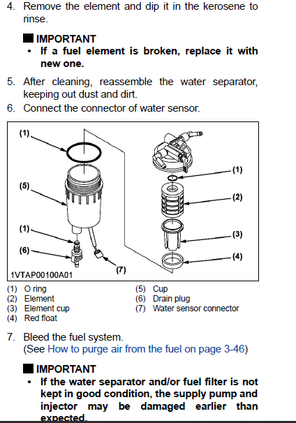

Follow the instructions from the WSM below to clean the separator, and change the fuel filter.

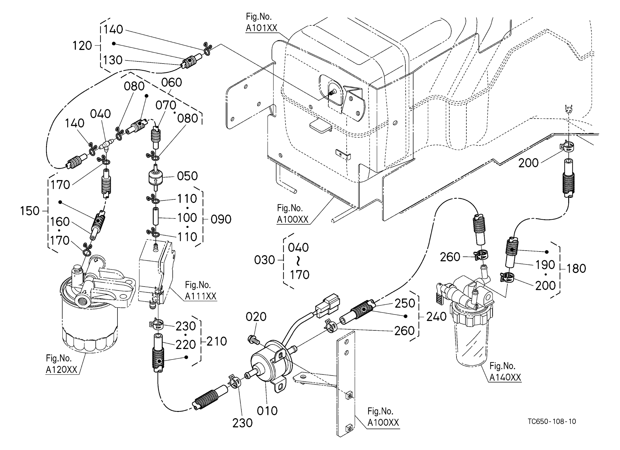

THANK YOU, THATS WHAT I HAVE BEEN TRYING TO FIND AND IS WHY I STOPPED BY THIS SITE, AGAIN THANK YOU...I went to the dealer to ask them about and of course they didn't have any idea of what it could be BUT I could bring the tractor down to them and then they can figure out what is going on...!!!!, you know it's all about the MONEY.... , But yea anyways that's also why I was there to get a fuel filter of which I have just installed it and still nothing it won't even start now, I shot some starting fluid in it it did start then die, shot again it died so I stopped I do t like using that stuff much, that's when I checked back in and seen all this wonderful diagrams on the fuel, so I'm fixing to do some line chasing hopefully there is a little e blockage....and nothing else, I will let you know , thanks.

none of the diagrams that you sent which have been very helpful finding purge plugs and lines, but you know it may be this model mx5200 that i have idk the diagrams look like what i got, I don't have or can't find 1st. The purge plug on the separator..?, now it does have two screw at the top I thought were L-n wrench heads but I can't find anything to fit them in metric or standard sizes...then I'm reading what you sent trying to follow each step till I come to my 2nd issue I cannot find or I don't this feeder pump knob...on drawing 57A01 I have looked all over, can you see it on that picture i sent..? Or tell me where it is, .
Your tractor has an electric fuel pump so you do not have the bleeder on the separater or the manual primer pump. Just turn the key switch to the ON position and use the 10mm headed bleeder on the filter head.

Follow up after replacing the fuel filter and the battery had a hole in it...?, the tractor is still stalling or dieing out I did get it to start yesterday ran for about 15 minutes boy I thought I done it THEN yeap it died stalled out still sounds like a fuel issue to me, I went to the dealer to replace that little Check valve see 1st. Picture it's the little green and white filter looking thing I the middle of the picture But they wanted $52 dollars ...!! I about fell over and walked out WITHOUT it, well I went to 3 auto part stores they had none in my little part of the world, so I got online searched and found all kinds ds of them running $8 - $25 dollars, But I'm trying to make sure they are compatible with the original one the one I'm looking g at says it's like a .2 bar or 200 Kia pressure that it takes to flow thru the thing and I don't know what the tractor runs I don't have a WSM only have the owners manual and they say nothing even about the check valve...?, any help help would be greatly appreciated , I have an attached photo of the air i think from the fuel filter that I got out I think.... still won't stay running again any help other then taking it to the dealer will be helpful, thank you....

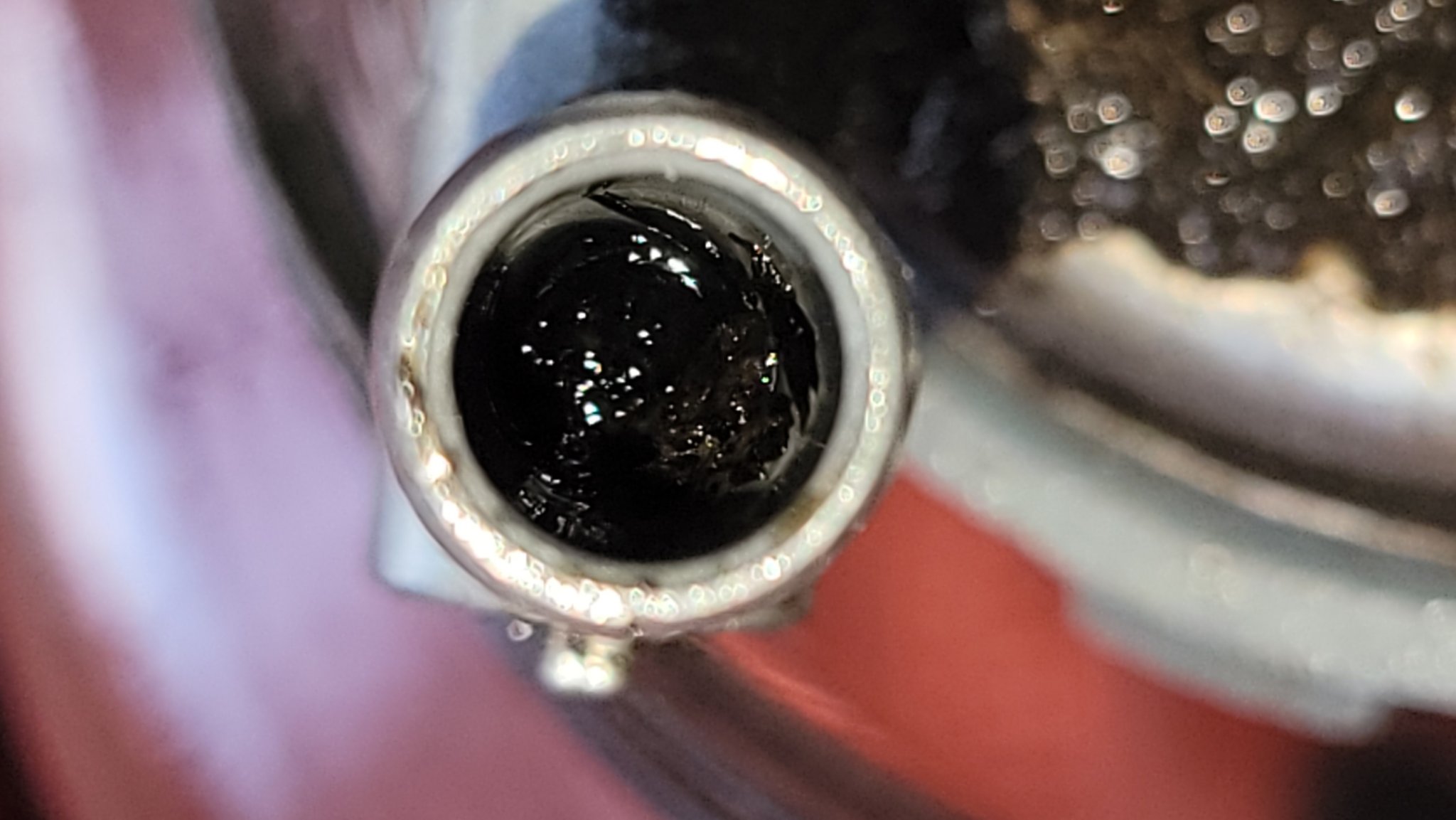

ok, well i did it...!?!, with the Help of you ALL, thank you for all the suggestions!, and the use of the WSM, that helped out alot, BUT what i found was that i was not getting any or enough fuel as you stated fuel should be gushing out of that bleeder port on the fuel filter, so i started back tracking down the fuel lines from the filter Again....i got to the water separator and noticed that there was no fuel coming out of the line from the fuel tank..??, so i took the air hose plugged up the fuel inlet at the cap on the tank with a rag and then blew out the line back up into the tank.....talk about FREE flowing fuel now man o man.....so i then drained the fuel from the tank into fuel cans using funnels with a screen strainer on them to catch what ever was in there, i found bugs...!!!, and you idk ow they got inn i only leave cap off long enough to fuel up.... but they were in there and got sucked in to the fuel lines, But i went ahead and tore that water separator back down and found bugs or bug parts in the fuel inlet from the tank into water separator it was a pain in the you how to get out..!! but it happened i got it all cleaned out put back together, went ahead a bled the fuel line again ..... started ole orange up and its been RUNNING GOOD ever since then, SO if you are have this type of issue make sure you double check them fuel lines, inlets and tanks for BUGS or BUG PARTS........
