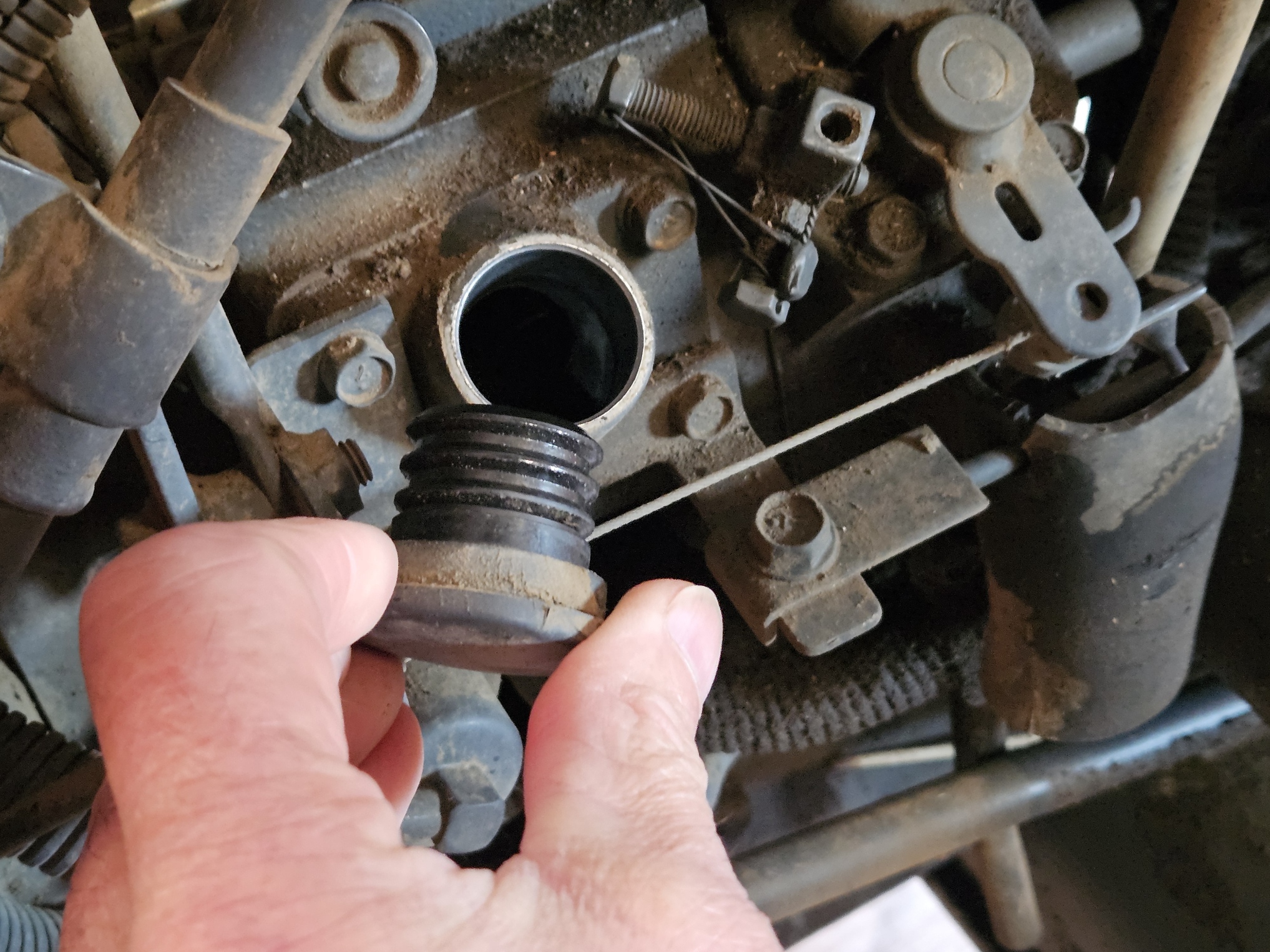

Thank you was having the same issue. Thought a good way to test was heat the switch. Took my heat gun and heated switch to 100 degrees, fire up the tractor and it kept running. Woohoo. I was sure it was fuel related. In checking that I pulled the plug on the injection pump port, and looked inside. The cavity was empty, is that normal? I haven't been able to find any info on the injection pump. Tractor is a 2004 L5030.
I don't know what port your talking about?

As your looking at the injection pump, just below bleeder valve there is a 1"+/- rubber stopper. You can pull it and look into the injection pump. View attachment 144365
AWWWW that is an oil fill port, Kubota engines have several of them.
Ands no you won't see anything in there except residual oil.
Wow, been doing my own maintenance for 10 years, and never knew. Majorly easier than through the valve cover. Thank you!
