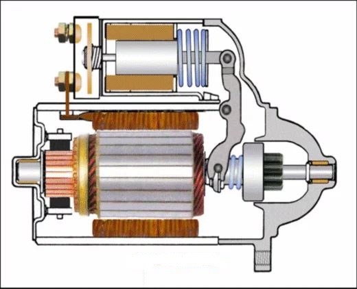

The starter does not use a bendix drive and the motor turns the same direction regardless of battery polarity.
EDIT: Strike the comment above on rotation. I looked at the parts breakdown and that looks like a PM gear reduction starter and in that case it would reverse rotation with polarity. The rest of my comments remain.
The starter gear is pushed into engagement by the action of the solenoid. In most modern designs that also closes an internal set of contacts that energizes the motor after the gear is extended.
This problem description is not adding up. Perhaps he is jumpering battery to the armature contact on the motor and not the solenoid itself. That causes the motor to spin but does not energize the solenoid.

What Dan said makes sense when you think about it. The starter motor would be a series motor design, which offers very high torque at start. A series motor will run the same direction if polarity is reversed. The only way to reverse direction is to reverse the hook up of either the field or armature. Probably not easily done with a starter motor without disassembly at minimum.
On my starters I believe only the positive main terminal the battery connects to, and the starter solenoid activation terminal, are available externally. I would guess this is pretty standard, but I don’t know. So it seems unlikely the OP could be hooking the jumper to anything other than the solenoid activation terminal or the main power lug. Would be nice to see a schematic diagram of the motor internal connections to determine if there is some possibility of an electrical path between the solenoid activation terminal, and the armature/series field circuit.
