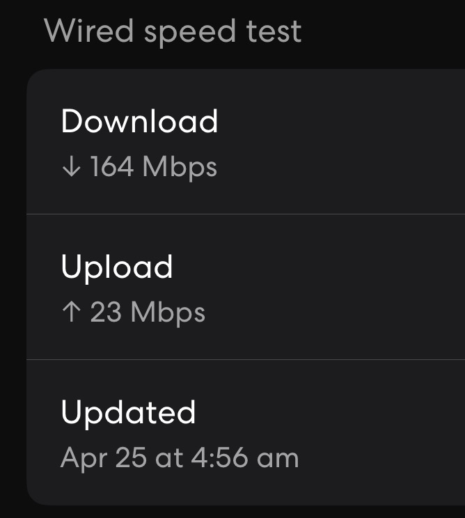

My speeds have been around 120-160 Mbps upload around 40. I repurposed my old Viasat mounting pole with the Starlink adapter and mounted it up off the ground. Trenched the cable back to the house. Coverage for me is good. I did split bands on their Wi-Fi to keep older devices from dropping. If I need a mesh network I will get another access point from Starlink

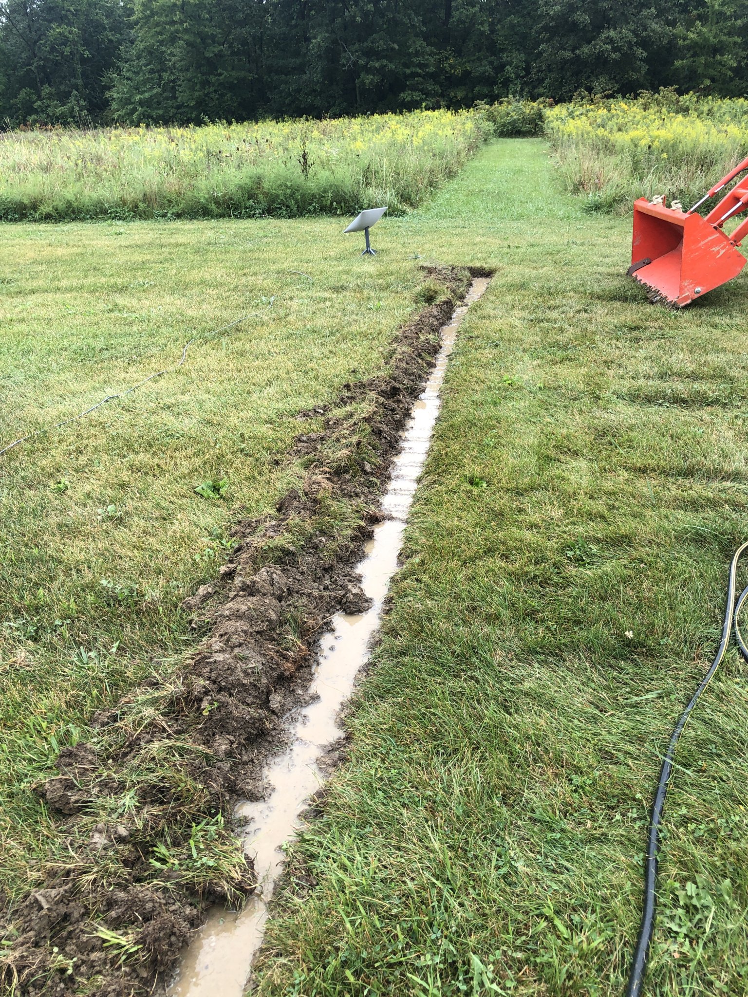

This is what I think I will do. I actually have a 10x24 flower bed about the same distance as yours looks to be from the house. Ill probably plant a post there--actually I also think I have the old Viastat pole laying somewhere--thanks for the idea.
Did you use pipe or bury directly?

I buried direct and then ran it in pipe up the house from about 1’ out in the grass. May regret that later but for now it will do. Get the pole adapter from Starlink to mount on the Viasat pole. I also used that foam stuff to set the pole rather than concrete. Works great

I would suggest conduit all the way, the cables are not meant to be buried and critters love to munch on that type of cable, and if you need to replace the cable, it's snap to change it out if it's in conduit.
If you run the conduit up the inside of your pipe the cable will not be exposed to the elements at all.
