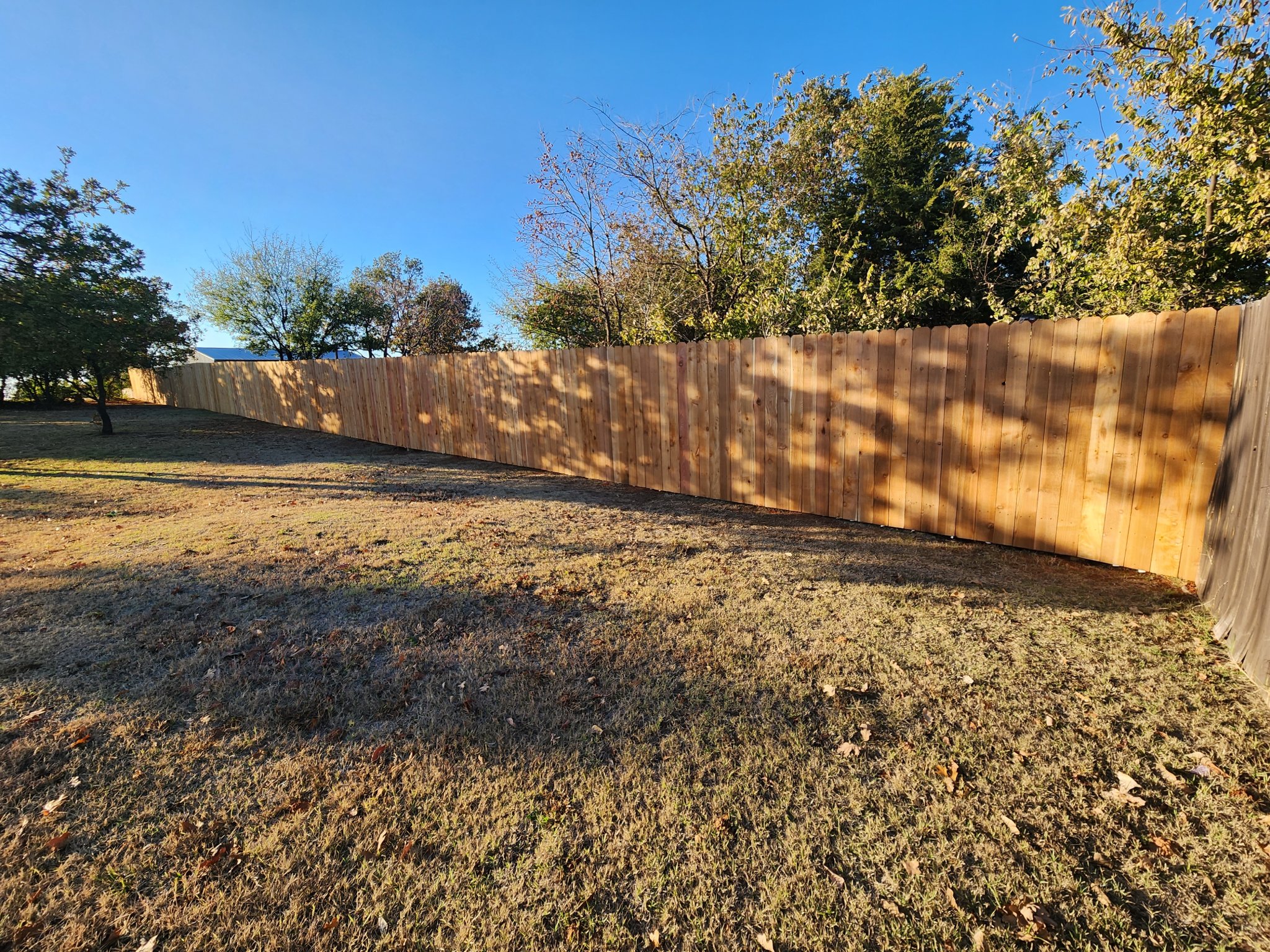

Was mainly using it for mowing until I gathered the supplies to start building the fence around my place. There will be around 600 ft of fence needed to be built to secure my place, but needed to start on one corner of it sooner rather than later. The corner was around 200' of fencing in total. The whole reason for purchasing the BX was so that I can provide most, if not all, of the labor needed to do these jobs; in the easiest ways possible, post hole diggers are no fun! That being said, I went and bought an auger and a box blade to start accomplishing these tasks. After a day of digging 26 holes and about two weekends of setting post and running stringers, the fence came together!
I ended up saving about half the price doing this myself rather than someone else, as the qoutes I received for this much fencing was astonishing. Materials played a large part in it, as everything is Ceder. This portion of the fence will be getting a stain soon, as it is now starting to dry out after the winter months. Before I can complete the rest of the fence, I need to start clearing the brush that is on my property. For that, I knew I needed a loader, and that was another reason I ventured into the BX line. It took some searching and patience, but I was able to finally put my hands on a loader.

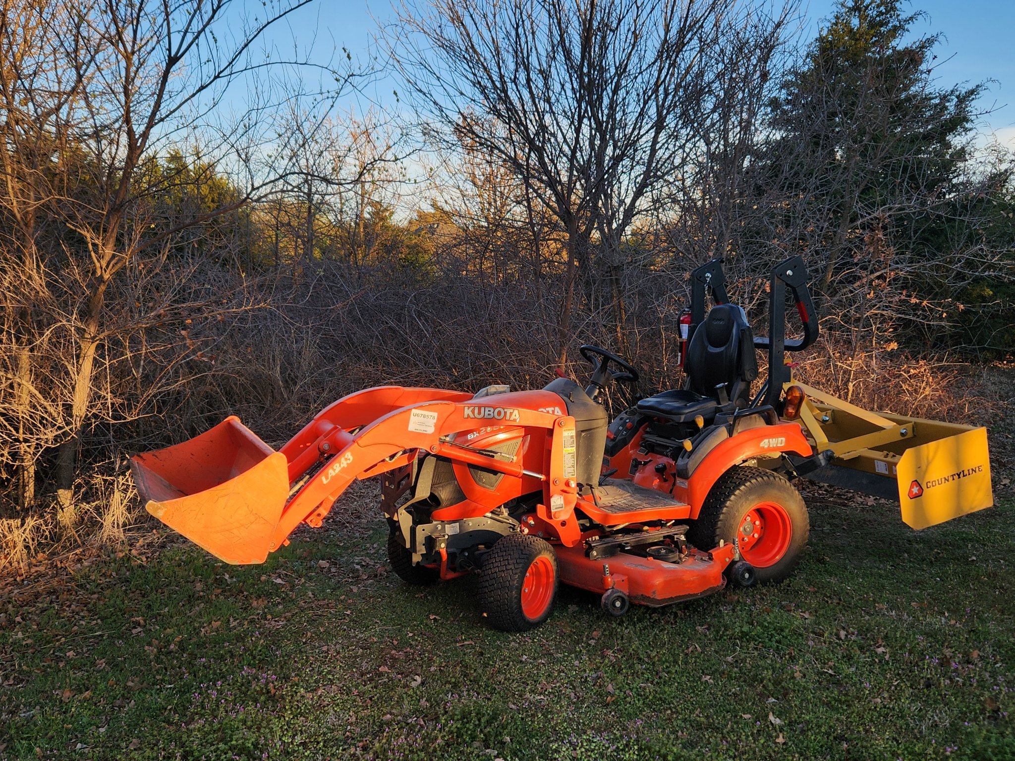

The local Kubota dealers were not helpful and only wanted to sell me a new unit, which was nearly 5K. Despite my BX already having the bracket and hydraulics, they were just so adamant about installing a new one and charging labor to do so, no matter how many times I told them it wasnt needed. Began searching outside the local area, and found a dealer about 2 hours away that had a used LA243 in great shape. The dealer was again skeptical that it would work on my newer BX, but all the research I did, it would fit no problem. So 4 hours of my time and only $2K later, I was home with a new to me loader!

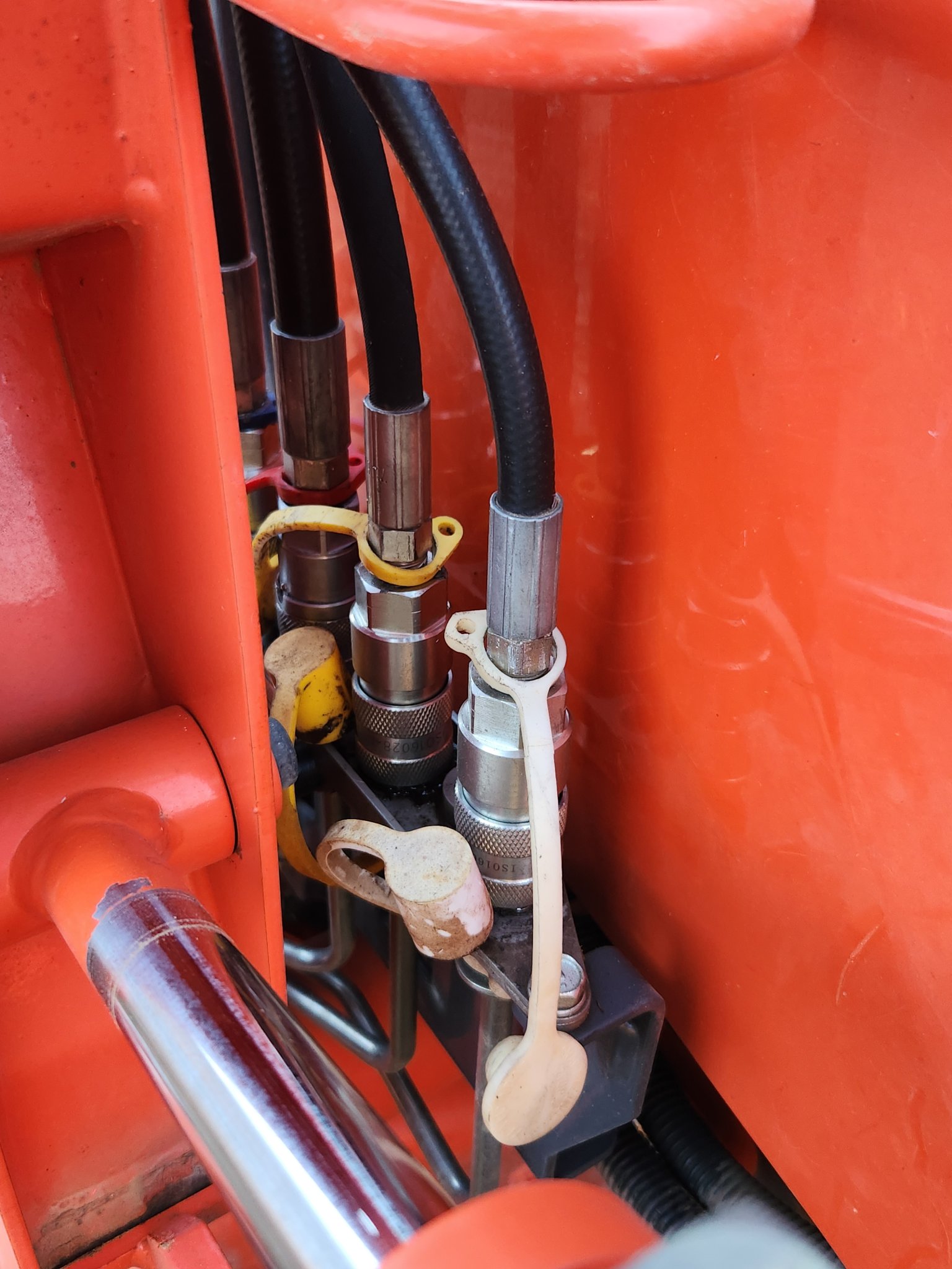

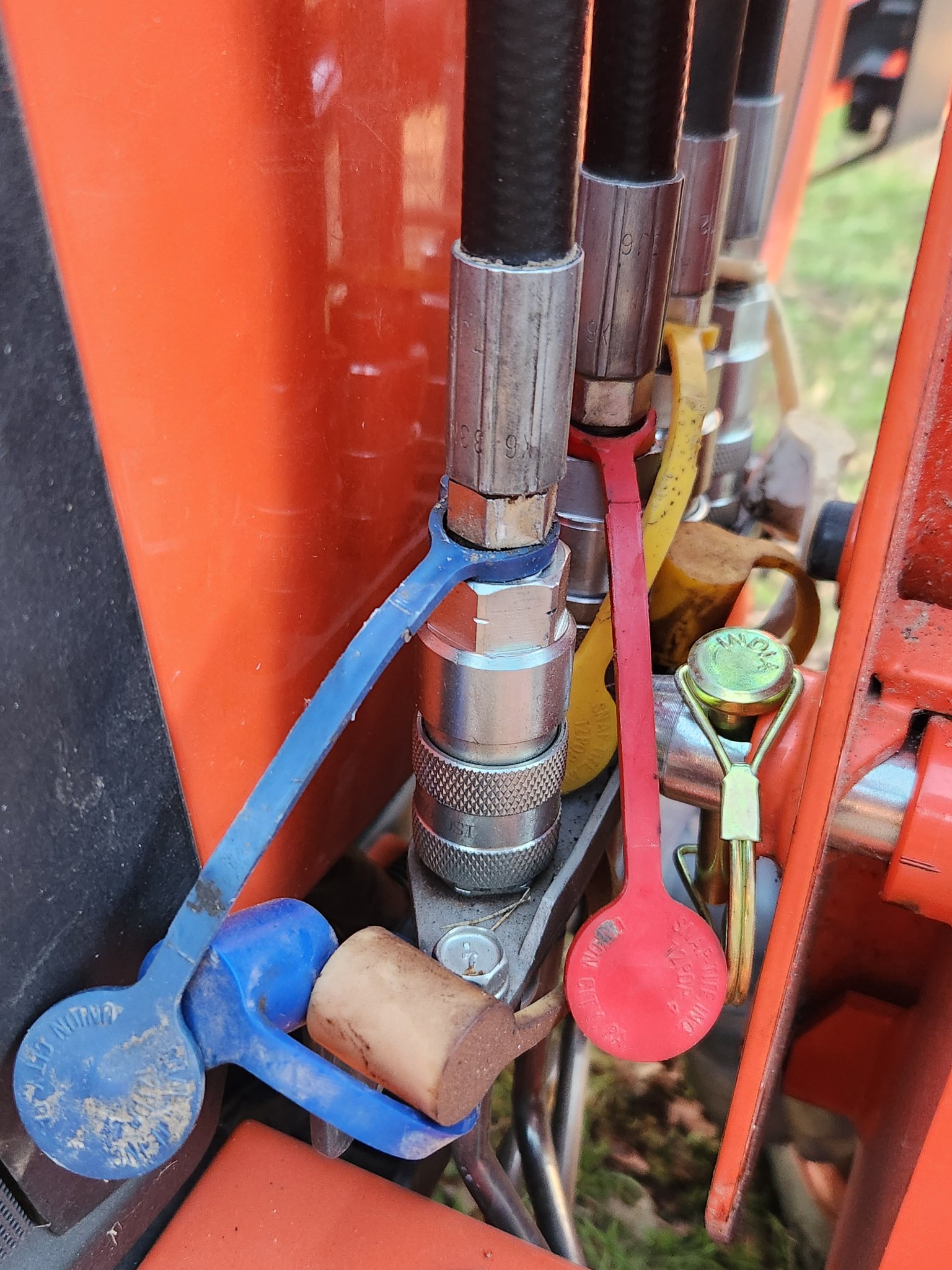

The only modifications that are necessary to fit the LA243 on the newer BXs are converting the older Pioneer Hydraulic Fittings to the newer Flat Face style on the newer BXs. This is very easily done and no issues have presented themselves since I converted them.

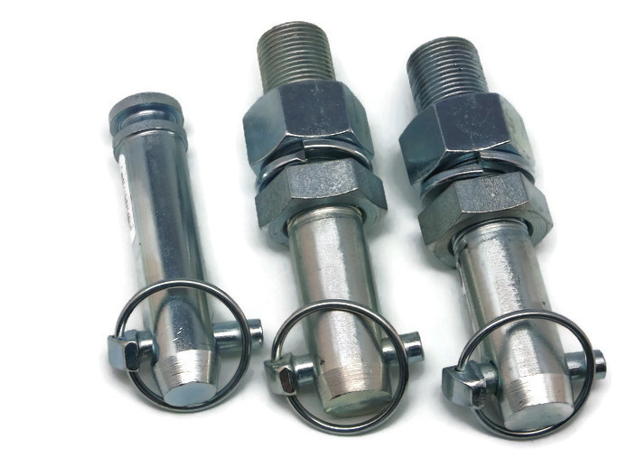

Couple of things that I noticed, and I hope that you take these as helpful not critical of your work. I would trim the rear edge of the chute blocker to have rounded corners since sharp points can do a lot of damage to ankles. The other thing is the retainer pins in the loader pins are incorrect for the application. The type that Kubota used is closer to the hole diameter and spring loaded. Refer to the picture below.
Appreciate the feedback. The Chute block is not the final product, just temporary until I get around to making a final revision. That being said, I hardly exit on the right side of the tractor and I am young enough to not fault on it lol.
As for the pins, I would have used lynch pins but they would not properly close on the side with the hydro lines. I have a set of the OE Kubota pins on order from the local dealer, but who knows when those will actually show. The 1" hitch pin that I am using is more than strong enough to support the loader and fits perfectly with no slack. The lockpin is simply so that the hitch pin will not move out, and I doubt they will even without it.
