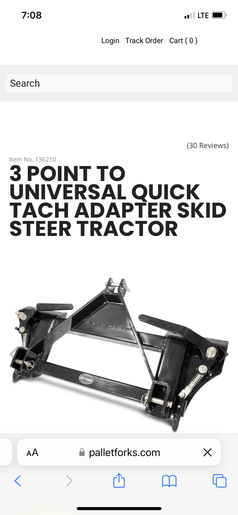

I have titan (see pic below) adapter…I originally got it when I had a BX(long since sold BX) and I got so I could put a carry all on the front or my forks on the 3pt. It works as designed. The price seems not at all close to what I thought it was. I am glad I have it but current price seems a lot to me. I still use with B as needed. It’s a lot awkward to put on (not enough hands) but once it is on it works fine with no issues…on and off an extra set of hands is helpful IMO. 🥃
Thank you, I think this is the opposite of what I am seeking. I want to put 3 point attachments on the front, not ssqa on the 3 point.
