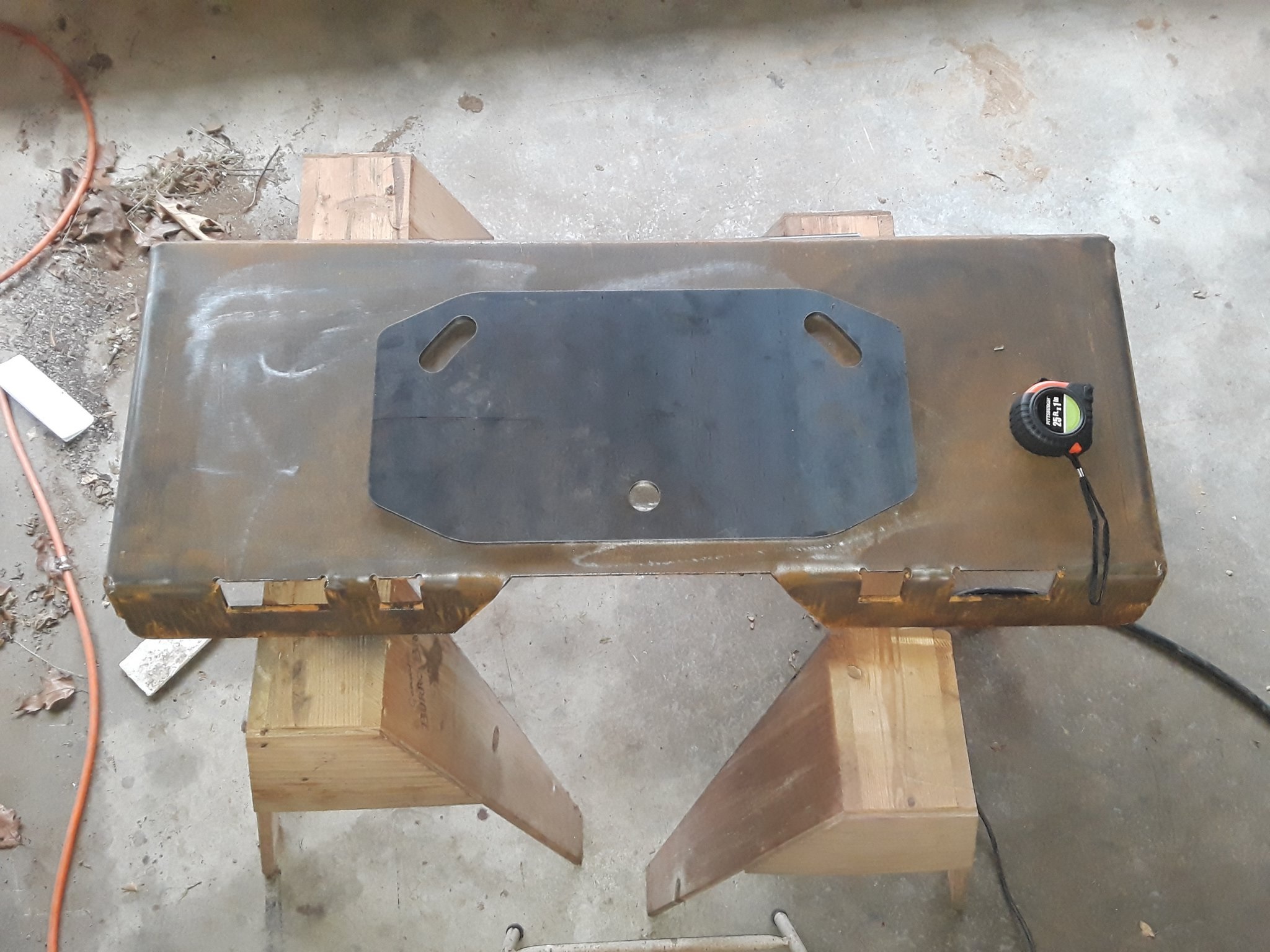

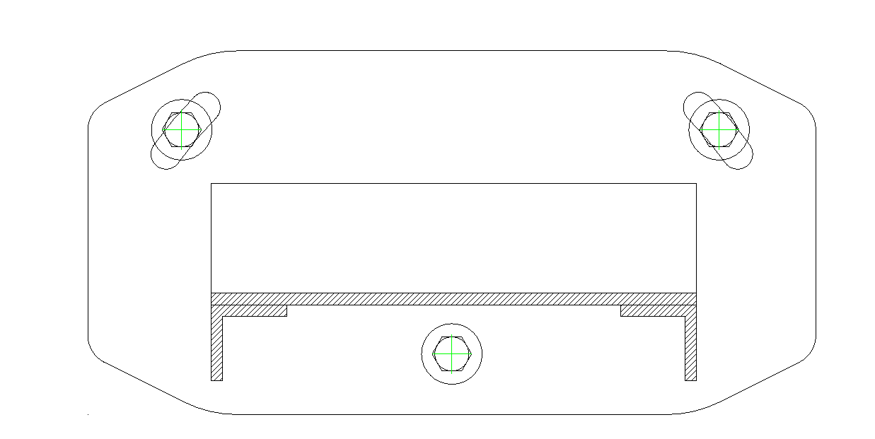

I thought as much. My plow is considerably smaller and lighter so I think 3/8 is probably fine. Here is my sketch-up. I always have to add my own touch so I made the pivot hole 1-1/4" with the idea of putting a flanged bushing in the hole to retain the plate and act as a spacer to allow the bolt to be fully tightened. I will send this off to the laser cottier for a quote tomorrow.

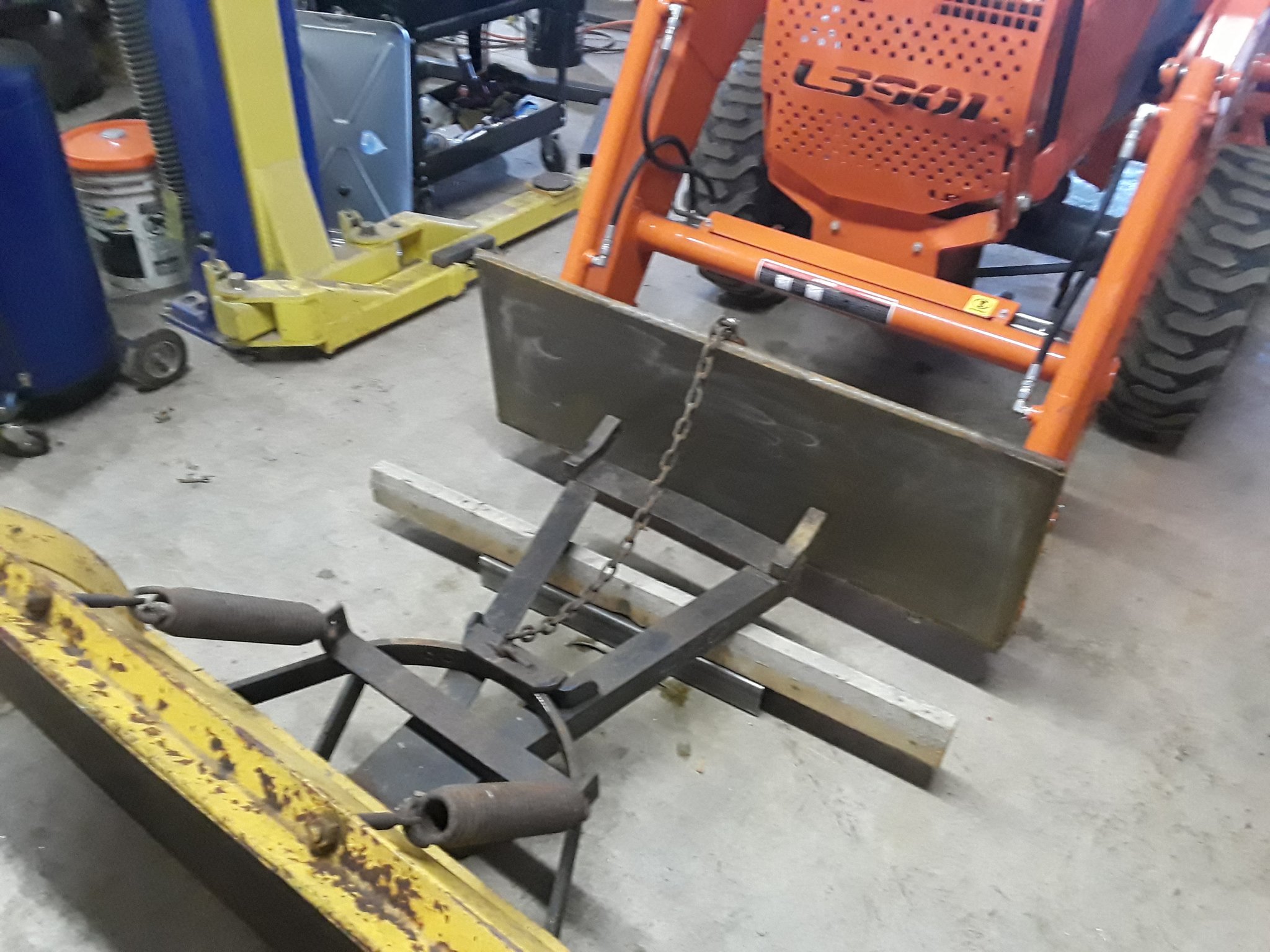

On mine I used a Fisher plow and A frame, I shortened the A frame to just where the cylinders mount, about 6". I use a chain attached to the front of the A frame and to a receiver tube I put in the top of the quick attach plate thereby having the ability to float without putting the loader in float mode.
Dave, is your quick attach plate 3/8" or 1/2" material?
Very nicely done!
You might be interested to know that the two bolts that reside in the slots are 3/4" diameter. The slots are 1-1/8" wide and there's a bushing that the bolts pass through that's probably 1" in diameter and that bushing rides in the slot. The slots are not parallel sided, but as your drawing shows are centered along the circumference of a circle with an approximate radius of 10" whose center is located at the pivot bolt.
Are you providing the 3/8" plate to the machine shop? I paid $260 a couple of weeks ago for a 48"x32" piece of 3/16" floor plate .... crazy!

The bolts in that drawing are on a 11.5" radius and the slots are 1" wide. I like the idea of the bushings/spacers in the slots and I will adjust accordingly.
I am not providing material to the laser cutter - the cost I posted was their online quote for a 24" x 12" laser cut rectangle of 3/8" A36. It don't expect it to be much more for the added details. I just had them cut and bend 10 of these from the same material - they are 6 x 10 and were $22 each. They do excellent work at very reasonable prices
Excellent prices for sure and those pieces look great! (y)

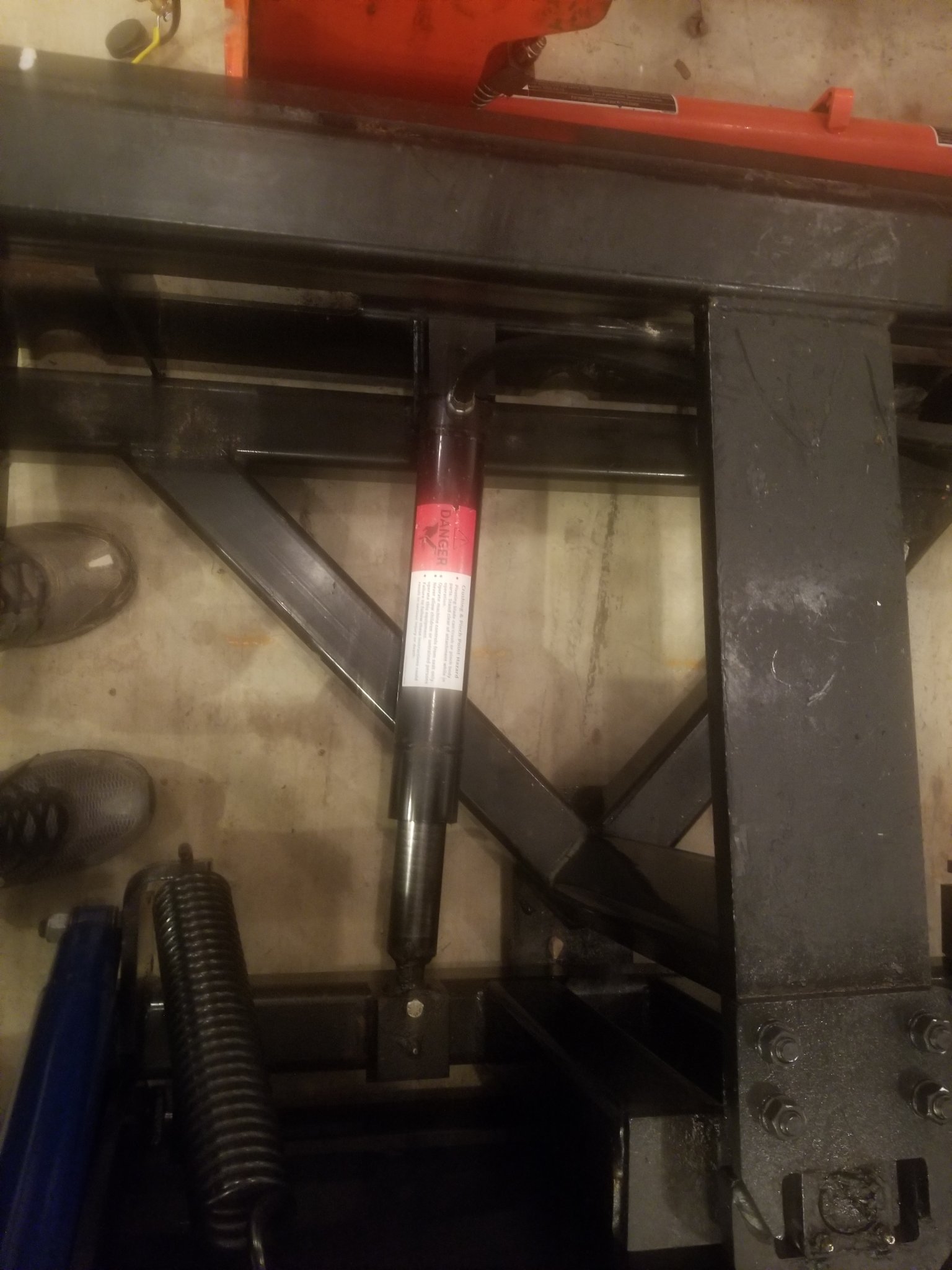

geedave.... your plow springs seem to be missing the 'keepers' (bolt +nut) on the top of them ?
That is a Fisher Plow. The springs are compression springs. When the plow contacts something the bottom cutting edge folds back compressing the springs. On other plows with extension springs when you hit something the plow folds forward extending the springs.
The Fisher does not have a bolt in that location, the design of the way the cutting edge hinge bolting to the plow keeps that assembly (that holds the spring) in place.

if it was mine, I'd hit 'something' and the blade would launch away from the springs, they'd then go into orbit and I'd be singing ' where or where have my plow springs gone' !
It's actually only 1/4" but that plow is an sd or something, very lightweight with a plastic cutting edge and was put on a diet by good old northeast road cleaner upper stuff.....lol
I don't think this one ever had bolts in the top of the springs.

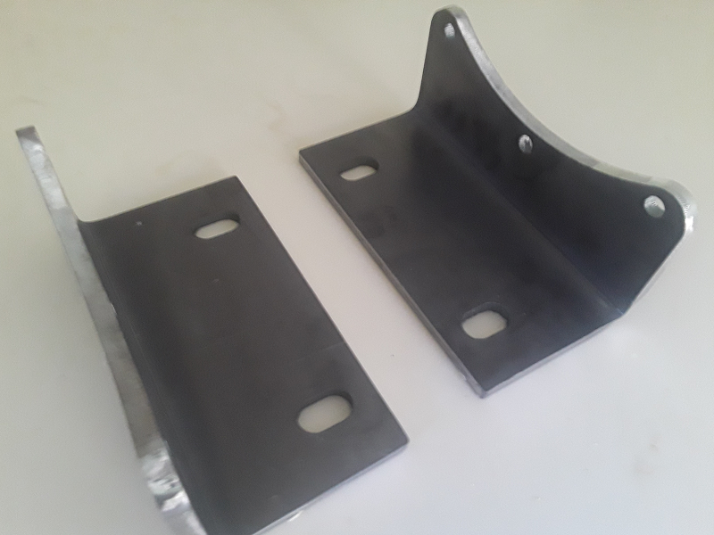

Laser cutter turned the push plate around in less than 2 days.. Now all I need is the cylinder brackets to mount the plow. If they don't ship soon I am going to cancel the order and make my own.
