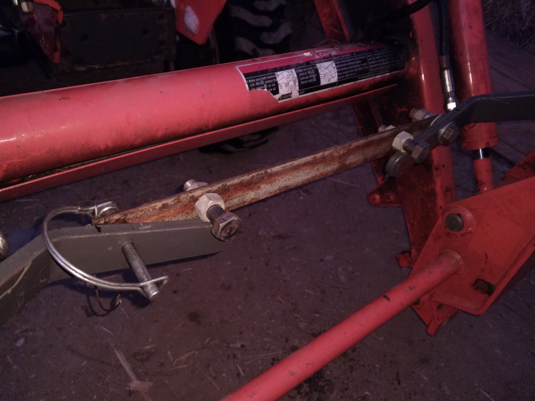

I'm digging around in the hardware disaster zone in my garage today for some parts to try an idea for this.
All I can say is, so far, there's one 15" metal bar or angle, 6 x 3/8" holes to drill, 3 x 3/8" machine bolts/washers/nuts, and a linch pin involved.
Wish me luck! It's a REAL mess in there - years of carpentry contracting bits and pieces piled up. But time for this stuff seems a-plenty lately...
More pics will definitely follow once more progress is made. Won't be long. I want something in place if possible before the next bush-push for firewood.
And Happy New Year too, to you and everyone!
nbryan
Jan 3, 2019
1,166
708
Hadashville, Manitoba, Canada
Done.
Those are 1/2" bolts. They're what I had around.
I figured out the concept and action with a piece of wood for a template, then just made do with "junk".
Ugly but effective!
I heaved on it heavily to check for play and there's very little, and what play there is still keeps those pins back inside their head stopper so I'll trust that a stick will break or bend first.

Perfect solution. Can't see those going anywhere. Keep us posted on how they work.

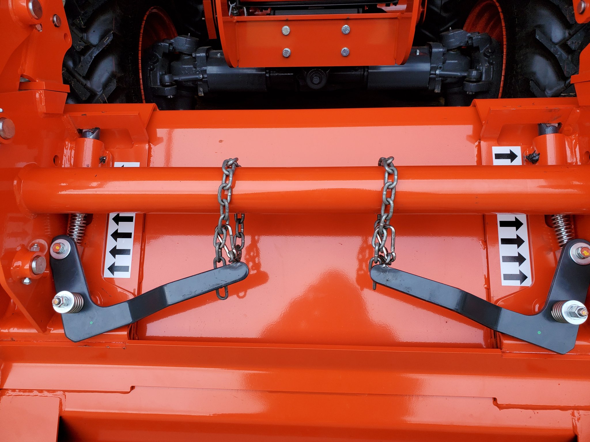

Welded a length of chain to the levers with a small carabiner snap hook to prevent inadvertent opening of the latches from sticks, etc. Will thread the chain through a piece of silastic tubing so the paint doesn't get rubbed through. Picture was taken with the bucket hyper-extended in the dump position.
That'll work!
nbryan
Jan 3, 2019
1,166
708
Seat Switch is required by Outdoor Power Equipment Safety standards that cover a LOT of countries. Don't have a choice, from the smallest garden tractor to ANY tractor than can be fallen off of or turned over. That standard pretty much includes ALL tractors and a lot of other equipment too. If the safety being completely mechanical is a need, I guess you could tie a string to the coil wire if you had a gasser. But since there's no ignition system on a diesel, that's a little harder to do with a string, but I guess you could still come up with a butterfly in the intake that would shut off air flow.
The seat switch is to shut the engine down if the operator leaves the seat and the transmission is engaged, or the PTO. Kubota has been generous enough to provide a new option on the LX models that allows operating the PTO with the seat still down by locking the brake, putting the range selector in N, and then pushing an override button for about 10 seconds. This allows using stationary equipment like chippers. Miss one detail, you shut the engine down. Simple safety. It works.
But back to the subject at hand, I'm not quite sure that a chain that heavy would be required, and I'd probably opt for some kind of pin latch if I was that worried about it coming out. If 'sticks' come up behind that adapter plate, stiff enough to operate those levers, you're about to either rip a front tire apart or relocate your radiator to the 3 point hitch. As someone else pointed out, they latch by cam action over center and are spring loaded. On top of that, you didn't pin the actual latches, only the handles. You did know those handles can be fully engaged and the latch still not fully engaged, right? What's to stop the same 'stick' from pushing the latch pin out of it's hole? The latch pins not fully engaging is more often than not what creates hazards, despite the handles being fully down. There's no substitute for a visual confirmation that the latch pins are fully engaged. So, chaining the operating handles really isn't going to help much to prevent the problem you're targeting.
To each his own, though. Not criticizing, just debating.
With the handles fully down the pins are blocked from rising more than about 1/2". Please see previous posts and photos (post #50, pic #1). Raise a locking lever 2" (to about horizontal) and the pin is pulled out from under the stop block, and can rise further if pushed from below, but still is not fully clear or the fork frame. But enough to fully compress the pin spring.
I ALWAYS visually confirm that the pins have engaged when attaching. As should any operator using ssqa.
And I twisted my ssqa frame when a not-too-large branch flipped a lever up while backing up, and the forks frame on that side caught a stump. A heavier lever resistance would have either bent or broken that tree sapling or I would have noticed being hung up on it.
So with my contraption there'll be no more unintended or unnoticed lever release.

My SSQA lever lock has performed flawlessly so far. And I've certainly given it reason to let go - had some pretty thick branches jammed up in there last week while trail breaking in the back 80.
It's a keeper!
