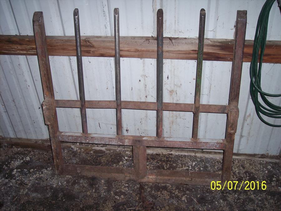

PHPaul, I made an attachment for my loader many moons ago for doing that. It's simple, easy to make and inexpensive.
I might get a picture of it today, but I used old barbell round rod, cut a 45% angle on one end. Have the extend out about 2' past bucket lip. Have 6 or so pieces evenly spaced welded to some angle iron. Bracket hooks under lip of bucket and has a short chain that goes under the bucket and comes up the back and hooks over a ball I have mounted. I use a small load binder to cinch it snug.

Here's some pictures. I have a 2" ball mounted on the top of a loader I use for moving trailers. I put the chain with the oval loop under the bucket and over the ball and tighten. The chain is welded to the fork assy. and made to just the right length so when the boomed is snapped over center it's tight.
I made the for a 4' bucket on a B8200. You could adapt the idea to any width. I've moved a lot of processed hay with this tool!!

I made it so those ears clip on the bucket, and the rest of the iron goes under the bucket. The outside square tubing is like 1 1/2". All made with iron from the bone pile.
