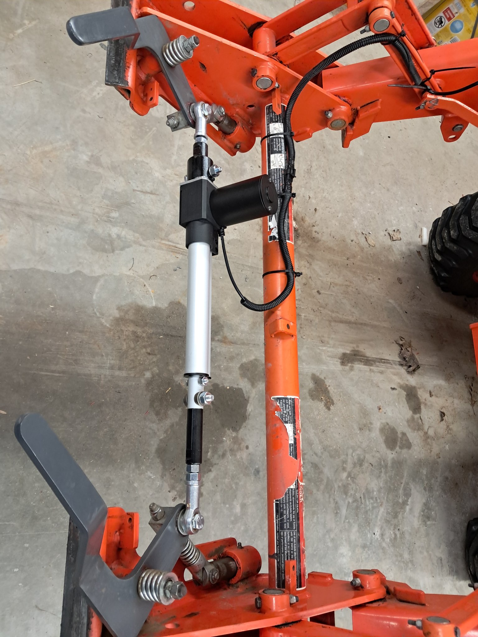

My main reason for adding the actuator is I use the grapple a lot. Sometime a branch releases a lever.
[/QUOTE]
This is the reason that I have not installed an actuator. Since I only have a bucket and a grapple I have to get off the tractor anyway to hook up or remove the hoses. I installed safety brackets on my levers to hold them in place. I also like to raise the loader after attaching anything to look and verify that the pins are fully in place.

In that video though, I do not see the actuator attached to anything.
It kind of “floats” in the middle, first unlocking the right side, then unlocking the left.
I have never played with one of those actuators before, but here is my initial thought.
If the actuator was “held in place”, would both sides operate at the same time?
The lever with the lowest force moves first. And no, you cannot fix the actuator because only the "loose" side would move then.
If you want simultaneous movement you could use two actuators with half the stroke length each and fix them in the middle of the loader. They have to be fixed on a pivot to allow a bit of angle movement.
I think the single actuator for both levers is a pretty nifty idea though. Does not really matter which lever moves first. Or do you move both levers simultaneously when you attach something by hand? ;)

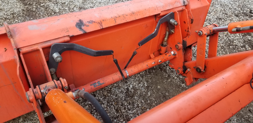

Here's my solution. Necessary tools minimal. Necessary labor minimal. Cost also minimal, Functions simple.
I actually tried that. One swamp-bush branch catching that and it was gone.
Really.
Don't depend on that piece of hooked rubber holding, one bit.
My bolted on steel angle iron laughs at the bushes. An it's easier to engage than frozen stiff rubber bungee cords fighting my old messed up rotator cuffs, that's for sure.
This would "in theory” eliminate the need to do one side before the other, and instead save time by doing them both at the same time.

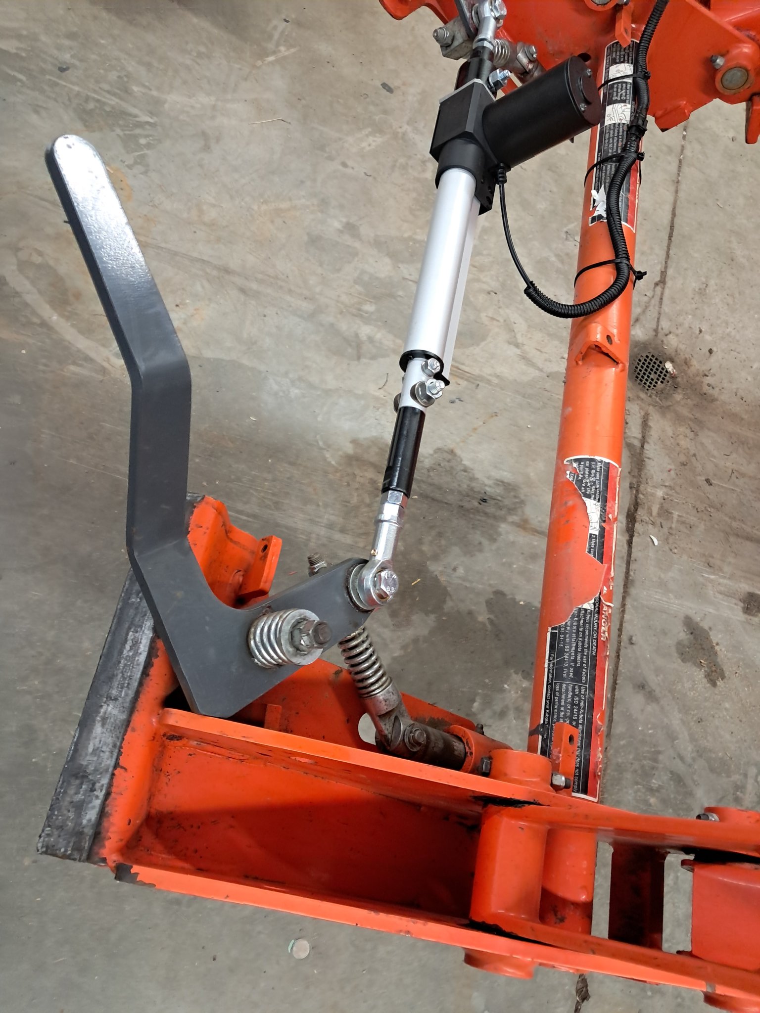

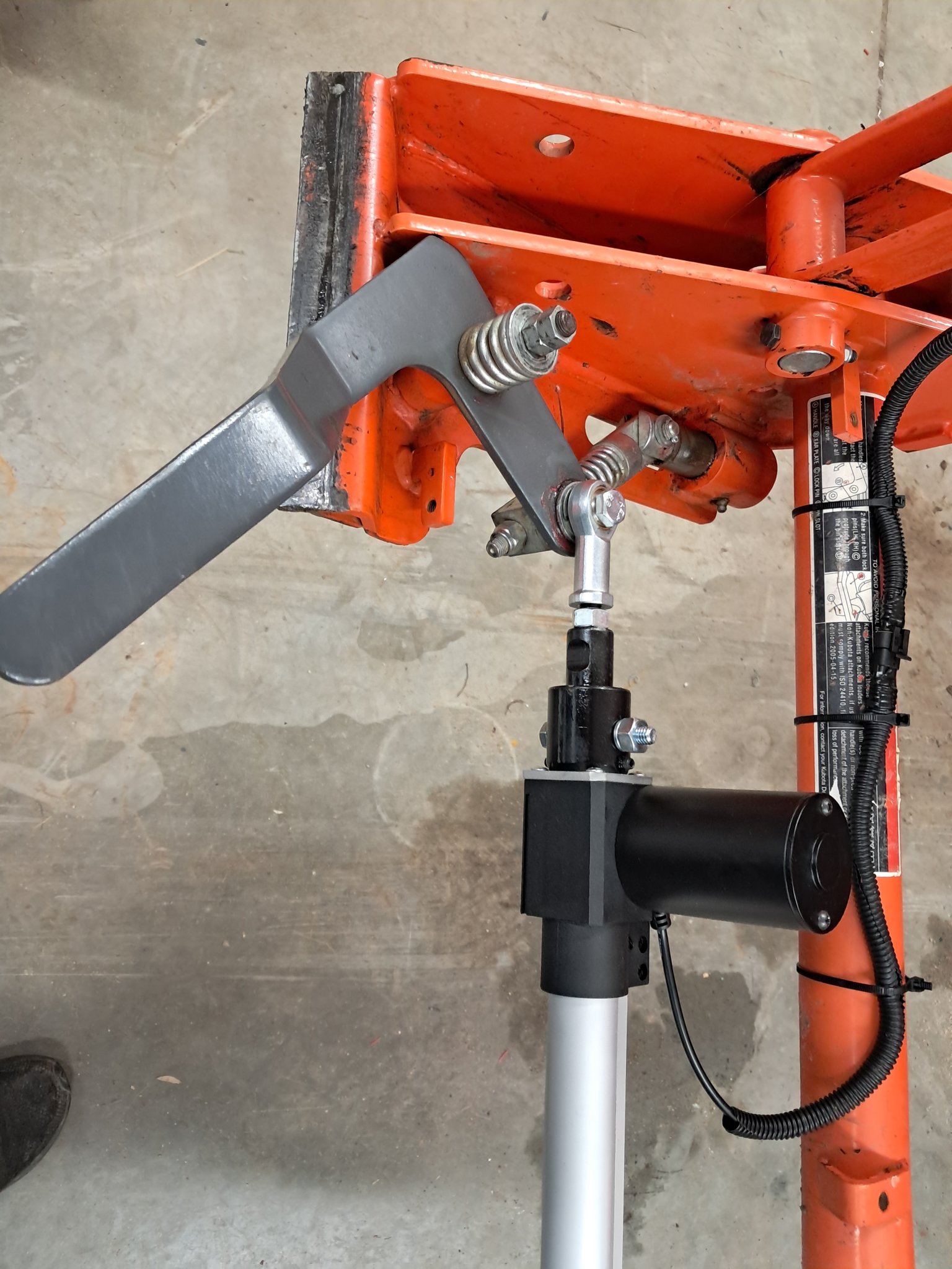

Didn’t for get just got busy with a project. The way mine is mounted is covered in the first page.
Although I was releasing my bucket earlier to time it and it broke the mount. I used aluminum EMT and the bolt just pulled itself through it. Time for a redesign, might go with steel or a different type of mount.
