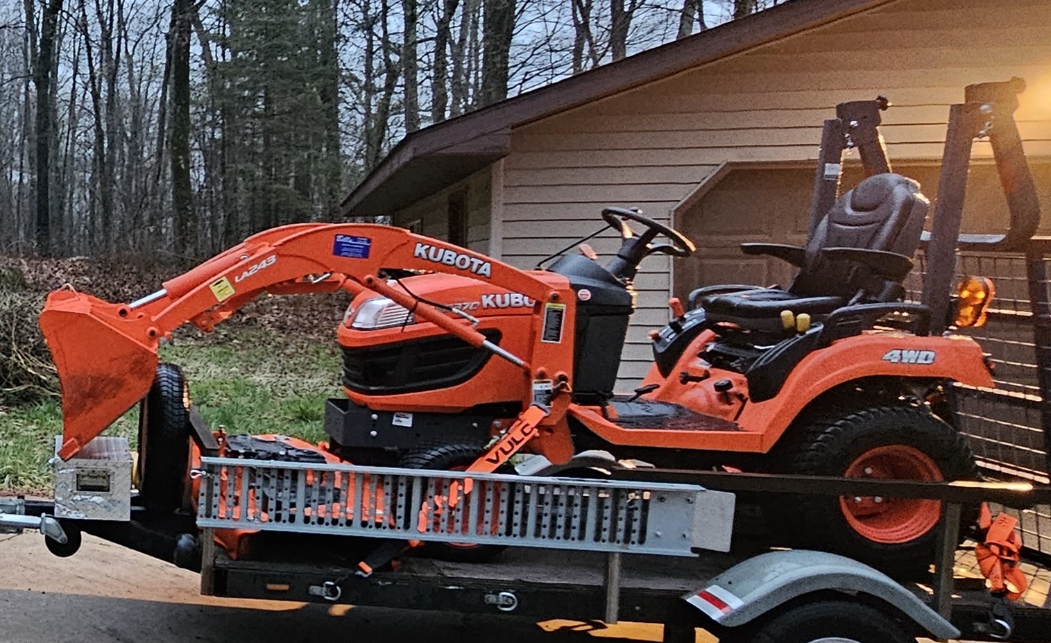

I have a new-to-me 2017 BX2370 with pin-on bucket; from what I understand SSQA (Skid Steer Quick Attach) was not available in 2017 as an OEM option, and in fact I'm finding it difficult to find information on adding SSQA to the BX Series tractors.
I found threads on D-I-Y SSQA, though before rolling my own I'm wondering if quality/affordable pin-on SSQA adapters exist that fit the BX2370 FEL (Front End Loader).
Purpose: Adding a SSQA
  • Stump Bucket
  • Root Grapple
  • combination 2" Receiver (for a ball hitch) and Post Puller
  • and SSQA adapter to the existing bucket for ease of use.

curious, what loader model is on your BX2370 ?
My 2018 BX23S has the LA344S, s means ssqa is on it( 7J62636103 ).
Those that work on the little beasties may KNOW if it'll fit or not.
You could lookup the loader drawings, compare part numbers for with the LA344S.IF your bucket is the same as the nonSSQA loader , I suspect the adapter will fit fine.
If not, make your own from 'kit' of the SSQA lever/end pieces and some 1/4" sheet steel
or
goodgle 'bx2370 ssqa adapter' ??
add to your list .... pallet forks !!!!! super handy

FEL: LA243
I tried searching this forum and general Internet searches and came up short on the BX23 series SSQA adapter, though it could be I'm going about it wrong. Finding SSQA specification diagrams and weld-on locking leaver wasn't difficult, but I'd rather not design/build my own wheels if there's a tire store down the road... (I'd rather buy a well-designed SSQA adapter than build one if the price is reasonable)

The stickers on both say "Worksaver" and their website lists #835130 as the part number as noted above. Lots of dealers/retailers it appears, so price one out near you and let us know about pricing and availability.

You thinking something like this? https://asktractormike.com/product/kubota-sub-compact-quick-attach-conversion/
Reasonable cost might be a bit subjective...
Thank you for starting this off. What @GreensvilleJay posted is exactly what I'm looking for, though a BX is tiny compared to a LA, so fitment is a concern. If that SSQA was available in a smaller BX version for $400 or less I'd buy it. It's obvious the quality is top-notch, and way more than the BX needs.
If not, two of the brackets @North Idaho Wolfman posted are a starting point.

I believe the 70 and 80 series loaders have the same pin locations but I can't verify.
IF they are the same, the "difference" is in the pins and how they attach.
Some/most of the 80 series loaders have a attached stand that effects how the pins are shaped/mounted.
IF the pin locations are the same you should be able to use the Kubota SSQA adapter(or any aftermarket version?). You may have to figure a pin solution though.

Seems I confused the Kubota LX series tractors with the LA243 FEL, @GreensvilleJay posted exactly what I'm looking for. They're spendy, however higher quality appears to be the reason. There's a nearby dealer that carries them so I'll look this week.
Worksaver adapters for single cylinder loaders allow using “universal” skid steer interface impliments. Built with 7-gauge material to provide strength yet keep their weight under 70 lbs. for maximum lifting capacity.
