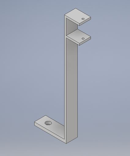

Len,
would a long piece of flat aluminum bent like a Z work? It would allow movement back and forth at the top much like a spring. Create a fork at the top to allow the hoses to be trapped in the fork and some sort of holding pin -(so the hoses could come out if need be)
