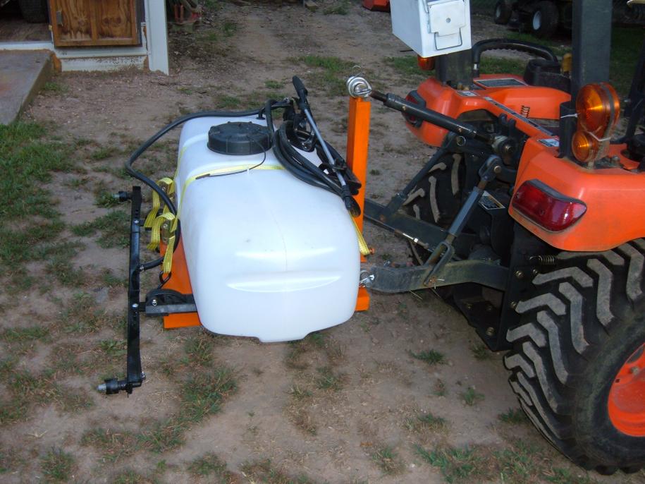

I did similar to deathtoblackberries, except that I built mine from scratch to hold the sprayer I got on the cheep from Tractor Supply.
Attached are pictures of my tractor sprayer.

Dave nicely done, check out the Fimco Pro tank cap it has a red flapper for a garden hose so you don't have to take the cap off plus an attached 32 oz measuring cup that sits inside the tank upside down attached to the tank cap. $19.99 at Tractor Supply. http://www.fimcoindustries.com/Multi-Lid.html
In other news good thing I purchased some garden hose washers, the Fimco washer inside the tank drain cap was already leaking today. The rubber washer I replaced it with sealed without having to tighten it so tight, plastic threads so got to be careful.
