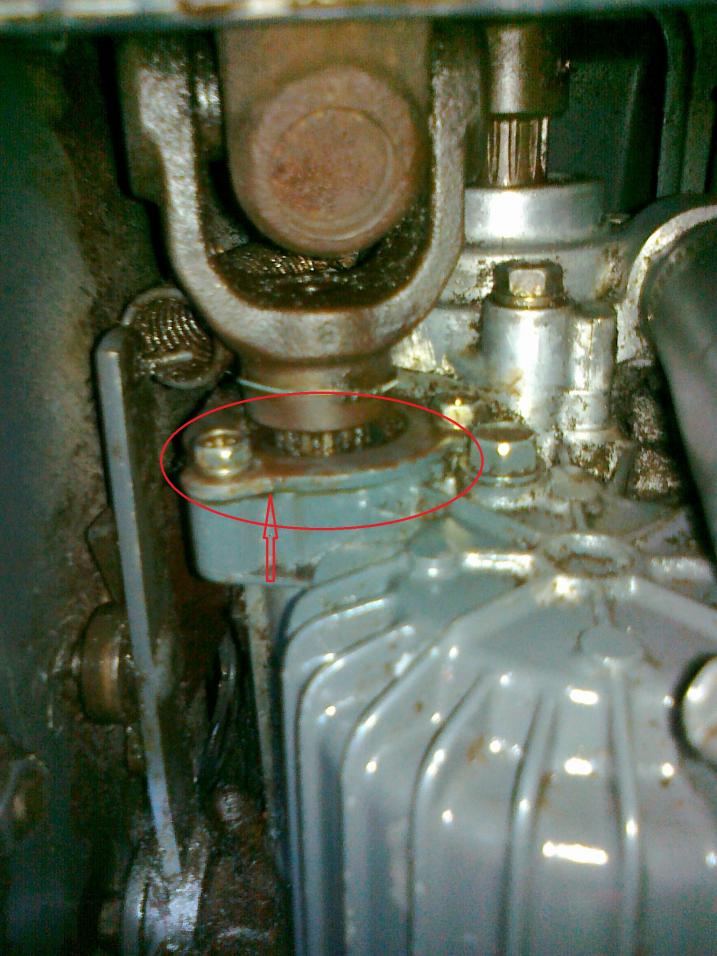

Its leaking hydraulic oil. Coming out in front by the shaft going to 4 wheel drive.
I bought the spacer kit Kubota put out to fix this issue but found out from the original owner that he tried to fix it with the spacer kit but had no luck.
He did say he never fully finished putting it back together so I may be missing a few pieces..
Do you think its worth going behind him and reinstalling the new spacer kit I have?

arijus,
The L2900 has a completely different setup for the front drive and drive line seal, it's all internal.;)
