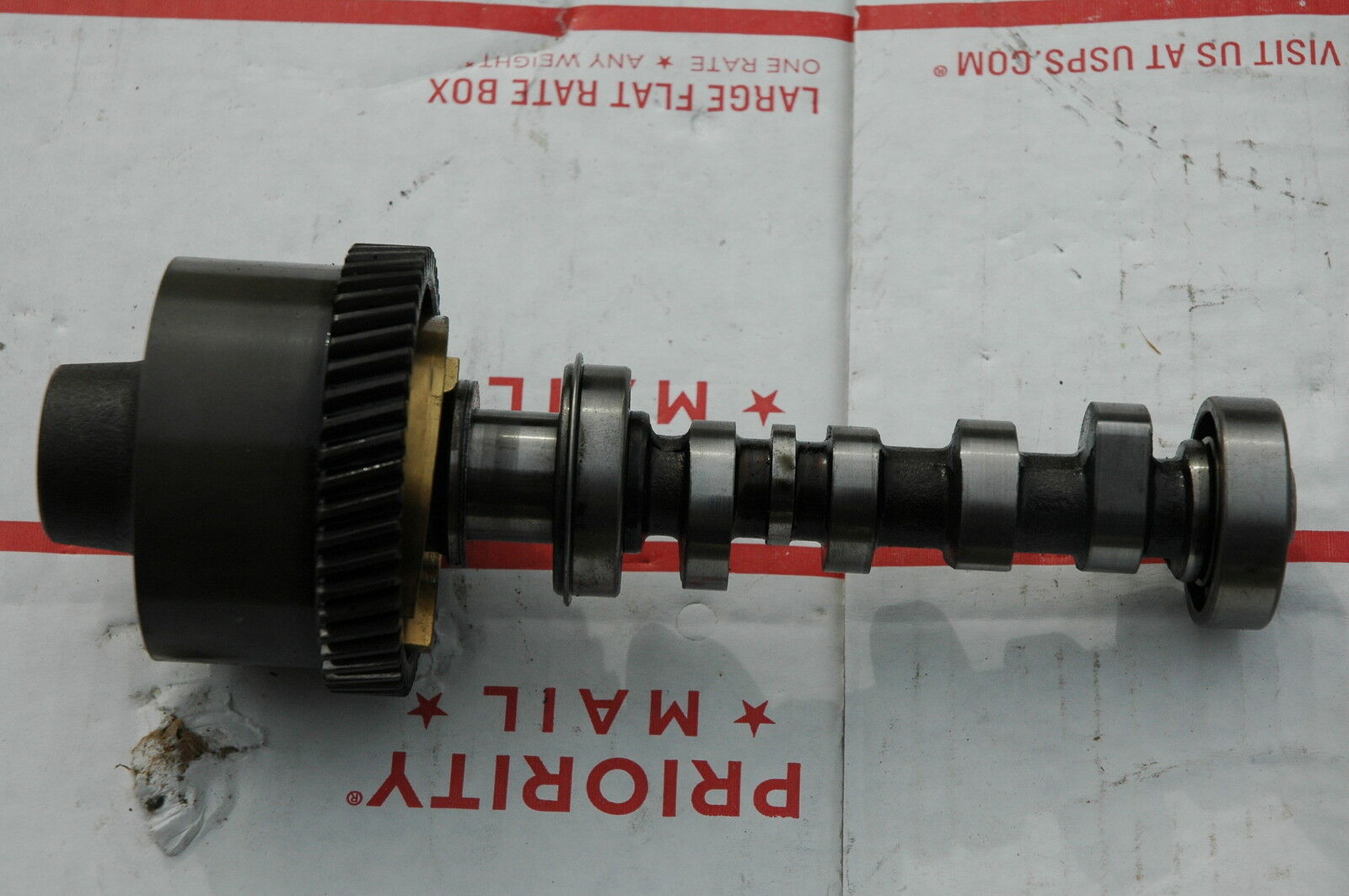

My dad found this photo on Ebay of a V1200 injection camshaft. It's not for a -5B, it was another sub-model. But can anyone tell me if this is similar/identical to what would be on my V1200-5B engine? Is there an advance mechanism built into that black thing to the left of the gear? What does the brass device do? This just looks like it could be a centrifugal advance mechanism, and if it's bad could be a source of my problems.
[EDIT: the workshop manual shows that the governor has something goin on in there. I'm now wondering if when this tractor's engine was rebuilt before I bought it (aftermarket 0.020 rod bearings were in there) the timing gears may have been reinstalled out of time, just completely reassembled wrong, or something messed up in the governor itself due to wear, etc.]

The item on the end of the injection pump camshaft is the weight portion of the governor. It will not affect injection timing.
If someone has been inside the engine previously I would suspect that the timing gears may not be timed correctly but it does not look straight forward. You will have to disassemble the governor components and reassemble them correctly.
As far as the engine not coming up to full rated speed it could be timing or it could be an improperly adjusted or functioning governor
