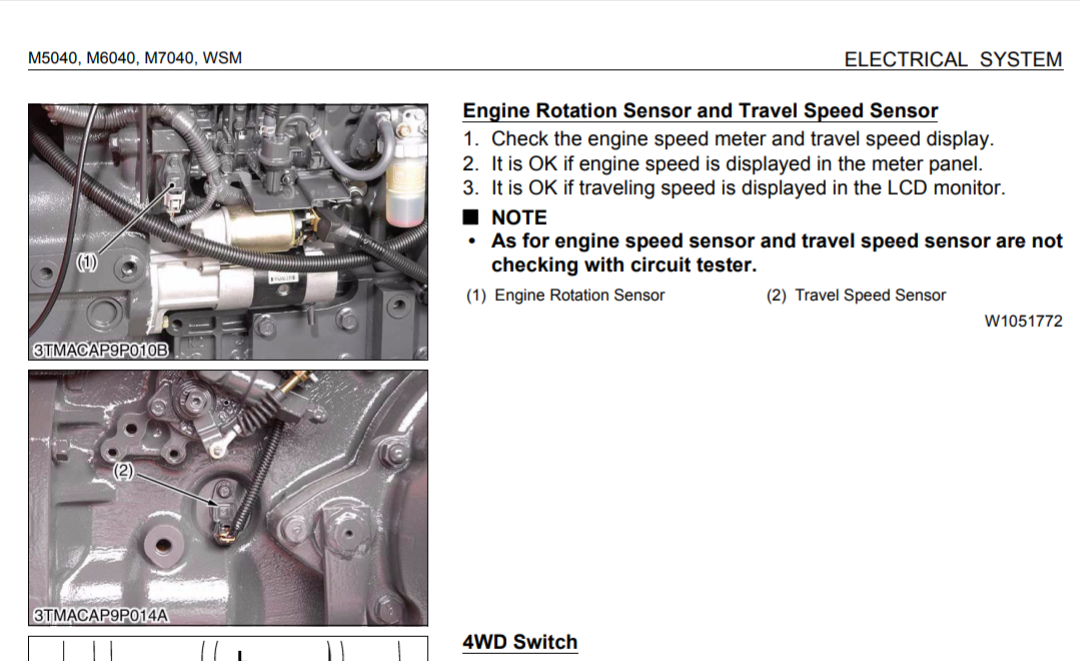

Where do I look for the sensor/cable or is that the likely problem. Display shows 0
If it's any help, here's the schematic. 23 is the traveling speed sensor, 24 is the engine speed sensor. I'll do some more looking.
33,389
8,700
The WSM has all the testing and location information.
It's not a simple system.
Look at the envelope top right of the screen
