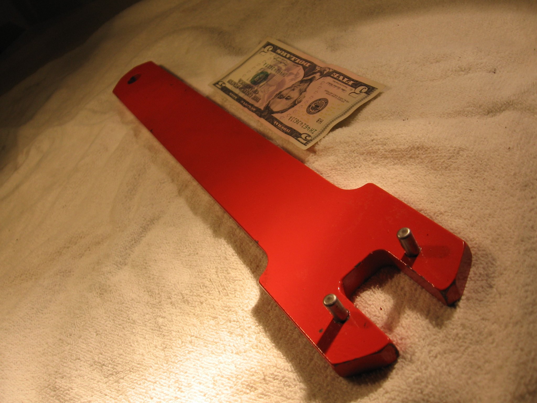

If it's a pin spanner, 10 minutes of fabrication work on scrap iron...
Made for this lift cylinder....
If it's a cap type..... use a pipe or chain wrench.
No "damn friggin special tools" required.;)

depends on the style of cylinder. Some (like the one pictured in the previous post) require a pin spanner, if that's the case just make one. Others, a big pair of channel locks will get them out just fine. That or a pipe wrench. There's a little trick to it in either case. Whack the cylinder where the threads are with a mallet before you try to loosen the gland. Just tap it a few times around the outside, you don't need to get carried away with lots of force.
I really really wanted to do it with the right tool. And, being the boom cylinders will most probably need new seals soon, I was more than willing to buy a spanner for each size. What a PIA.
Of course, Kubota publishes no spec what-so-ever of the pin size - or even a 'referral' to a model or vendor for the tool.
Hello, Mr. Pipe Wrench. Worked just fine.
