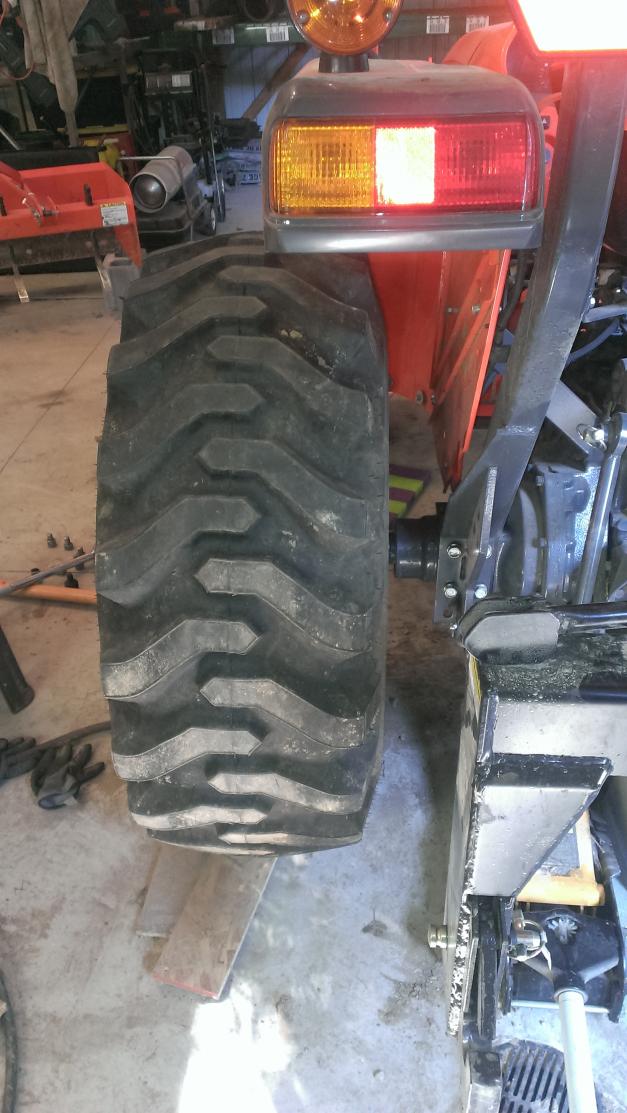

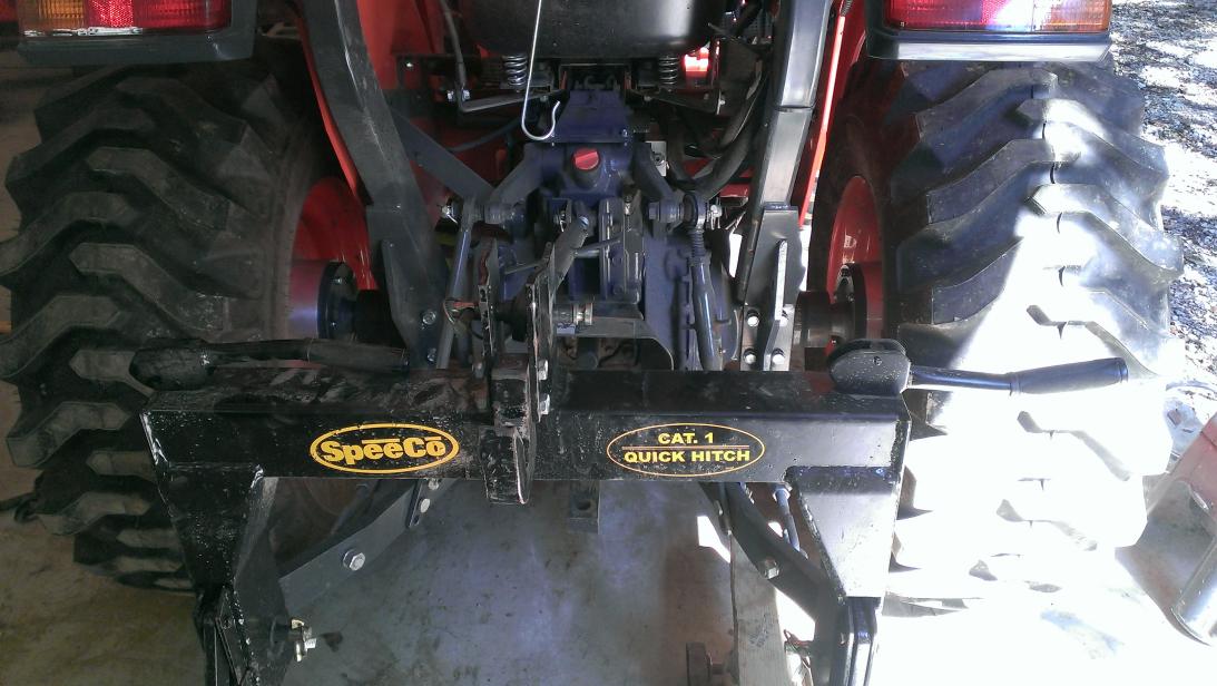

Installed the 3" wheel spacers today. Pretty easy to complete. Already put them to work...I just can't believe the difference in stability by adding only 3" to rear. Glad I did it and took the advise of OTT friends.
Pics of left side with spacer and right side without. Pic with both installed.
really does make a huge difference!!! I could not feel good without mine!
