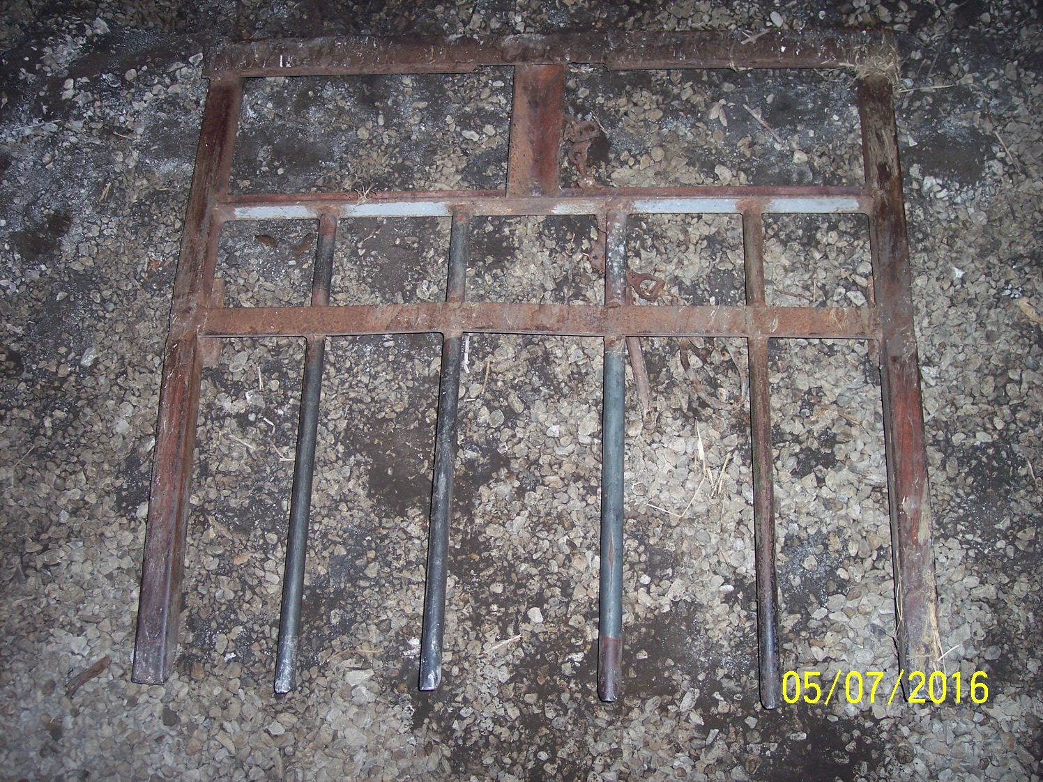

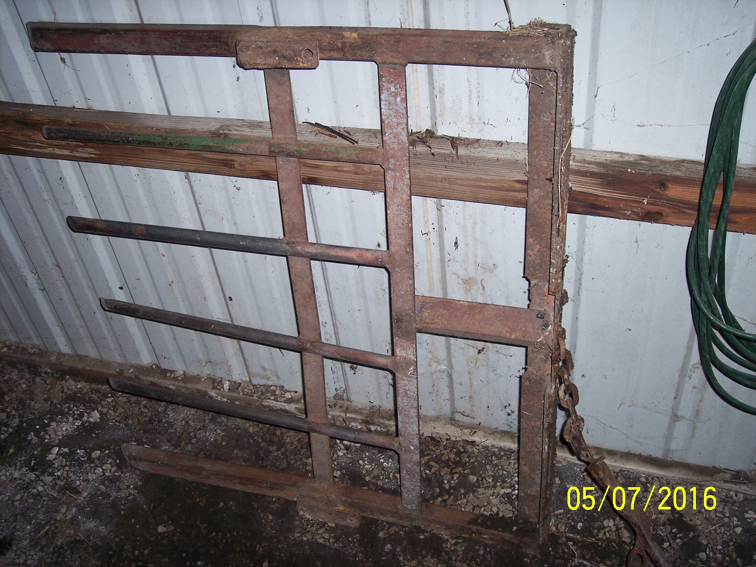

Bill, here are pictures of a rake I made about 25 years ago. It was all misc. metal I had laying around. The tines were the bars from a weight set. I had a 2" ball on the top of the bucket on my B8200 and use it to move trailers. I simply welded the load binder to the backside of the rake and had enough chain to go behind the bucket and put a loop over the ball, then tighten the binder. The hooks on the side just slide on the lip of the bucket. Outside tubing is 1 1/2" square.
Simple, not expensive, easy to do and works excellent.

Thanks for posting pics of your setup. I'm beginning to think I might have to build my own, but I need another project like I need another hole in my head.
