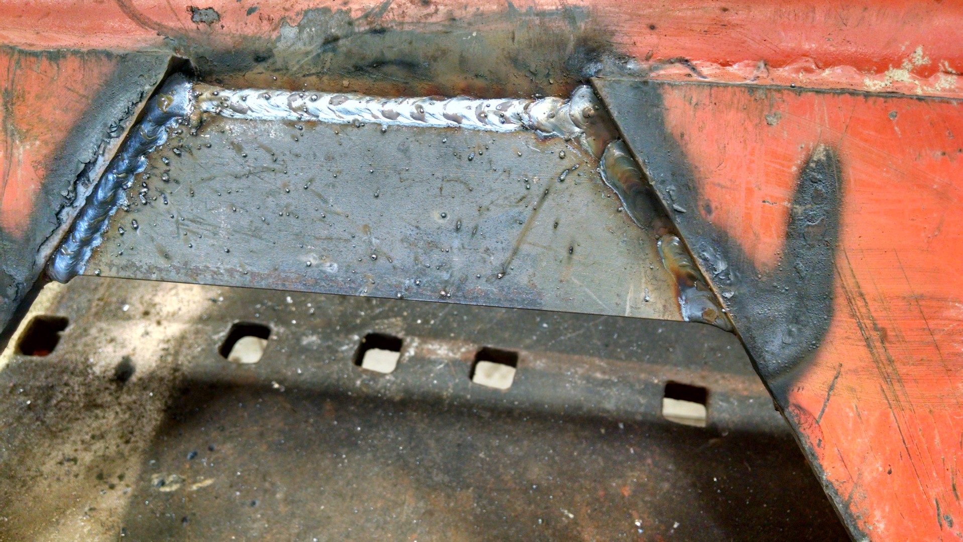

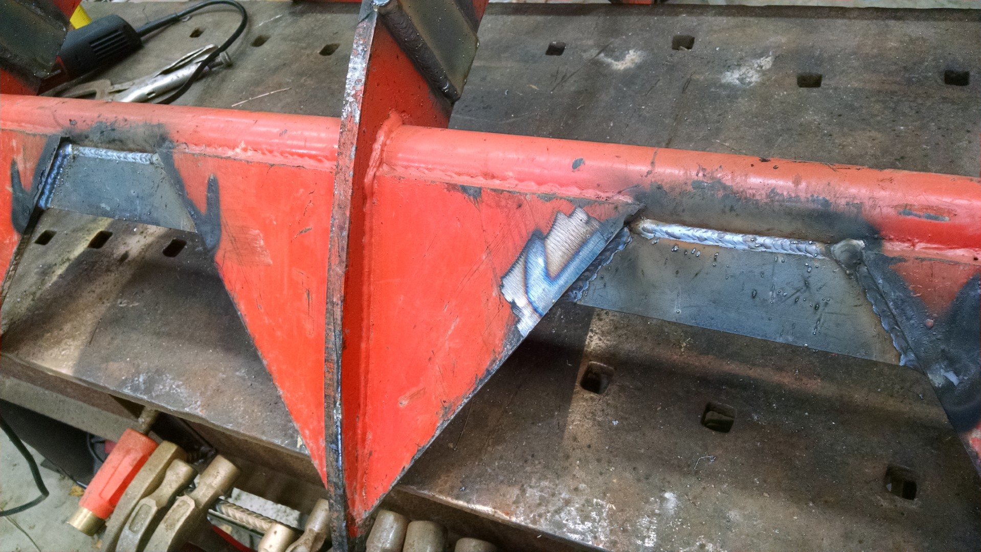

This is entirely avoidable. I've been bucking logs like this since I bought my grapple over 7 years ago and have never touched the grapple with the chainsaw (knock on wood).
Once you'd down to 5-6 feet of log, it's easy to manipulate the log so only a foot or so is grabbed by the grapple, giving you plenty of room for the last bucking cut.
Take the log vertical, rest the end down on the ground; gently loosen the grapple and raise it slowly; reset the grapple when you have ~1' of log to grab; move to horizontal for the last cuts. Easey peasey, plenty of room for the last cut, no mangled chains. ;)
Of course, it helps if you purposely modified your grapple to better grab logs in line with the tractor (vs. at right angle to the direction of travel), like I did.
This is 1/4"x2" flat bars welded to the grapple "uppers". Note the round bars that do not grab logs well at all. The flat stock grabs very well.

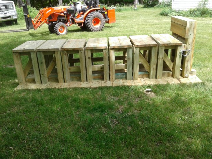

If you have any way to lift logs to waist height, you can build a bucking table. Mine has gaps at 16" intervals, so rounds are all the same size.
For all the wood he used he could have got a grapple and saved a ton of time and probably money.

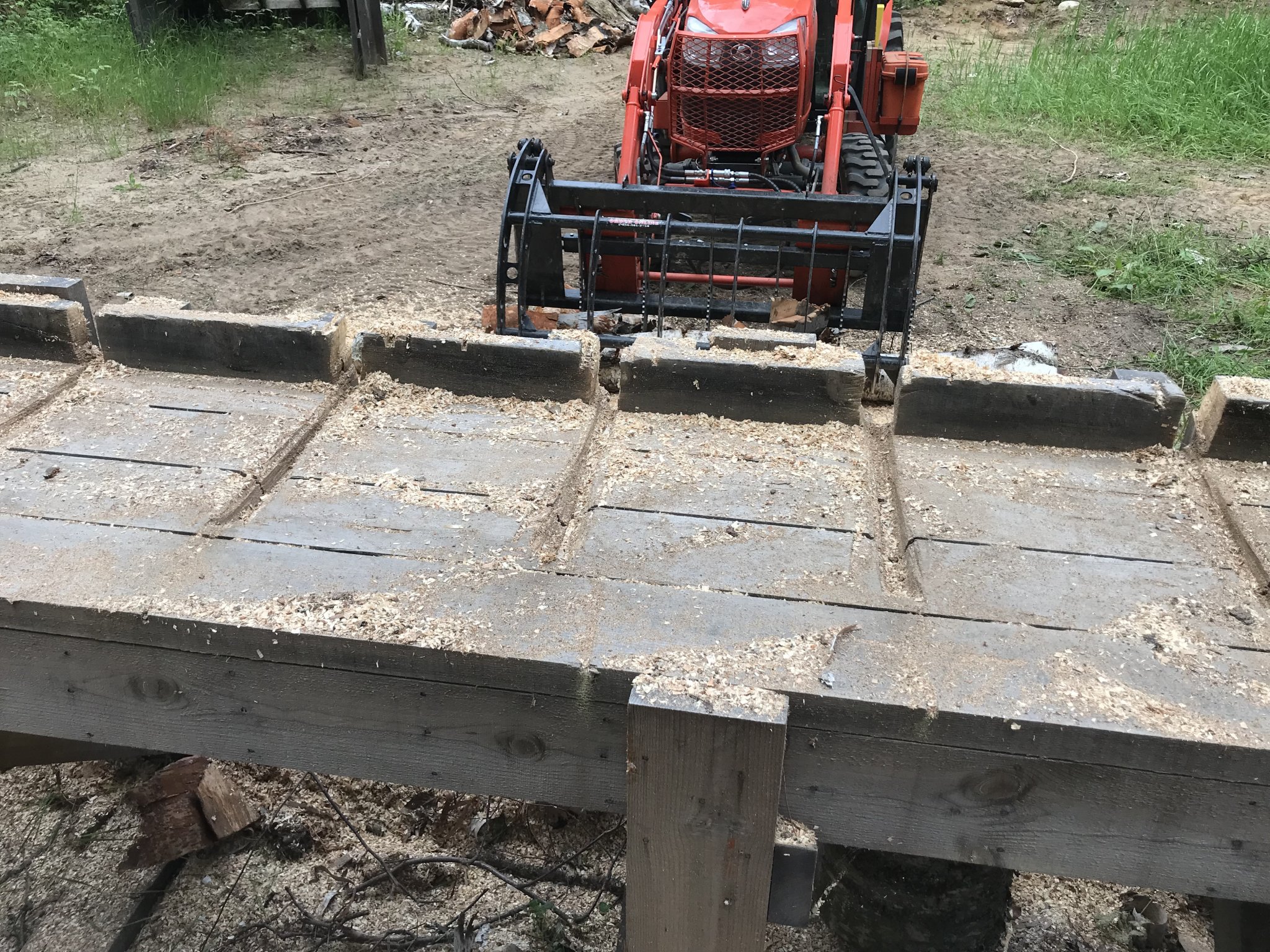

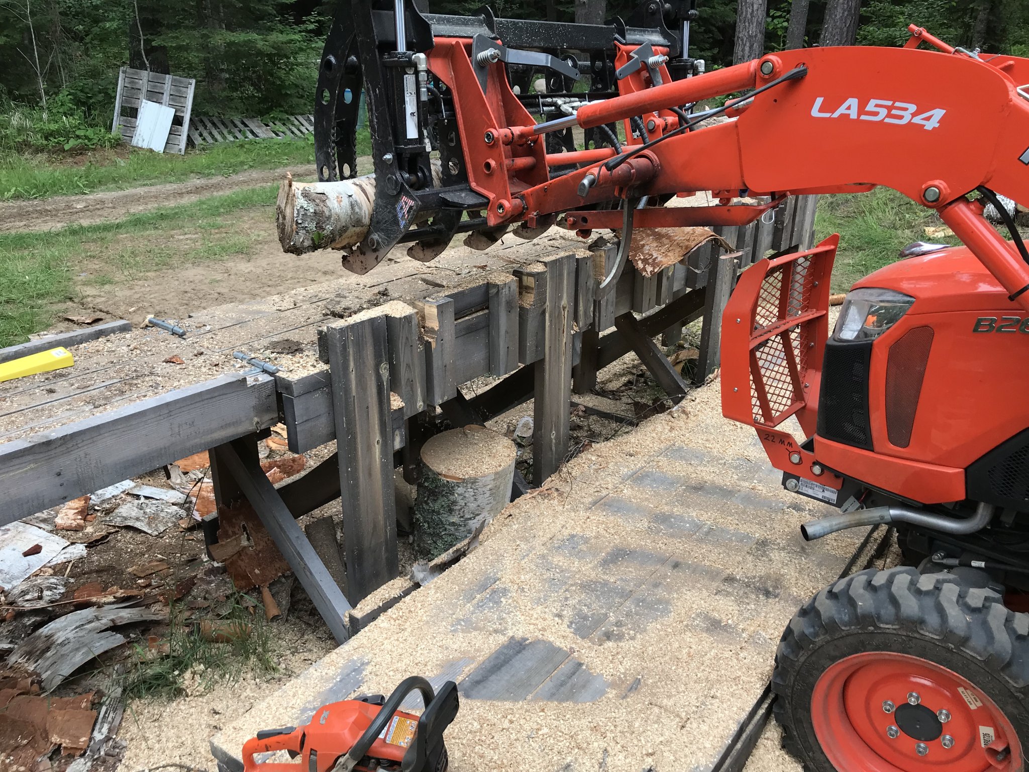

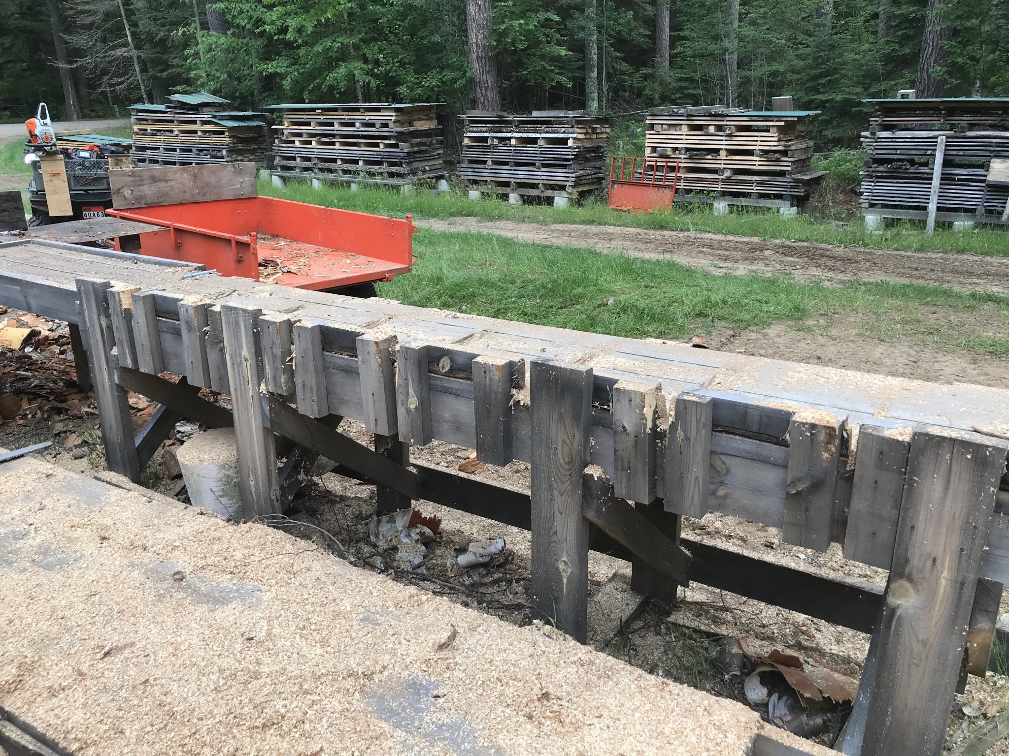

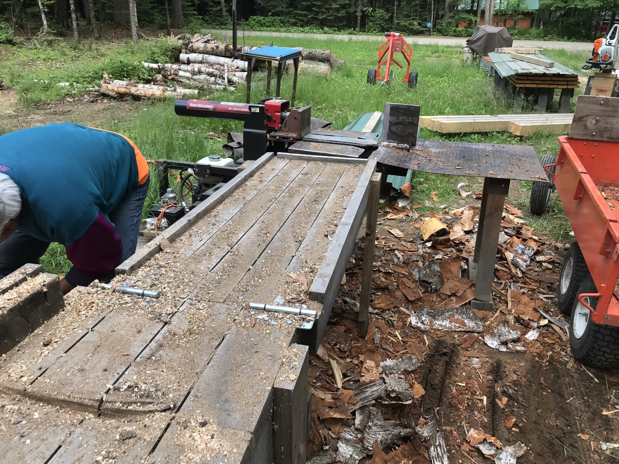

Here’s my log deck for cutting firewood. No more bending over during the entire process. I use the grapple to lift the log on the deck, cut every 16”, roll the round to the splitter and push the split wood into a hydraulic dump trailer, then haul to the woodshed. Cut the time involved, and no bad back at the end of the day.

That’s an awesome setup. 👍
How do you do handle larger logs with that setup and the B? (Do you have it milled for lumber, sell, winch em up, or simply don’t use?).
when it is time for me to move a large log and I’m at home using the B it doesn’t take long for me to miss the MX.
I have a cutting rack but I hope to build something like you have before long when we move to the other place we have up North. What’s the length of your deck? What make is your trailer? 🥃

I have my own sawmill, so any larger logs go to the mill for lumber, the tops get used for firewood. The firewood deck is 10 feet, and the trailer is a King Kutter hydraulic dump, with a 3000 pound capacity.
The largest log that I have lifted on my sawmill with my tractor was an 18 foot red pine that averaged 17 inches in diameter. Based on a log weight calculator it was over the lifting capacity of the tractor, but I lifted as much as I could with the loader, then curled the grapple back and drove up on some 2x8 boards to get it on my mill.
