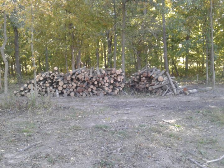

Let's start at the beginning. Have grapple, Got logs.

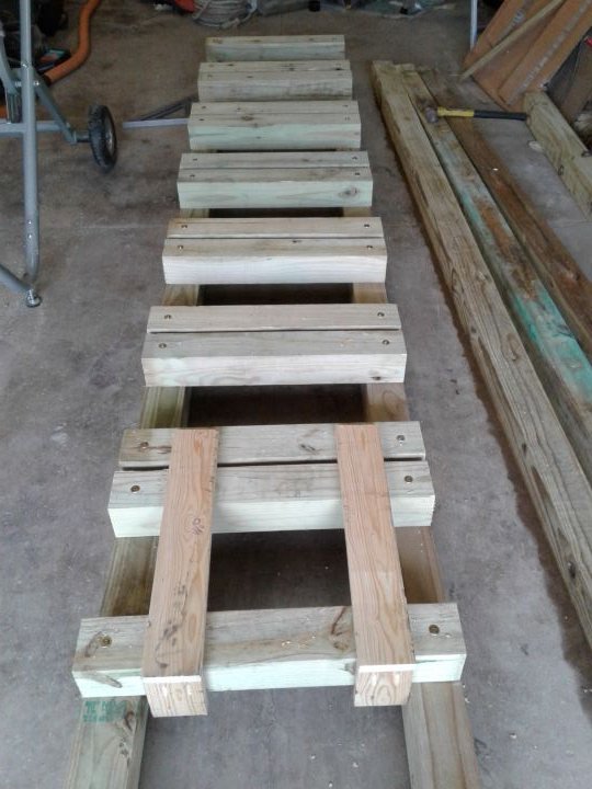

Side Assembly: Place 2 10' "rail" boards on the floor 24" apart. Positioning the first leg is critical use framing square to get the proper alignment and fasten with 6" spax screws. Verify spacing at the opposite end. The assembly jigs are used to position all of the 24" "legs"
Position jigs over 1st & 2nd leg. Slide 2nd leg against jig and screw it down, this gives us a spacing of 15 3/4". Slide the 3rd led against the jig and screw down. This will become the gap for the chainsaw bar.

Continue moving the jigs and position the additional legs.
Stand the side on end and build the other "side ladder" When finished stand the 2nd side up in the opposite direction. You probably noticed these side assembly's are heavy. We will now build these upside down so the stand only was to be flipped over 1 time.

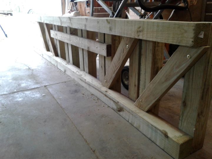

Extra Bracing: I plan to move the finished stand with pallet forks, thus I need a lifting rail on each side. I cut 2 - 2x4's at 57", the assembly jigs are 3 1/2" wide. Using the jigs for spacers and some clamps, I attached my lifting rails. (remember, building stand up-side down)
Sides are heavy and seem solid but, think some diagonal bracing should be used. These need to be sized to fit. After making the fist one, use it as a pattern to make 7 more

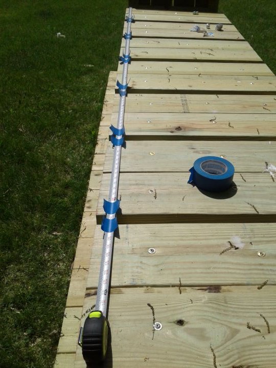

Stole this idea from a YouTube video. Mark a tape measure with the cut positions of the bucking table. This will reduce waste when cutting logs for processing on your table. Kabota orange looks nice on the silver tape.
