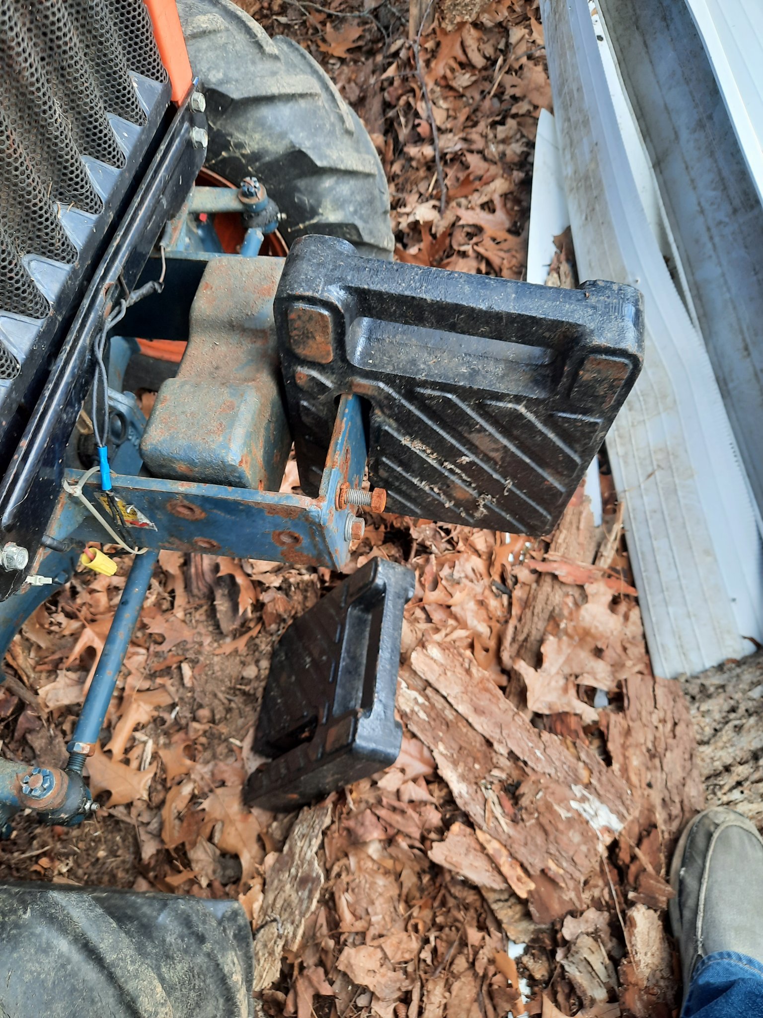

That weight is indented to allow for the shaft to pass the weight without removal. The weight actually floats in there. It also appears the front bolt holes align and I could bolt it in but I have 2 front horseshoe weights that drape over the front mounting plate that block the ability to bolt it in. See pics and thanks fro the confirmation on the front pto assembly!

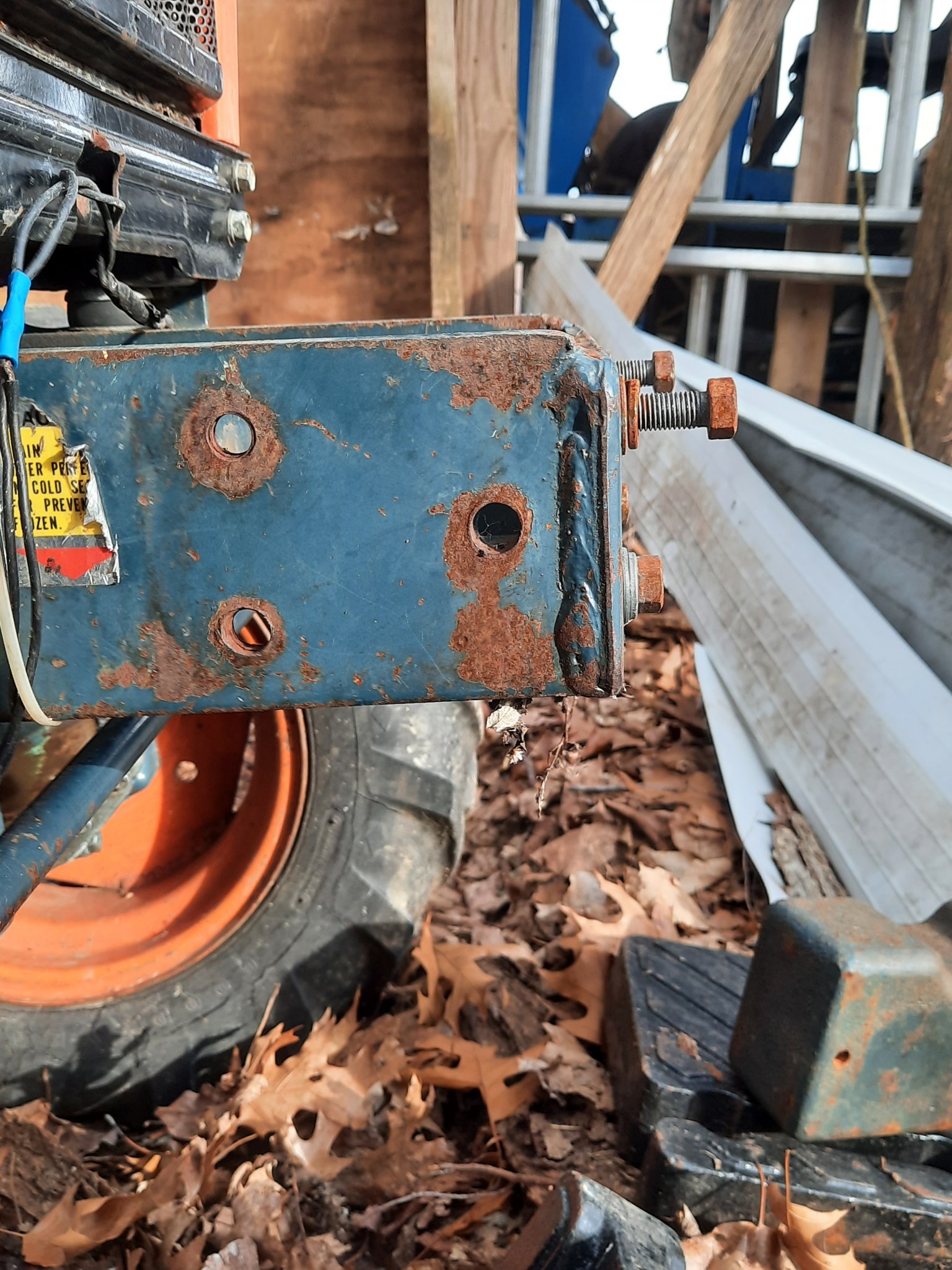

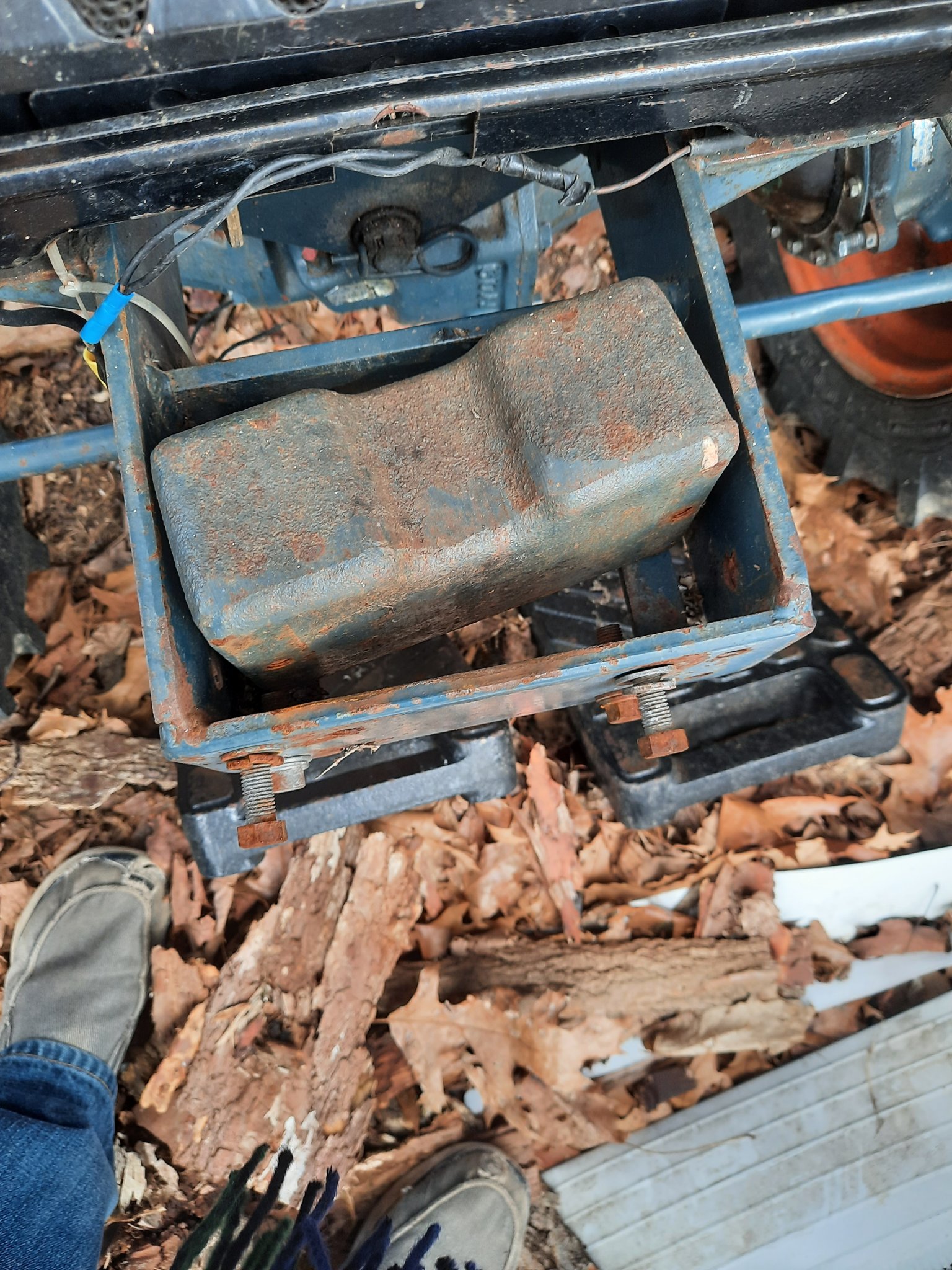

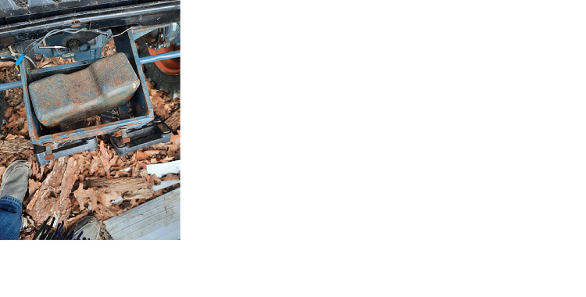

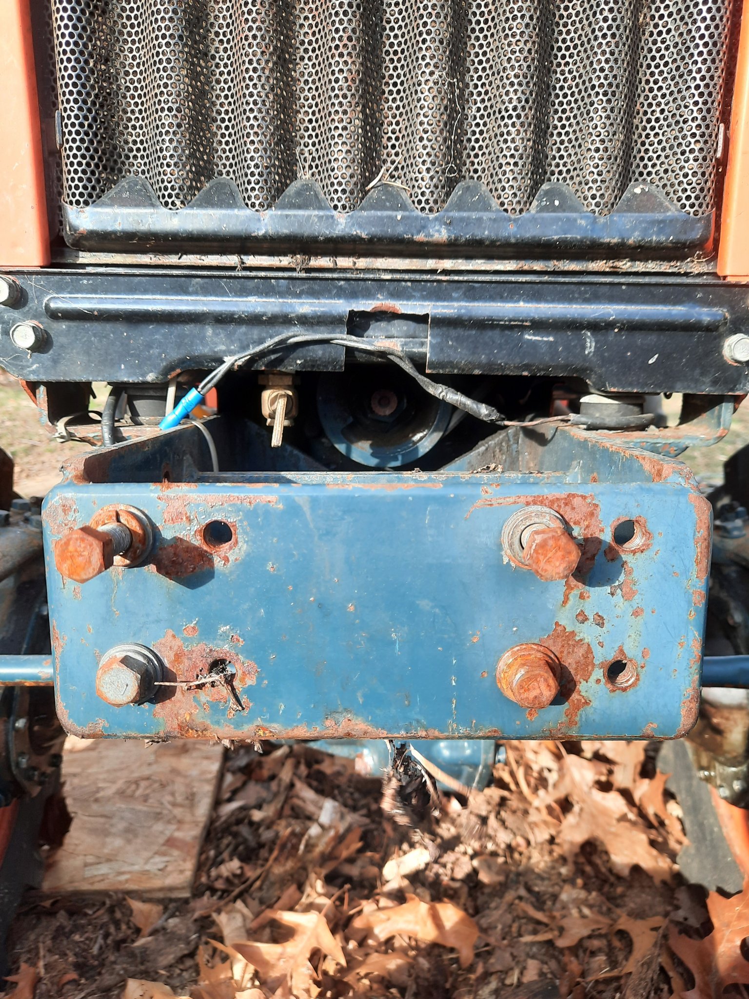

Arml,
The D in B7100D is for Diesel. I think the e on your B5100e indicates 2WD.
Anyway, the weight is removable and removed in the pics attached.
I have three bolt holes that mount the unit to each side of the tractor.
I believe the pto output shaft would bolt to the front plate (which mine has 8 holes)
See the following pics
Pic 1 - Showing a side pic with 3 bolt holes for the unit to mount to
Pic 2 - Showing PTO spline end (18MM x 22 tooth) (where the front pto shaft would slide onto - then bolt onto the front plate in pic 3)
Pic 3 - Showing the front mounting plate/bumper with 8 holes (in the middle of pic 3 you can make out a portion of the pto output spline from pic 2)
Hopefully that makes sense?

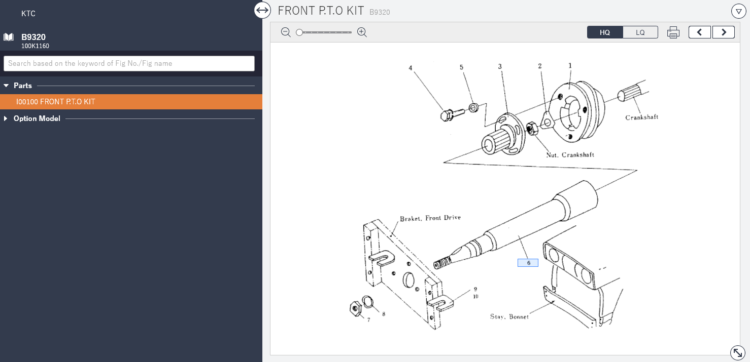

I have the same splined PTO hub on my B7200 - the parts book calls it a flange. Messicks shows the shaft (66494-88540) available for $150+. Probably going to be NLA if you call.
What are you trying to accomplish? I have toyed with the idea of making a front takeoff for a hydraulic pump using more common parts. Thats easy. The more difficult/ expensive part is the running gear - e.g. clutch - for the outboard end if you want to run something that requires it.
