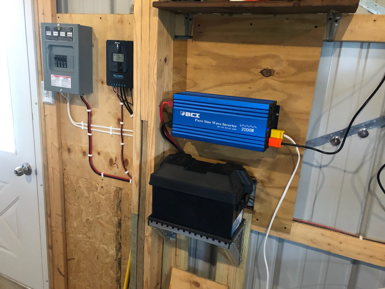

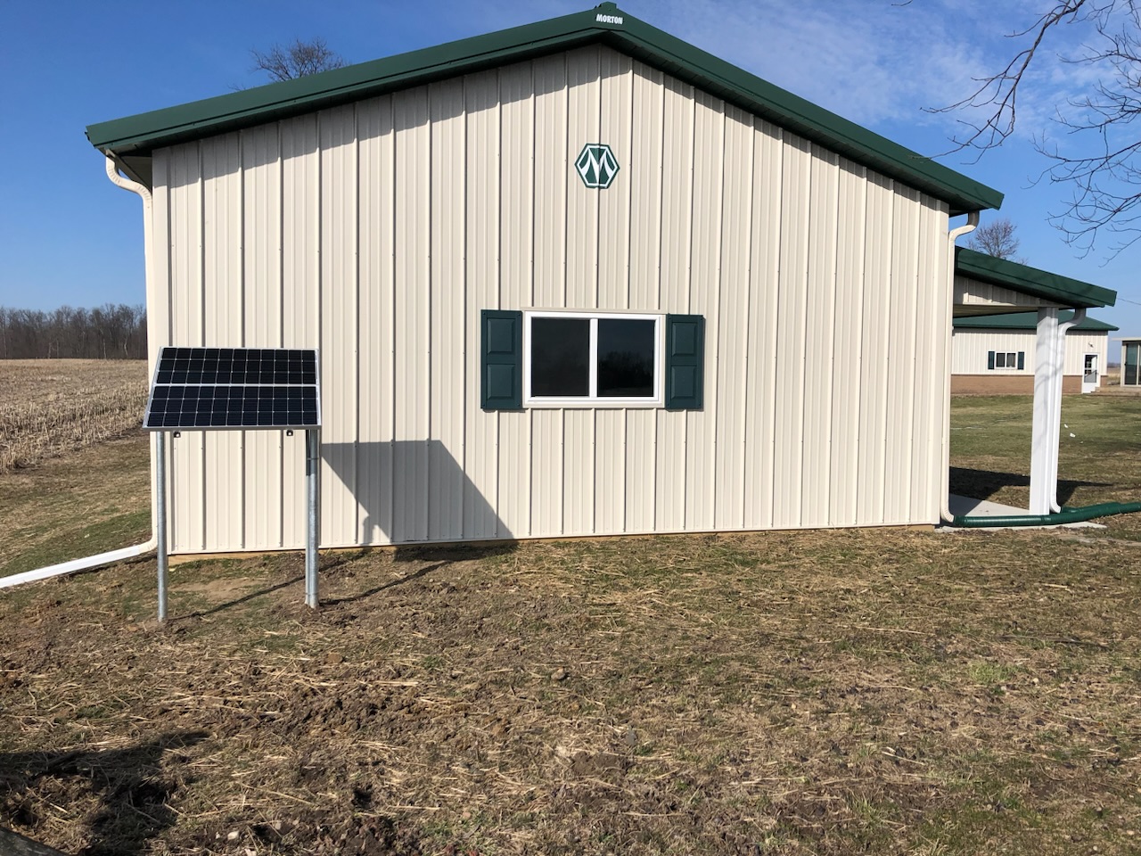

Thought I'd share my solar build in the hope it would help someone down the line.
I have a pole barn off the grid. Someday I may run a line up from the road but I can't justify the expense at this time. Instead, I installed this simple solar build.
This system will run basic power tools, vacuums, charge batteries, operate lights and fans, etc. I overbuilt the charge controller and inverter so I could double up the solar panels and batteries for additional power if needed ( panels and batteries are the big expense ). The greatest expense was the time I spent to figure it all out. I have no electrical background so I was starting from the ground floor.
The total cost was $1010. I'll get a 30% Tax Credit so it's a net $700 system with the ability to scale it up.
I did buy this book which was very helpful. I purchased everything from Ebay and Home Depot.
Happy to share what I learned if anyone is interested. The two taped off wires are for a 12V fuse box I had yet to be installed. I did pretty up the panel pole with white paint. I can add two more panels below these two on the same pole.

View attachment 109675 View attachment 109676

LB, you should redirect the gutter runoff AWAY from your solar 4by4 post.....
also put batteries on a plastic tray of some kind and for sure plastic or wood cover over the battery terminals. soone ror later Mr. Murphy will drop by and some 'metallic object ' WILL fall and short out the batteries...

Thanks. Good tips. I will do each of the above.
