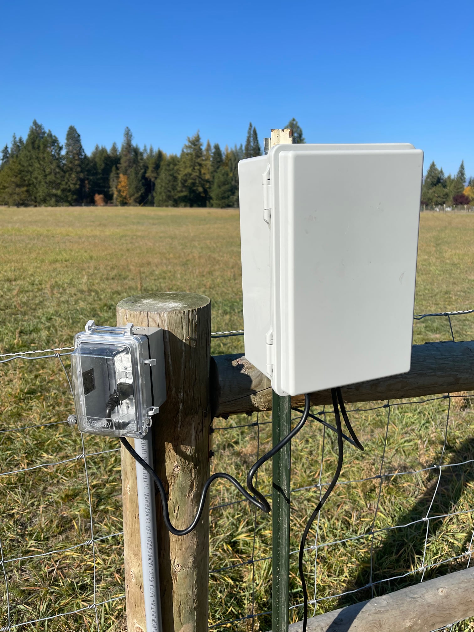

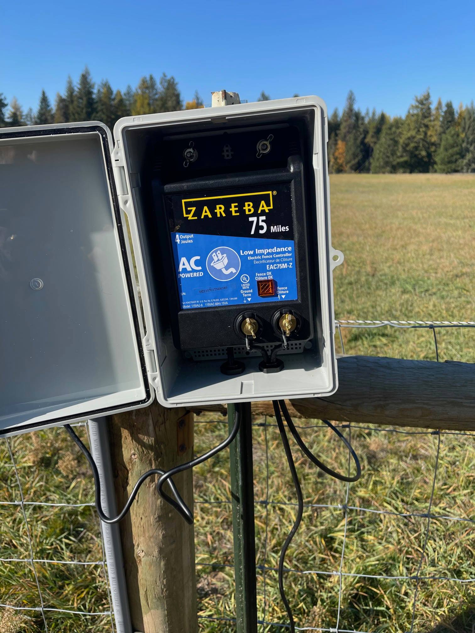

Excellent advice in here. The Parmak 12 is 3.1 joules, which is plenty according to AK F&G. Use 4-5 strands of high tensile steel wire with the top strand at 40 inches. Three ground rods for sure. I have a Solar 12 collecting dust as our short winter days runs the battery out along with the capacity reduced due to low temperature. I got mad at the situation and ran buried 120v out to the fence and put a Zareba 75 (4 joule) in and never looked back. BTW most plug in devices are not weatherproof, so I got creative and got an enclosure, T-post plate/mount and went from there. We have visiting horses, hence the braided top wire (ground) with the hot wire about 8 inches below. Any leaning has immediate response. If your soil conditions are poor for ground, you can add a ground rod or two around the perimeter and connect to a ground strand. You can even add a strobe out on the far side. Added benefit is deer do not like electricity. They sense the pulses and shy away. Fence .jpeg Fence 1.jpeg
